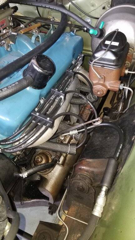

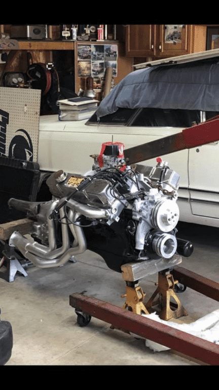

I installed long tube (TTI) and without the benefit of a lift, it was a much larger project than I anticipated requiring right side torsion bar removal and engine mounts to be un bolted for drivers side access and starter removal and reinstallatuon as well as new spark plug wires and after market looms. The finished product looks awesome but knowing now what a project it was/is, I would NOT recommend headers unless you're running after market heads (which I am) and they were necessary for the larger exhaust ports. Stock heads did not provide a large enough mating surface for the ports and I was constantly blowing through exhaust gaskets because of the mismatched sizing.
I put a pair of Schumacher Creative Services short headers on my 76 New Yorker. Very nice pieces but a little pricey. They fit well with the only mod so far is a new dip stick / tube. Although it looks like Andrew did nicely without even that. The headers themselves are not noisy, but a put too aggressive sounding mufflers on it. I ready need to take the muffler noise down a peg.

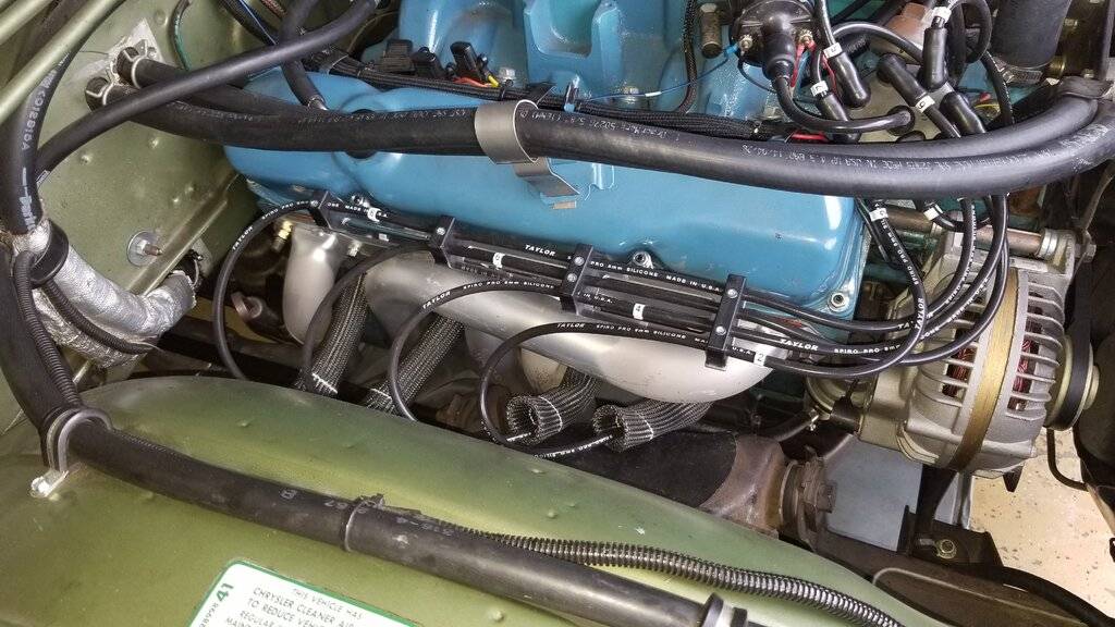

Very nice job, looks great. Love the wire looms. Is that your making or a kit?
I bought the kit but engineered the studs elevating the looms away from the valve covers. Stock, they would clamp directly to the valve cover and it put the wires too close to the exhauat.
Installed TTI headers on my 470 Stroker, into my 68 Imperial Crown Coupe without any issues. Took the core support out, and installed in through the front. Cleared fine.
Only recommendation I would give, install your motor mounts on your engine, before you put motor back in.

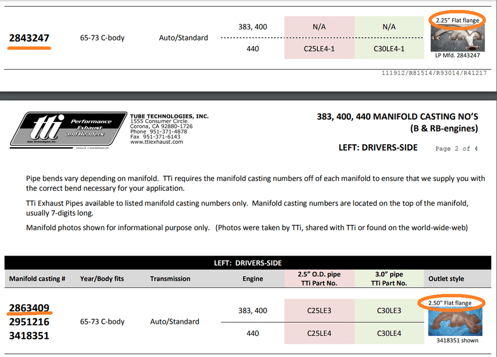

my apologies for intruding ... a recent thread tends to have most attention so I need a little help? I put the orange markings on the photo to focus my questions.
source: https://www.ttiexhaust.com/Classics-Ex/MfdCastingNo-383.pdf
1. Basically, why would '65-'73 C's have so many castings? I understand that emissions-thermal stuff was going on, they went from slabbies to fusies, etc. I guess I need one more reference .. which casting# matches what year?
2. Would the "flange measurements" simply be the result of the changes in one above. I see TTI lists importance of knowing the casting because they supply "header-back" systems that need to fit.
What matters is what manifolds are on the engine in the car getting headers. I have no clue why they made as many different manifolds as they did, but all you need is the casting number for the manifolds you will look be using.

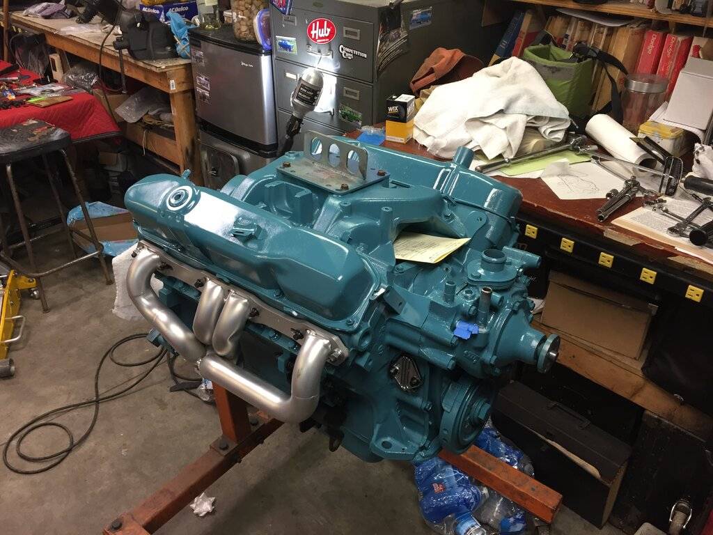

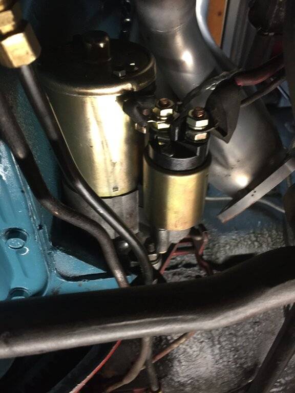

I have the Hedman shortys on 1 car and they fit really well.

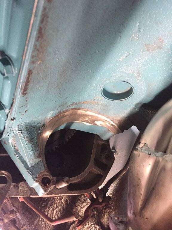

They do NOT require that RobbMC starter - a regular 5.2/5.9 Magnum starter works fine (after you remove the 2nd set of wiring terminals). No block-grinding for the starter.
Reportedly there is a boss on teh B-block that needs some grinding for clearance, but I put on a 440 and had no issues.
I did need to modify the dipstick, which was an annoyance.
I used a set of copper gaskets, a particular brand that had small same-as-port holes in them (most brands are oversized).
They've been on the car at least 10 years with no leaks or other issues.
My only complaint that I remember is that they supply 2-1/4" collector stubs, which is silly considering these are bigblock headers.

I have installed the TTI Shorties in a couple of cars, shorties require a special starter from Robb MC (more cost), also will have to grind the block for starter to sit square. If you are not constantly 1/4 mileing your car Manifolds are good enough.
