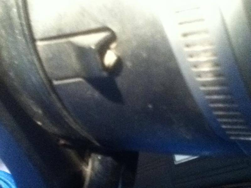

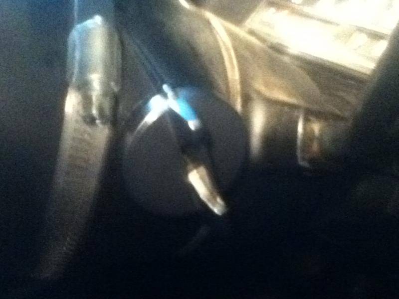

So last night I go back out to have another look up under the steering wheel for my courtesy light. I cannot find any light source there whatsoever...nothing below ior behind the ignition key cylinder....no light source on the steering column at all..anywhere (see pics...that protrusion is a release).....this brings me back to the time delay switch....this will bug me to no end. Why is this here. Could this be for interior lights? If so, it is indeed defective.

Found the turn signal flasher also (thanks Big_John). It was pushed up there and dusty as all hell. The lady who owned the car never touched anything....nothing looked disturbed, like it was a time capsule from 1970 or something. Hated to pull that down.
Sorry for the pics rather than a nice scan.
First pic shows the steering column with the flasher switch.
Next pic shows the same view, turn signal switch removed.

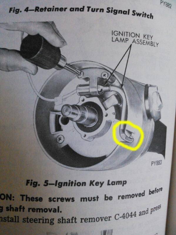

Here you see the ignition lamp. Note the lamp peeks through the same hole as the flasher switch.
No, there isn't a "black nub" below the ignition switch.
Take the hose clamp off your column and look at the flasher switch. You'll see the opening for the light.
Either your bulb is out or the clamp is obscuring the light.

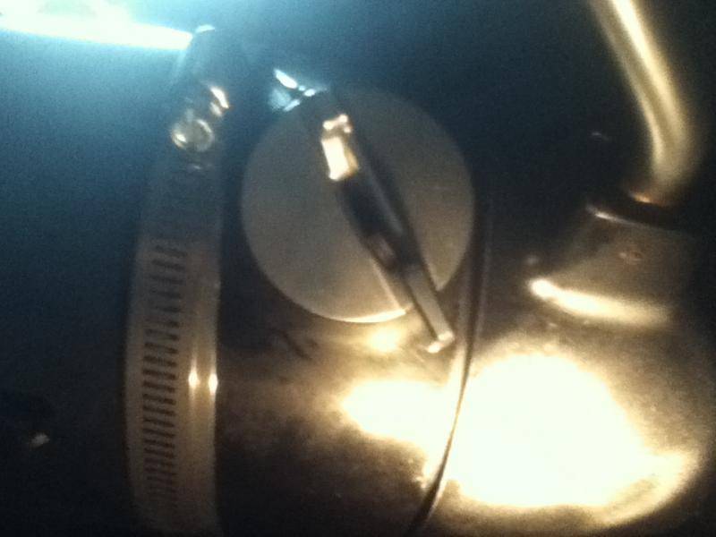

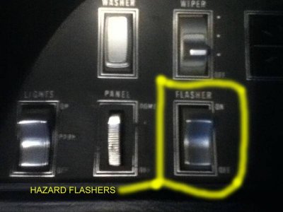

The pics show the switch for hazard flashers on the steering column. The hazard flasher switch in my car is on the instrument panel, so even though there is no knob on the steering column, I guess that is where the courtesy light is supposed to emit from. The clamp isn't covering anything so the bulb must be burned out.
Yea, I realized the flasher was on the dash (like mine) after I posted and didn't get back to correct it. I looked at my car too before I wrote that too. LOL!!
Either way... That's it!

Excellent. I now have a key courtesy light (and on timed delay to boot). I LIKE it.
