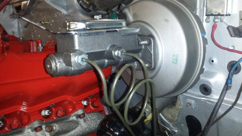

Considering I haven't had to form or make up brake lines for over 25 years I think these lines turned out pretty good.
(Yah' I'm posting a self brag but I don't care!) :D
This is part of the conversion from a single Master Cylinder to a dual M/C with Power Brakes from non P/B's

I used a piece of 2" PCV piping to make the loops
Ahh Gosh it tern't nothin' but about 2 ana half ours' of bending around..
A bit of cursin' and startin over agin a few times.:wtg:
Are your two loops going to hit against each other, or is there some space between them?
the loops do have a decent space between them, it's just the way the picture was taken that makes it look like they are touching.

All I wanted to know was which bender he used. I've used many and I have never been 100% satisfied with my work.
WTF.....
You sir are looking at a 2" piece of PCV piping used for plumbing with a notch filed into the one end to hold the end of the tubing.
I did use a readily available tubing bender to get the 1st 90' bend going from the M/C then used the piping to create a perfect circle for the anti-vibration loop.
Since I used the 2" pipe, I didn't need to go more than 1 loop.
Some people insist that there has to be at least 2 loops to serve correctly but IMHO thatis if you want to create a tighter loop of something like a 1 1/2" loops.
It a very effective tool in the right hands.
You can practice with some scrap tubing if you have some.
You can use smaller diameter piping for tighter bends as well but you have to get the bend correct as possible as you want to avoid twsting the tubing to much when making angle corrections.
It will make most of all your work look like it was factory bent!
I find the retail tubing benders a bit clumsy to use for most of the bending I want to do as well so thus the reason for the piping..
