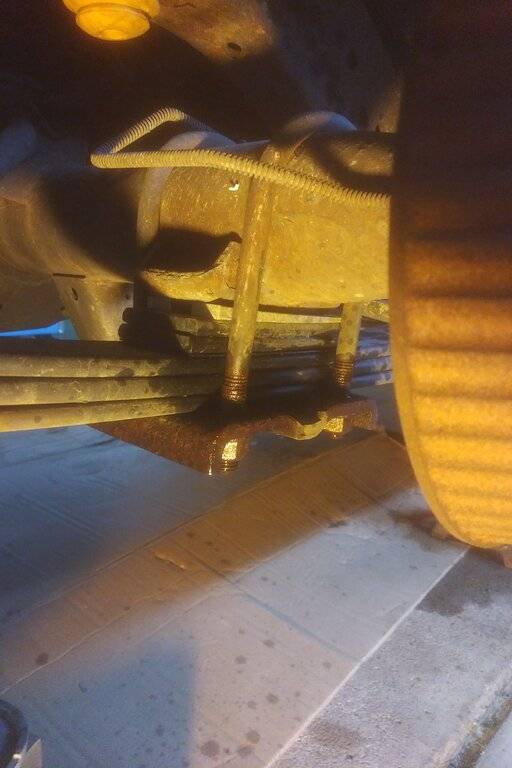

Question for my truck'n friends... finally had some time to get underneath this Dak R/T. Sure enough, these are new (chinese-looking aftermarket) springs. They ride like garbage and the thing sits stupid low. It looks like 3 leaves are being taken up with spacers above the spring pack. If I reversed this (spacers below) I could expect the same lousy ride, but gain height? Or... should I take the pack to a spring shop and have 3 new leaves added? And recommendations for a local shop. I got a quote from John R that included labor... and that ain't happenen'. Remember the point of this truck is just winter-hooptie, drywall-hauler, so not looking to fall in love.

I think what you are asking is if you pull the the spacers from the top of the leaves and put them below will it raise the truck. Yes it will. However I would throw them away and get new regular length U-bolts. By putting it back where they belong, you likely will not need the pinion angle wedge either. It actually may ride better at stock height. Could be low enough it is bottoming out.

I disagree with using those spacers below. Look unstable/unsafe.

The cheapest safe way out would be to be to pull the leaf springs, look up a local spring shop on the internet, and have 3 leaves added. If you don't care about ride height, you could save money by not re-arching.
It's spring under so removing those shims will increase ride height. Shims and/or blocks should never be stacked. Too easy to spit one out, then the rest follow quickly. Not fun times!
Rather than freezing junkyard, hit up the local 4x4 shop and buy an add-a-leaf, a pair of new center pins and some new U-bolts. Still cheap, and should get it back closer to stock height...but without the pain of a junkyard at this time of year. Pulling used leaf packs out is a bad enough job in warm weather.

Just as an update, after looking at the general crappiness of the spring set up, I found a guy selling used stock 4x4 springs on FB about 70 miles away. I figure 20 years should have them down to stock 2WD height. Or if not, that's fine as well. $50 for the set. Best part? No junkyards on my back at 30 degrees.
