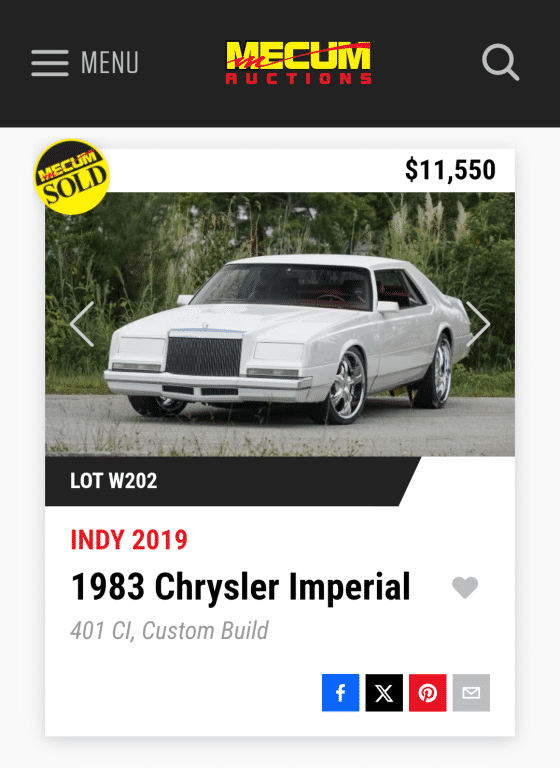

Beautiful car but the resale values are pretty scary, so I wouldn't put much money into it.
This $50K invested white imperial has a 401 stroker with 16,000 original miles. Owner said he won't take less than $15,900??? This posting was in 2020. It looks like he was trying to sell it for 3 yrs prior to that.
Screenshot 2024-02-11 at 00-26-14 1983 Chrysler Imperial at Indy 2019 as W202 - Mecum Auctions.png
If the original wheels were on it without that rake he may have gotten his asking.
