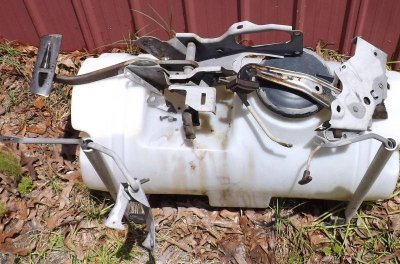

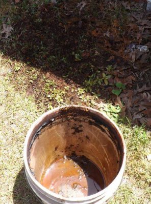

Alrighty, here are some pics of the parts after hosing them off with water then using a spray bottle of Methylated Spirits to disperse the water immediately afterward. The Metho being alcoholic dries off fast. The bare metal is etched which im happy with for paint adhesion. This is what it looks like after five weeks of soaking in 5% vinegar.
