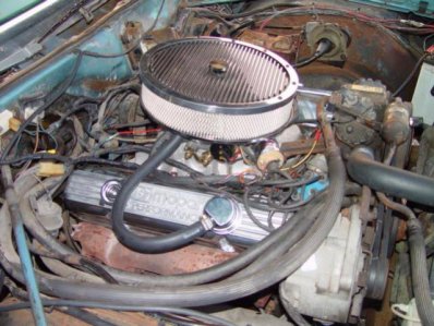

I have a PCV valve on one side and breather going to the air cleaner on the other side just to keep oil residue off the engine and just recycling it through the carb so it doesn't make a mess.
