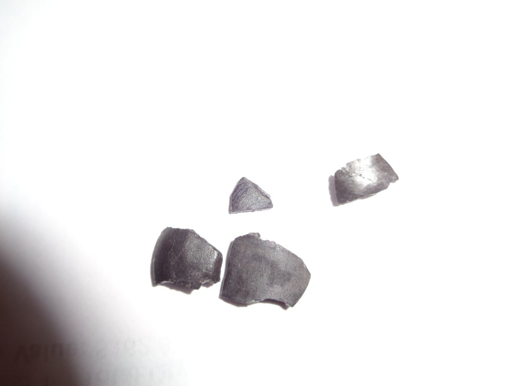

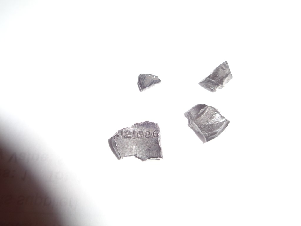

valve cover gasket replacement: found some chunks in the galley
Ideally, you would remove the cyl heads and take them to a machine shop for replacement. BUT, putting a fitting into the spark plug holes, you can then compress the valve springs, remove the valve retainer locks, and then carefully remove the retainers from the valve stems. Then you have direct access to the seals. Remove and replace the seals and re-assemble in reverse order. Possibly a good mechanic shop can do this, although it's probably been a good while since they might have done this.
My late machine shop operative noted that Chevrolet had some orange silicone seals from the earlier 1980s or so for 454 V-8s. Same stem size and such, just need to trim their length to work on the Chrysler B/RB motors. An upgrade from the normal material Chrysler used back then.
Operating the engine with those hard seals should not cause any problems. I suspect that any oil consumption issues will change, BUT those smaller seal parts can migrate into the oil pan and the oil pump intake screen. Worse case, have to remove the oil pan for cleaning, which might not be that bad of an idea, although a bit difficult and costly to do, anyway.
On the other hand, might be an opportunity to take the heads off and get them refreshed, as it can be possible that some valve guides have/or are getting close to needing attention anyway. Might be a good time to replace the timing chain, too! TWO investments in longer and more trouble-free enjoyment of the vehicle. Just resist the urge to pull the engine and re-do it, unless that is in the longer-term plan and you can disable the car for that long. Considering this is getting to be "driving season", probably best to do the least right now! But you can start saving and planning for "the rest of the rebuild", later.

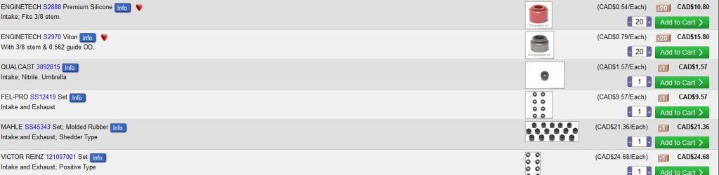

I'm thinking the red silicone..but my valves are probably filthy. would the back umbrellas ride up and down with the valve?

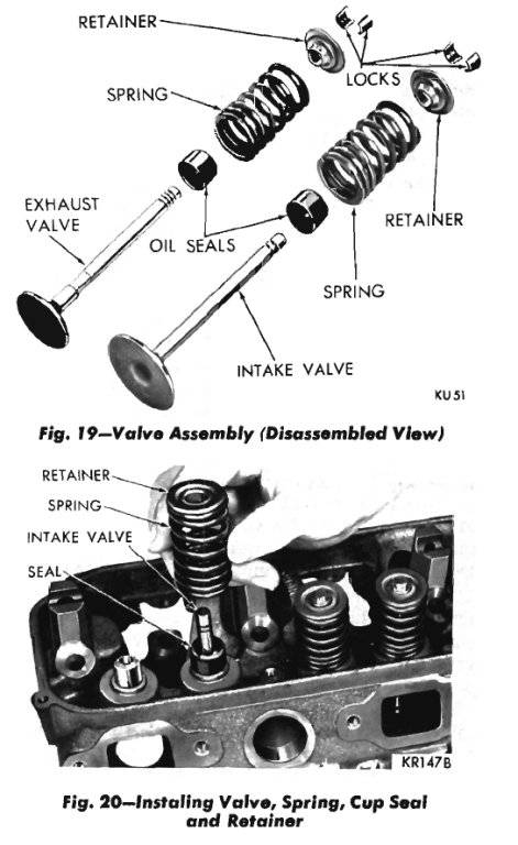

Sorry for not getting back to this sooner (racing season has fully started). Again the FSM is your friend, by the FSM illustration both valves get seals with initial installation with the seal pushed down fully on the guide boss. Don't worry about it going up and down with the valve, that's the way it was designed and a little oil (mist) getting into the guide may aid in stem lubrication. On a Mopar there really isn't a lot of oil flying around the rocker shafts except for running at high RPM's so the simple umbrellas seals suffice. Not like a Chevy with pushrod oil feed rockers, they seem to spray more oil around.
Ok thanks. For some reason I think back to someone saying back in the day they only put seals on the intake or something but I did see they both take seal and this confirms it. Now I just got to decide if I get the black felpros or the pink enginetechs....either way I gotta do it sooner than later
