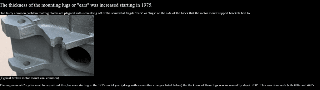

Here are the specs I had in the bid for the motor - I modified it to have it for the RV block which I understand has larger motor mounts and some additional block and main bearing support
