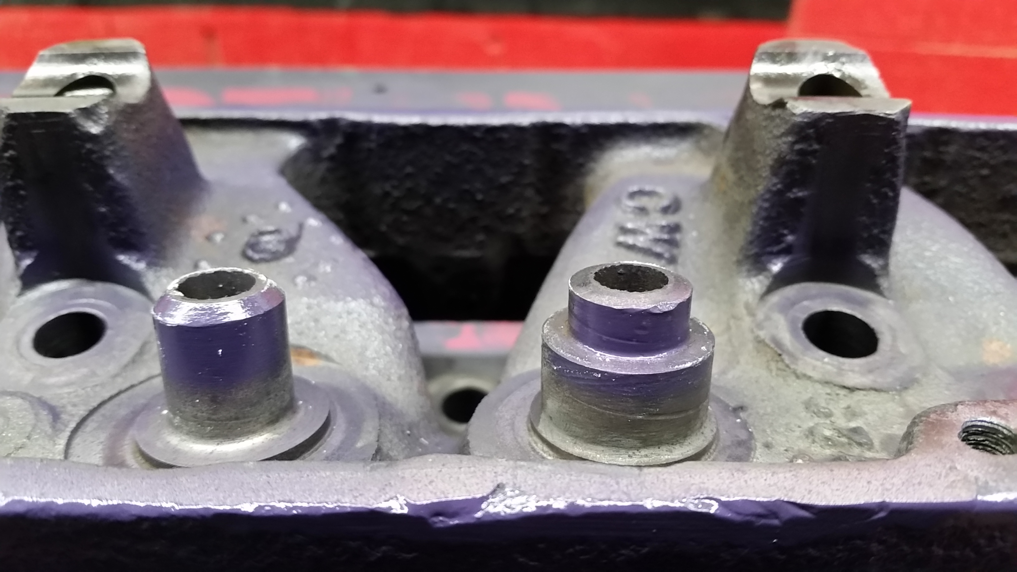

Jan 25, 2017 #1 Dodge97318j Member Joined Aug 11, 2016 Messages 75 Reaction score 42 Location Binghamton, NY I have a set of 902 castings that I am looking for a set of valve seals for. The intake guide boss is twice the size as the exhaust. Anyone run into this? Attachments 20170125_171930.jpg 1.1 MB · Views: 148
Jan 25, 2017 #2 Dodge97318j Member Joined Aug 11, 2016 Messages 75 Reaction score 42 Location Binghamton, NY I don't think the sealed power p/n mv1707 will fit
Jan 25, 2017 #3 70bigblockdodge Old Man with a Hat Joined Jan 19, 2013 Messages 13,562 Reaction score 11,204 Location Avonmore Pa. Dodge97318j said: I don't think the sealed power p/n mv1707 will fit Click to expand... You need a valve seal set for later set like 452 castings. Try a set for 76-78 Big block.
