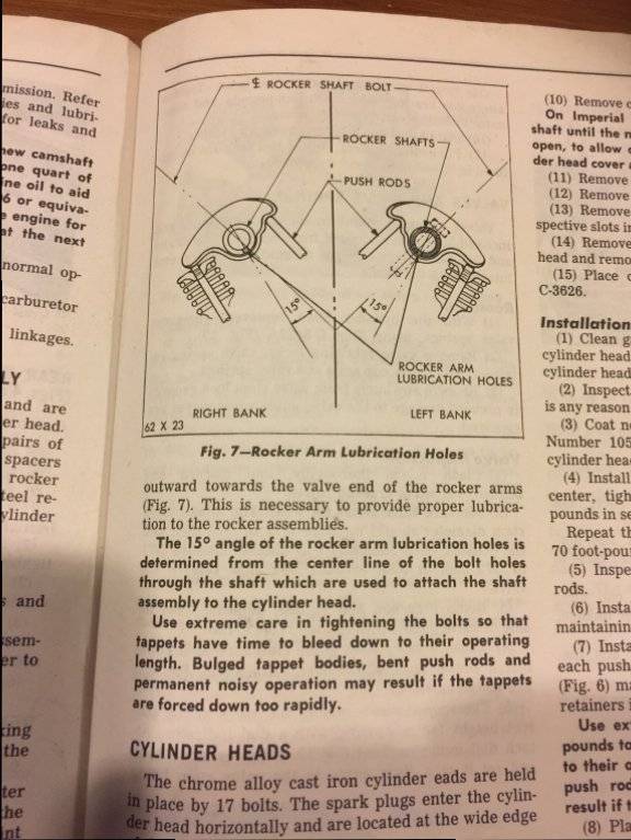

Ok guys looking for some help. I Had to remove and reinstall the passenger side head. Long story of cursing and yelling about a snapped exhaust manifold stud.
i cranked her up to bleed and burp the coolant and I'm getting some valve train noise. I used my trusty mechanic stethoscope and it's only from the valve train on the side I removed. I'm thinking I messed up the 15° angle note in the service manual.
Is there a trick to setting the 15°? I shut it down as soon as I started hearing the noise. I'll pull the valve cover tomorrow to have a looksy but any help is appreciated.

You did the right thing in shutting the engine down when you heard a noise. It could be just a lifter lost its prime and bled down when you put it back together. It is also possible to reinstall the rocker shaft upside down and this will keep you from getting oil to the rocker arms.
Here is how to check to make sure you are alright,
1.Remove valve cover.
2. Inspect your rocker arms for the correct location, there is a diagram of this in the service manual.
3. Make sure the spacers under the shaft bolts are in the proper location, the two wider ones go in the # 2 and # 4 positions. #s 1, 3, and 5 are the narrow ones.
4. Make sure the oiling holes in the rocker shaft are facing downward towards the rocker arms. this is the 15 degree angle the book is talking about. If the shaft is upside down you are not lubricating the rocker arms.
If after inspecting and all is correct put it all back together and run the engine at about 1000 RPM and the lifter should free up with the oil pressure and quiet down.
Any other questions just let us know.

Thanks for all the replies. I should get a chance to look at things tonight. It'd be hard to mess up, I didn't take them apart or really move them much but it's worth checking.
Well I pulled the valve cover and nothing looked too out of place. I loosened everything up and then ensured the oil holes were pointed towards the valve springs. I guess we'll see what happens tomorrow when I crank her up.
