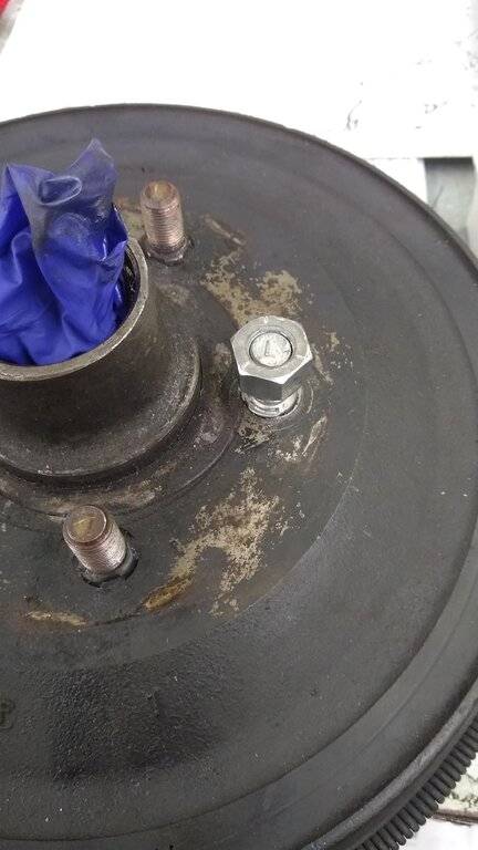

I was distracted, forgot to reverse the setting on my air wrench and annihilated one of my left-hand threaded lug studs on the front drum.
Don't people know that when you have the car out, the hood open... tools everywhere... the music cranking... and you're covered in grease.... YOU DON'T WANT TO TALK TO ANYONE!!!

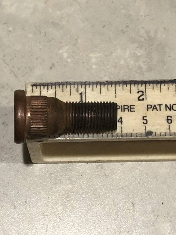

So... I'm one stud short. What can I do about this? I'd like to keep the LH threads, can't seem to find the specs on the size and the depth of the knurled area either... if these things are even available. Or where I can get one... if they are the right one. I've been reading for a while... but mostly a lot of old threads about the same issues.
How the heck do I get the thing out without wreaking more havoc on the drum... was considering using my neighbor's head for a hammer as there is obviously nothing in his.

This what I have.

Thanks to the old school guys at Mars Auto in Bayshore, Long Island. Took the drum in to them, he looked at it and laughed. "Forgot to switch the direction, eh?" Lol.
Properly drilled it, removed it, fitted it with the correct size and thread direction stud and even swaged it as well.
