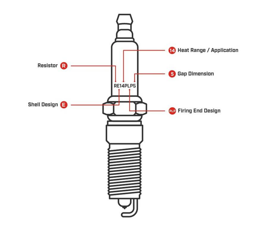

Champion Spark Plugs Decoded
The combination of letters and numbers assigned for every Champion spark plug is a logical formula which indicates the major features of its design.
Let’s take a closer look:
[R] Resistor - If an R is present, this indicates a resistor type spark plug. Resistor type spark plugs reduce the amount of radio frequency interference (RFI) that can cause ignition misfires and static on the radio.
[V] Shell Design - This refers to the thread size and reach of the spark plug.
[15] Heat Range - The middle number indicates the heat range of the spark plug, the higher the number the hotter the heat range.
[YC] Firing End Design - The letters after the heat rating indicates a special spark plug construction feature called the firing end design. The letters refer to the center electrode material, projection dimension and ground material.
[4] Gap Designation - The number after the heat rating indicates the wide gap designation. Please note, the wide gaps are required to meet federal and California requirements.
FWIW, Champion is not the same company they used to be... they were bought out years ago. This has been puzzling to me; era correct catalogs specify J11Y plugs for my 1974, but current catalogs call for RJ14YC... The 11 heat range is gone from the catalog, but the 12 heat range is still available. :realcrazy:
