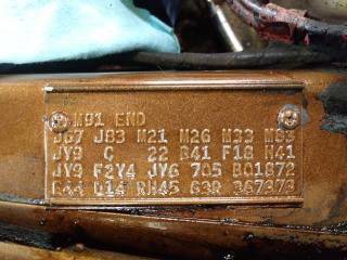

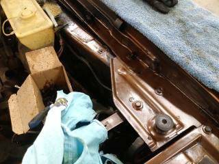

Hello fender tag!
It was not legible with the thick coating .
Now it looks like new!
And for the tag readers...
Code Description
E44 318-2 Barrel
D14 3-Speed Manual Column Shift
RH45
R = Plymouth Belvedere/Satellite
H = High
45 = 6 Passenger Wagon
G3R
G = 318 150HP(net) or 170HP(net) 1-2BBL 8 CYL
3 = 1973
R = Windsor, ONT, CAN
367878 Sequence Number '367878'
JY9 Paint Code: Dark Gold Poly
F2Y4
Trim Grade/Style/Color
F = F Class
2 = Vinyl Bench
Y4 = Gold
JY6 Upper Door Frame: Dark Gold Poly
705 Date Built: 7 / 05 / 1973
B01872 Order Number: B01872
JY9 Roof Type OR Color: Dark Gold Poly
C Built For Canada Specs
22 Radiator Diameter 22" WIDTH
B41 Front Disc Brakes Some Yrs. Power
F18 65 Amp Heavy Duty Alternator
H41 Heated w/ Upper Vent
J67 Heavy Duty Wiring Harness
J83 Roof Air Deflector
M21 Roof Drip Rail Moldings
M26 Wheel Lip Molding
M33 Body Side Moldings
M83 Rear Bumper Guards
M91 Luggage Rack Deck Lid
END End of Codes
