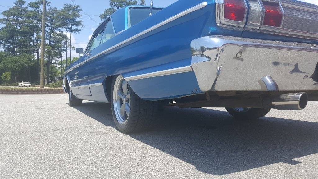

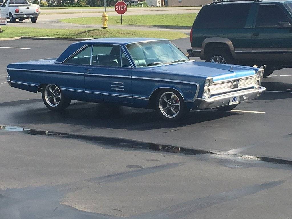

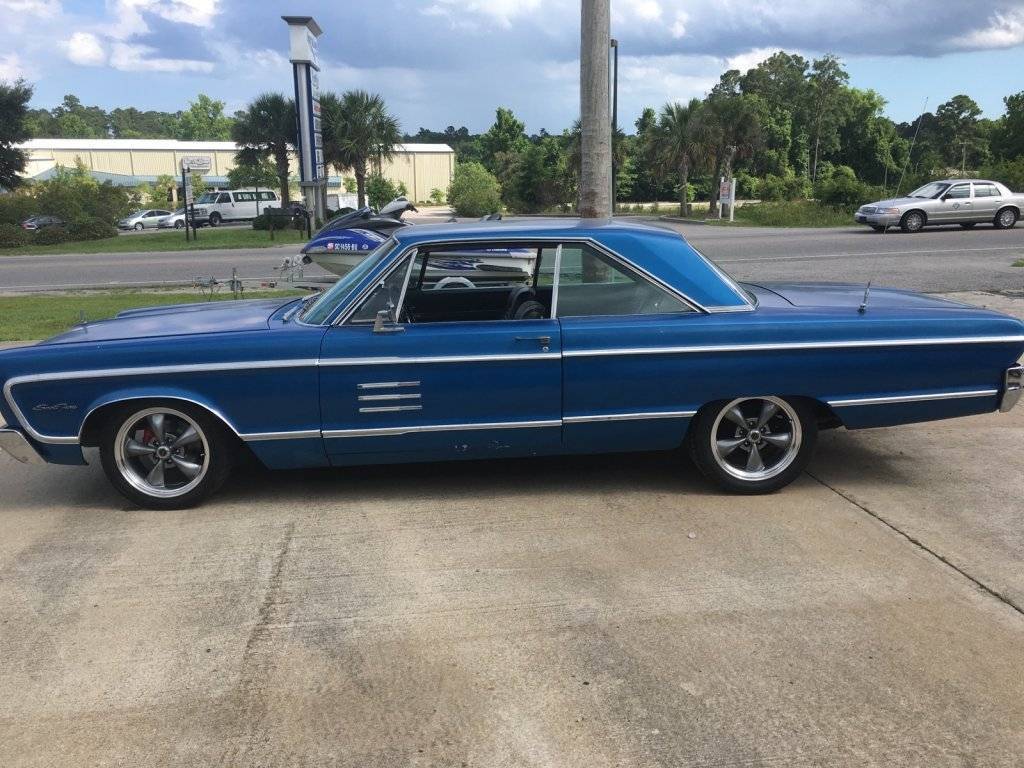

So my 66 fury with 440 was coming along great, wilwood disc brakes done, new rims and tires, aluminium radiator amongst other things and now I have a weak lifter. Makes a horrible noise and I'm not sure which way to go. I have a mid 70s block with steel crank, other than that I don't really know anything else about it. I'm leaning towards the edlebrock top end kit, 2087 but would have to add some roller rockers and a new carburetor. I could just do a new cam and valve train for cheaper but not sure what cam or kit to order. What do you experts recommend?
