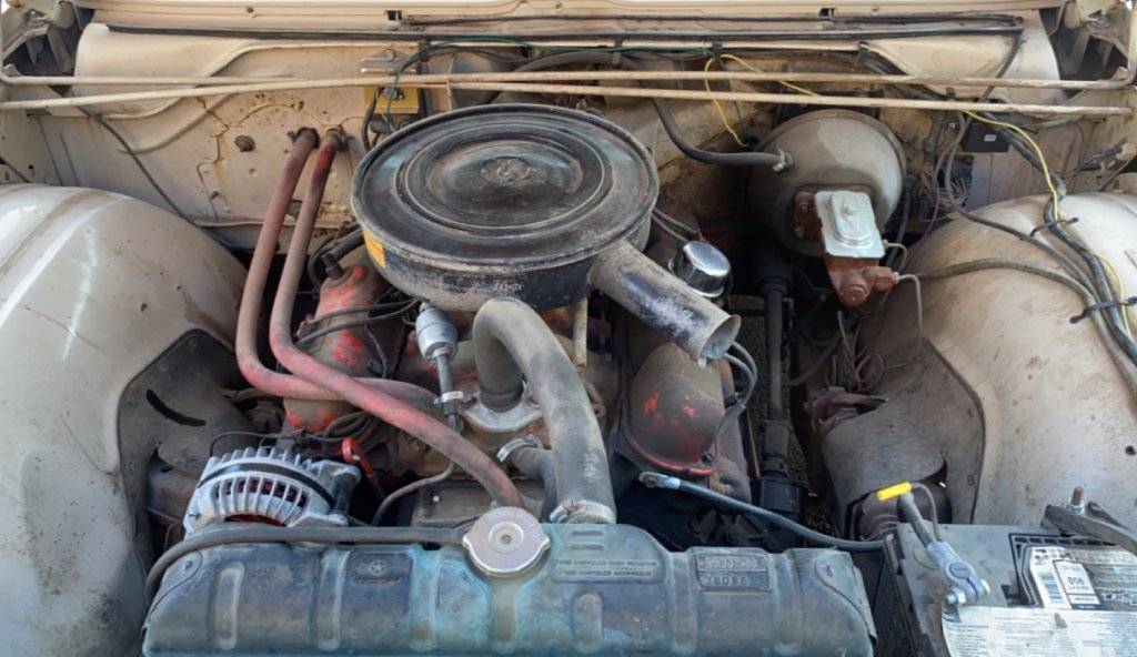

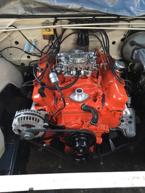

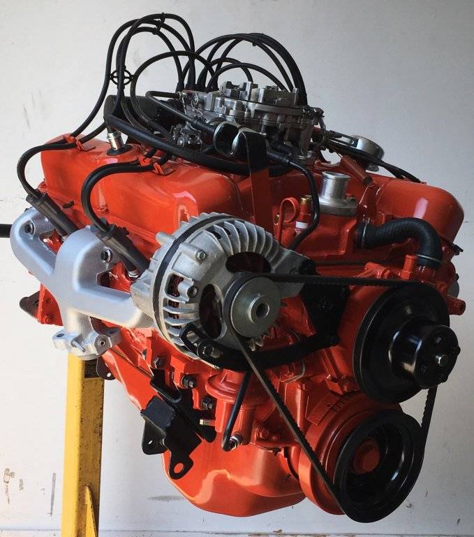

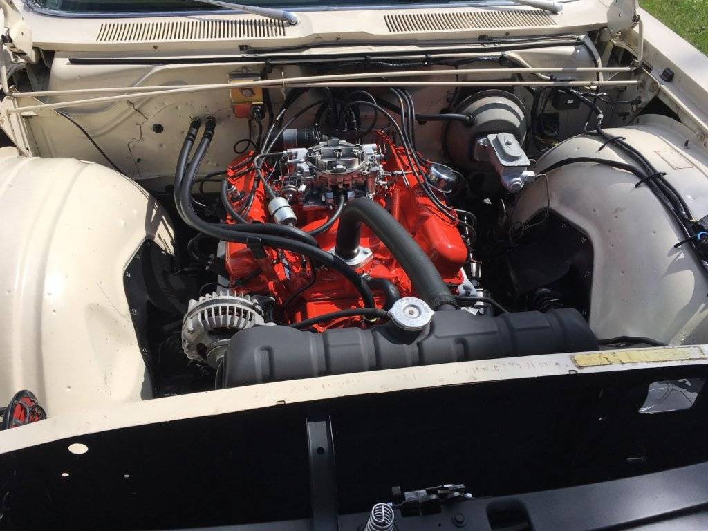

My son wanted a project car so we got a '67 Fury; it needed many things due to age, wear or lack of past craftsmanship. Of the many tasks so far that I undertook, I would like to share a before and after of the engine. Just as a note...the manifolds look the same after months of the engine running without any fading, peeling. All paint I used was normal spray can, the prep is the most critical.

The 318 is a great little motor with the older ones even having 9:1 compression which really helps fuel economy and torque compared to 73 up which would barley make 8:1. An Edelbrock Performer with a small 600 CFM would be fine. The stock Chrysler electronic ignition is fine and not expensive conversion to make. The stock factory 340 grind cam is about all you want for this engine. It can actually give a mileage boost as well as torque increase. Having hardened exhaust seats installed is a must for lead free gas. After 60 years of working on cars for a living the only thing I can say about headers is that you really have to like constantly changing burnt spark plug wires (and burnt fingers, and wrists, and fore arms etc, just ask me how I know this). When you rebuild an engine with flat tappets remember to use an oil with ZDDP (zinc) in it. This prevents lifter and cam lobe failure. All oil used to have this in it but now only the specialty hot rod oils do or you have to buy as an additive. Very critical for cam break in at start up. In the past I spent several years as the Technical Manager of a large engine engine remanufacturer saw a lot of this happen. Flat tappet takes on a whole new meaning when a cam lobe is no longer a lobe but a circle and the lifter bottom is concave with a hole worn right through it. A quicker advance curve is a must, Chrysler used to sell a quick curve advance kit that was about $10.00 that was perfect. Keep the vacuum advance and if you decide to change gearing the best that mopar ever had for the street was 3.23. going more than that will increase acceleration but hurt fuel economy. I had 72 340 Challenger that with a little carb tuning and the spring kit that would leave a 350 Camaro in the dust and still give 25 miles to the Imperial gallon at a cruise speed of 75 mph. You just gotta love that Big Carter Thermoquad spread bore that came on these cars. But enough of that for now, you really have to determine what is causing your current problem first other wise you just might end up putting that same problem right back on to your new engine.
