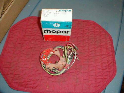

That looks like the correct unit BARGE.Here's the red one I was talking about for Saginaw non tilt column..

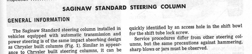

I do have the '67 manual here at the house.Apparently mymopar doesn't have the '67-68 Chrysler service manuals for download.
MyMopar - Mopar Forums & Information - Service Manuals
I have a hardcopy '68 Chrysler manual which I can scan if you're desperate. You have to positively identify which switch you need first.

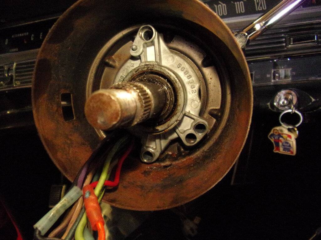

OK.so when you get the replacement,do not pull the old one out right away!! Undo the long wire cover from the column exposing the wires.That looks like the correct unit BARGE.
This is the column mounted turn signal switch for the following models WITHOUT TILT WHEEL and with SAGINAW steering column; PLYMOUTH; Fury I; Fury II; Fury III; Sport Fury; 1968; 1969; ALL. DODGE; Polara; Monaco; 500; 1968; 1969; ALL. CHRYSLER; Newport; C300; New Yorker; 1967; 1968; ALL. 1969 with Auto Trans. IMPERIAL: 1967; 1968; ALL. 1969 with auto trans. This switch is the RED plastic bodied switch. The Chrysler built columns for these years used the BLUE switch.That looks like the correct unit BARGE.

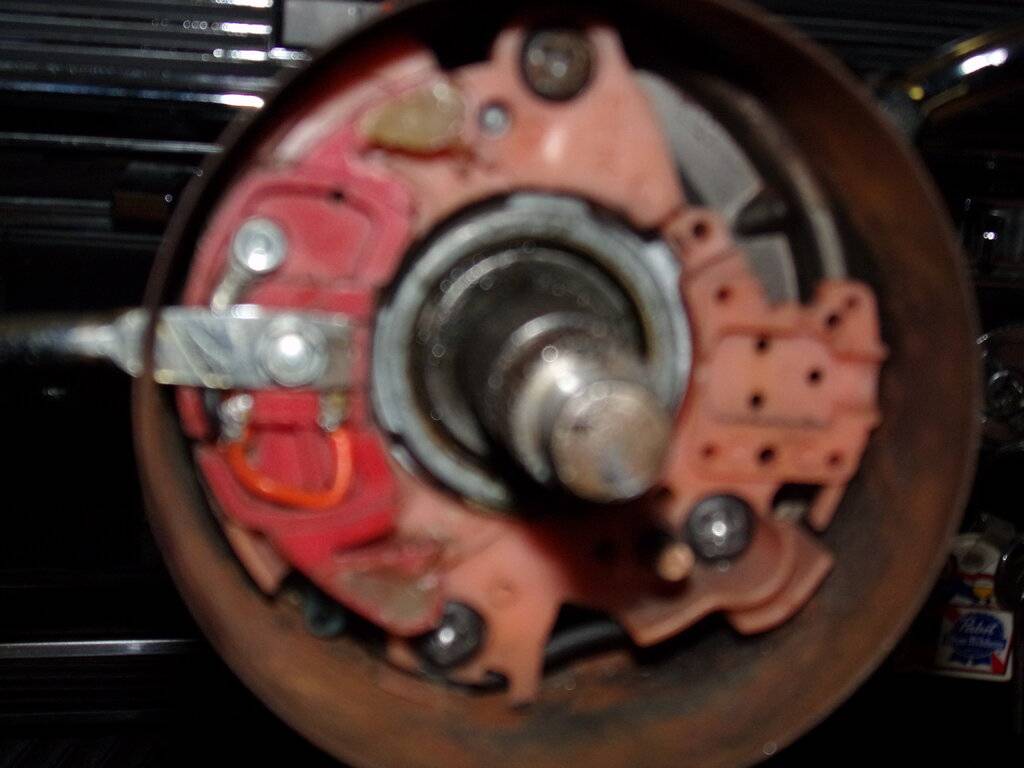

That is without a doubt the Saginaw column.
