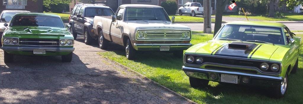

You'll fit in fine.sorry type o I have other mopars that are just as big..lol

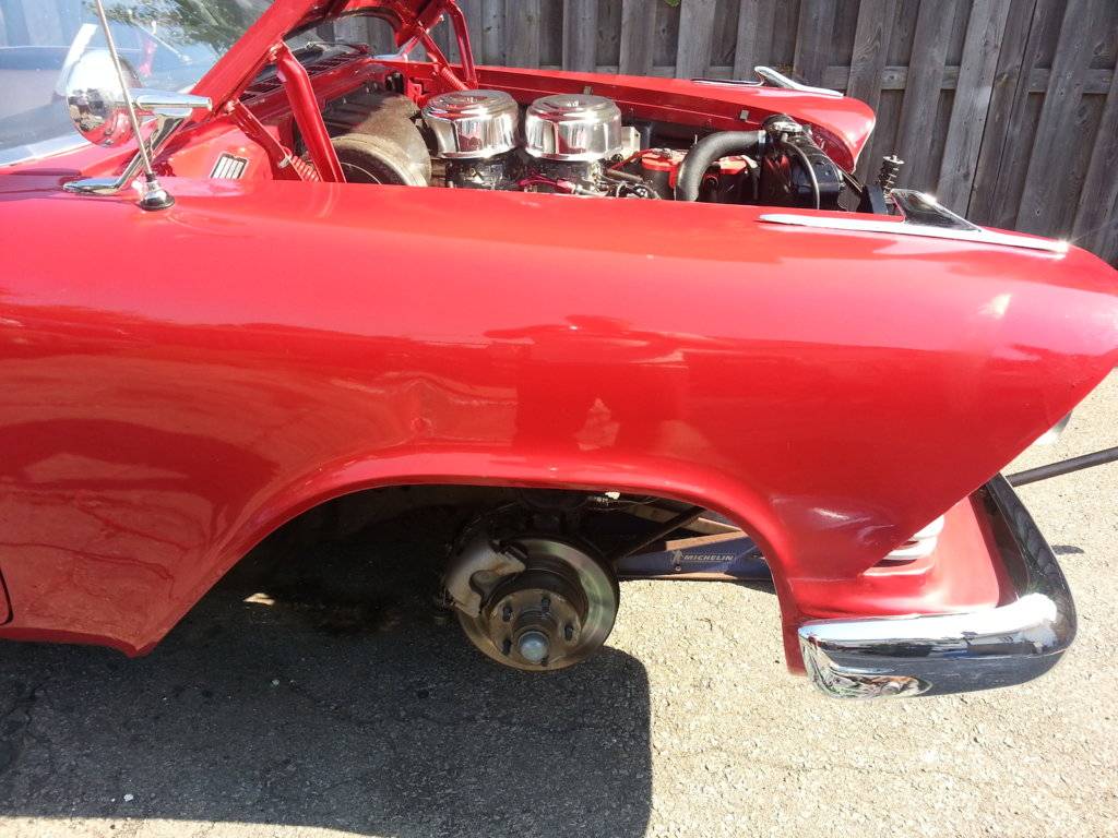

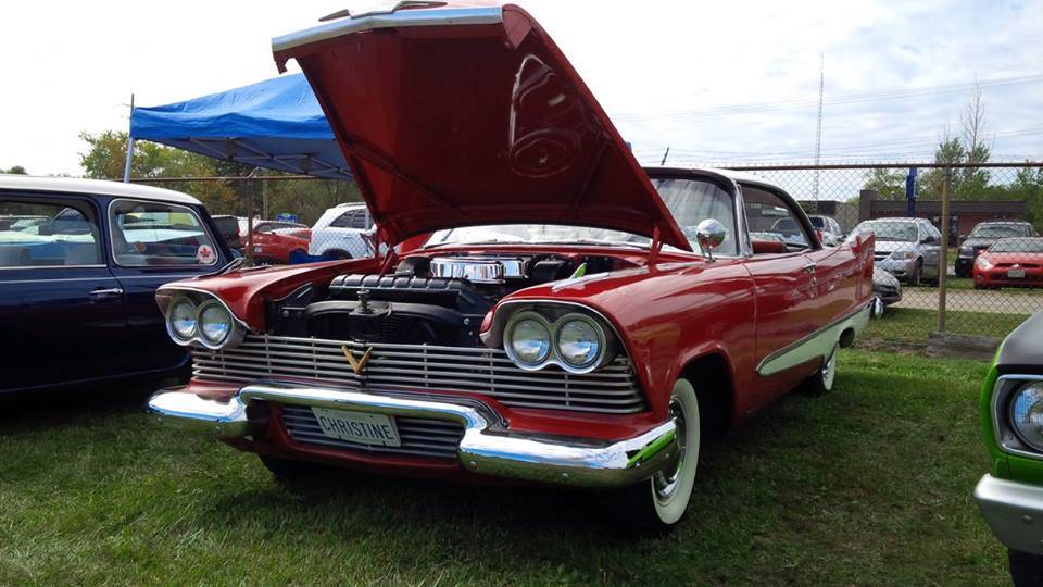

it was org flat head 6 now has a 69 440 40 over 0 decked 915 closed chamber heads 509 cam headers 512hp on the engine dynois the 58 a 318 poly or 350 wedge with twin fours ?
I took out the old rear end out because you needed a puller to get the drums off ..big pain so I put a 69 charger rear end in now no problem getting brakes. the front are now disc brakes off a f body car now stops awesomenice hotrod ride there . i can get with a bit of mods . what brakes did you get to hold on with ?
