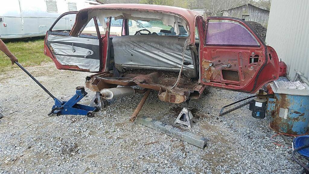

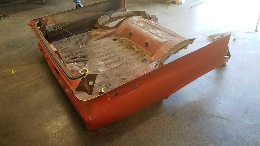

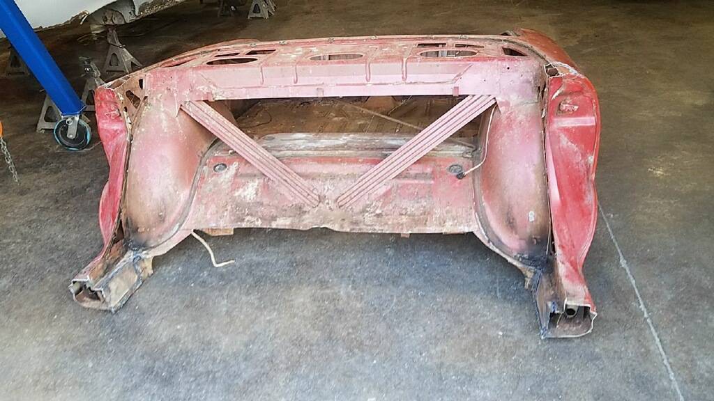

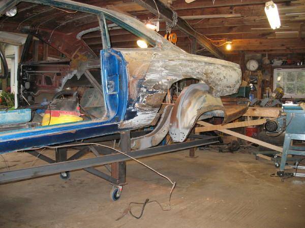

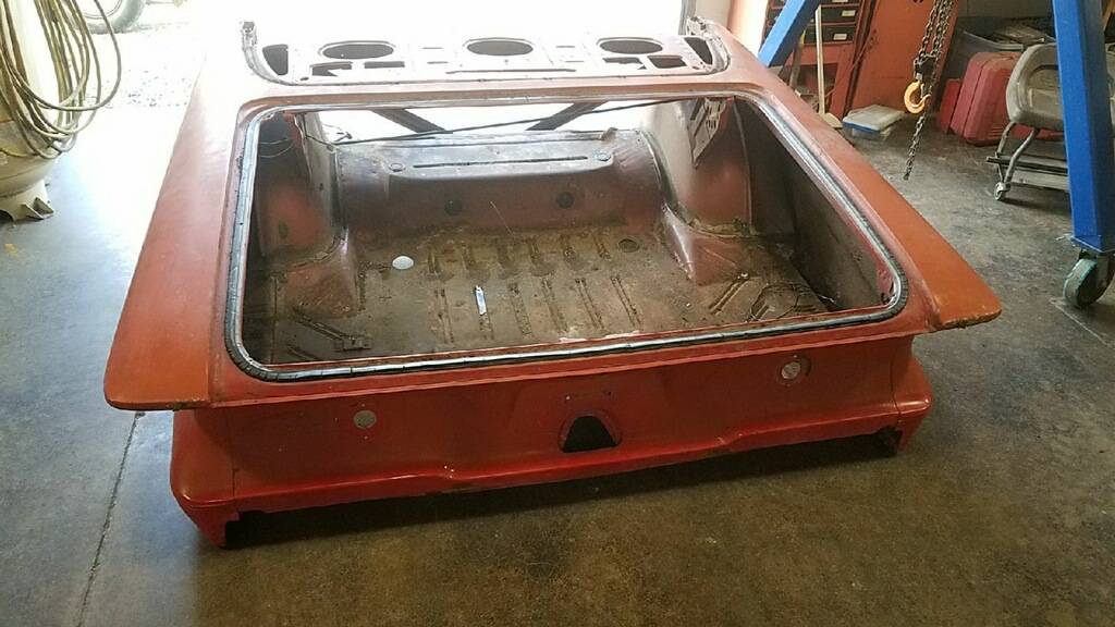

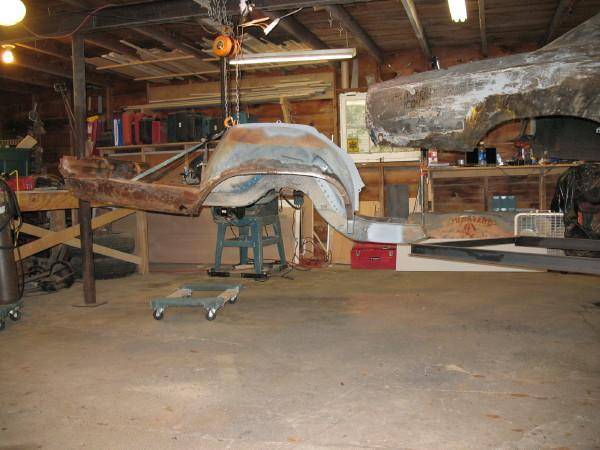

Well, the sparks are flying now! Both rear clips are cut. Lots of measuring and trimming now. Maybe make the graft Saturday.

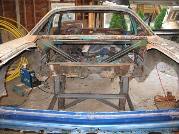

That’s what I did with my ‘68 RR except I used all of the rear frame rails from the doner car while leaving the rear under seat floor pan In place(luckily it was rust free). This allowed me the luxury of many more opportunities to know that I was hitting my marks as they did at the factory and instead of a straight-line butt joint from side to side, the graft overlapped at only factory spotwelded seams. In other words no piece of the unibody was cut, it was only drilled apart at the spotwelds.
