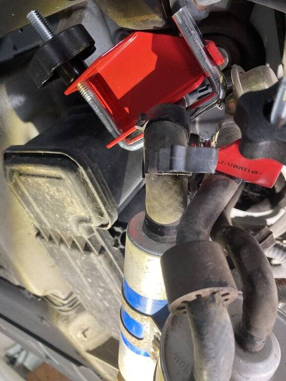

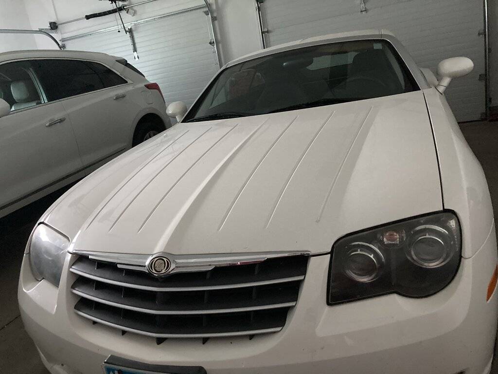

Yesterday, I replaced the fuel pump and filter on my girlfriend’s 2004 Crossfire.
It had sat for 3 years. I am going to change the oil, oil filter today and order engine and cabin air filters.
Brakes feel mushy (a mechanic of unknown trust worked on them 3 years ago), so I plan to check the front pads and bleed the brakes. Finally, I will have the headliner replaced by an upholstery shop.
The car has ~47k miles and runs great.
I love the Crossfire, but I can't get in them. Looked at both a convertible and the coupe, and they were both a bear in ingress and egress. And I thought my old '95 Corvette was a pain! But, boy, are they fun to drive!

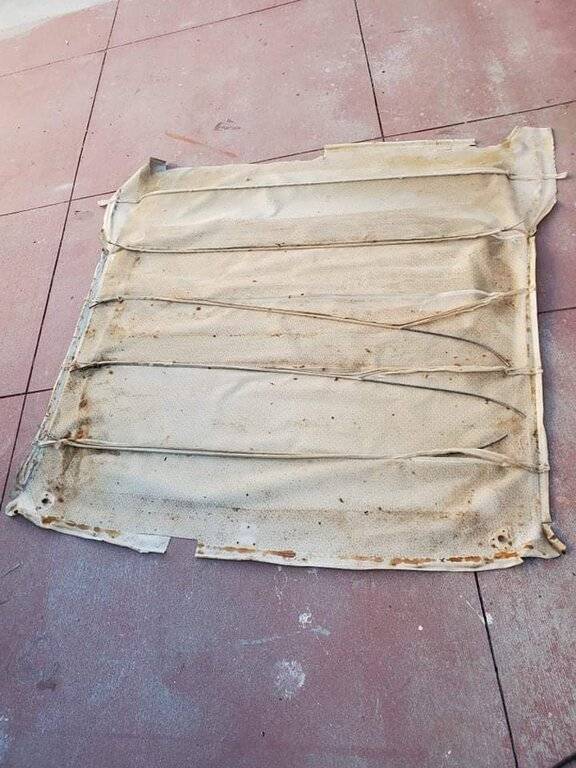

I pulled the original headliner and insulation out of the 66 300 today. I was able to get the new insulation in before the heat ended the day.

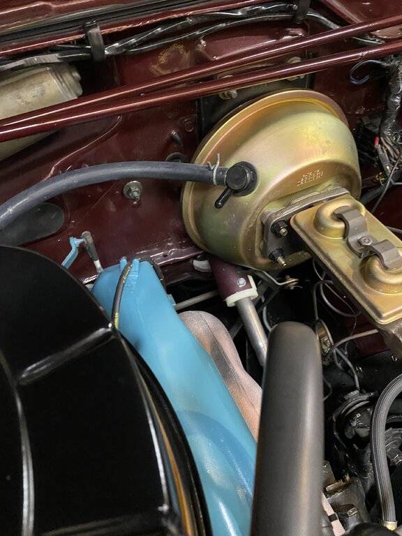

Took my car for a drive for the first time since last Sunday. It just wasn’t running as smooth as normal at idle and smelled a little rich. I first noticed it last Saturday when in Stillwater but chalked it up to being 97 degrees. When idling in gear it seemed a little rough, but in park or neutral it would idle better. I decided I would put my tach and vacuum gauge on and tweak the idle mixture. Low and behold I was missing the cap on my vacuum booster Tee. It seemed that sometime in Stillwater last weekend it fell off or I knocked it off dusting my engine compartment. I have done this a couple of times in the garage so I should have replaced it then. I put a new tighter one on it now and idles much smoother and acts normal.
It’s always the simple things.

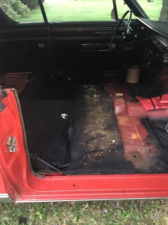

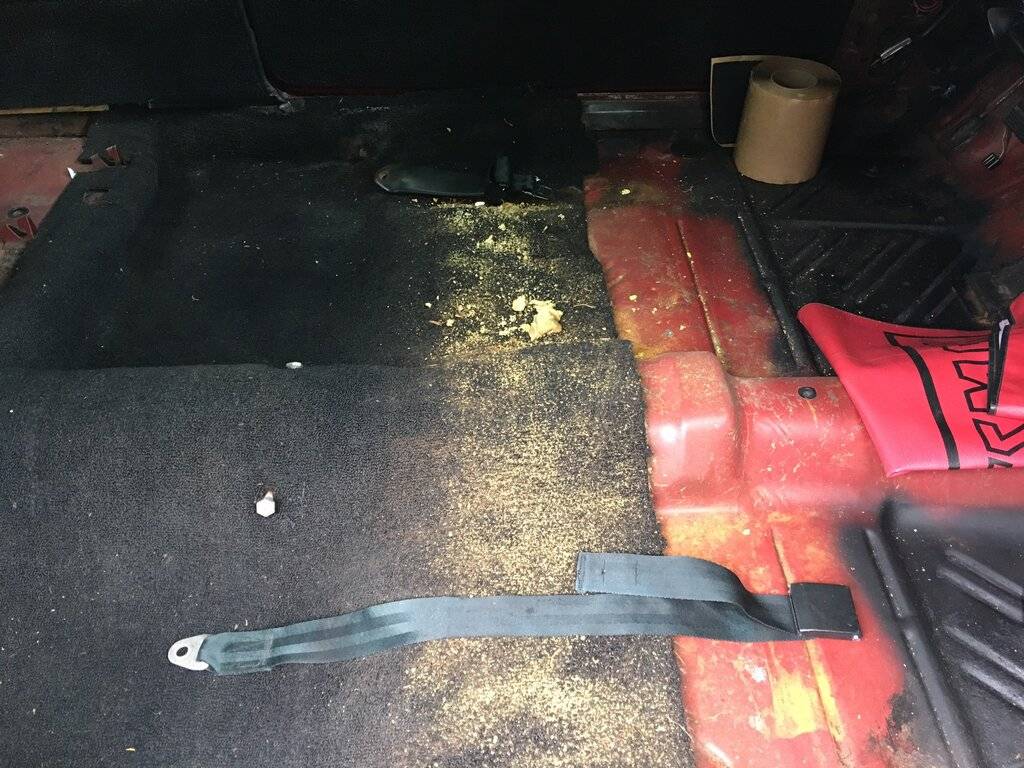

I've spent some time getting the interior ready for new sound insulation and carpeting on my 68 New Yorker. There was a leak coming in from the cowl that destroyed the original carpet and padding up front so I had tore that part out piece by piece when I first found the car. No more leaks.

I think my '68 has a leaking heater core that was draining inside too. I bypassed the heater unit for now but the carpet (front and back) is already pretty damaged. I think I need to rip the carpet and padding out fairly soon or I will end up with floor panel issues, if there aren't any already. From underneath it looks solid though.

When I found mine, the owner said the exact same thing. The heater core was leaking so they bypassed it by connecting the heater hoses together. I have yet to test that out. I poured water into the cowl as a test and found lots of water came straight on to the floor behind the dash. I sealed the cowl drainage area to stop it. I didn't try Auto Carpet but I did find some good Jute padding from Legendary Auto Interiors

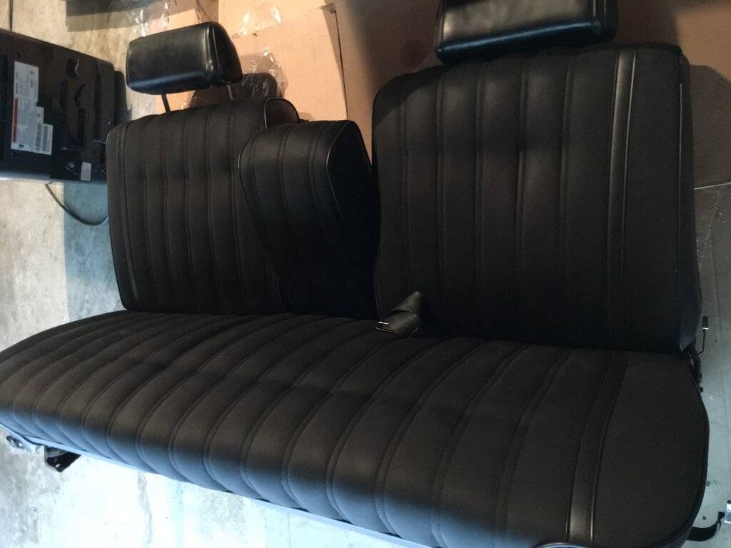

Taking my truck seat and visors to the upholstery shop Friday morning.

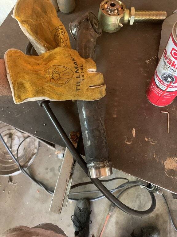

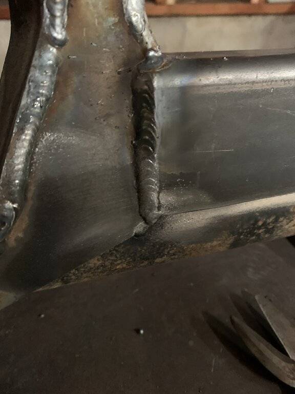

Got the jeep up on stands right now. New leaf spring bushings in the rear, boomerang shackles, rebuildable heims on both the upper and lower CA's, bushing to uniball conversion on the upper CA mount of the axle, and a new front axle housing. On the housing I'm boxing it, doing a minor truss, and I'm welding on C-Gussets (the old housing was SHOT).
Forgive the goobered welds on the housing. There were a lot of start and stops to prevent warping the axle tube.
The truck seat and visors are at the upholstery shop. Saved over $100 on my material! July 9 is the target date. Brake parts are ordered.
