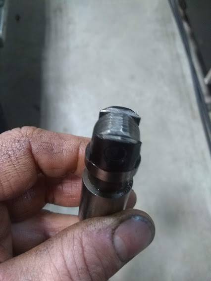

It belongs to my kids friend, he been around about 16 years so I guess he is like one of my own. He will usually help when I work on his stuff, but he had to work. It had a misfire on #3, he changed the spark plugs and coil on #3 and still had a misfire. I checked the spark, fuel injector, injector pulse and coil pulse, compression on #3. I pulled the valve cover to find #3s exhaust rocker out of place, I popped it back in place and put it together. Started it and drove it, all 8 cylinders again. I don't know what caused it, stuck lifter, high rpm???? It's ok now
Bad picture, but you can see the lifter tip and #5 intake rocker
“ I don't know what caused it, stuck lifter, high rpm????”
Excessive RPMs me bets.
Good work!
I asked him if it happened when he was hard on the throttle, he didn't know when it happened. But I am leaning towards high RPM also

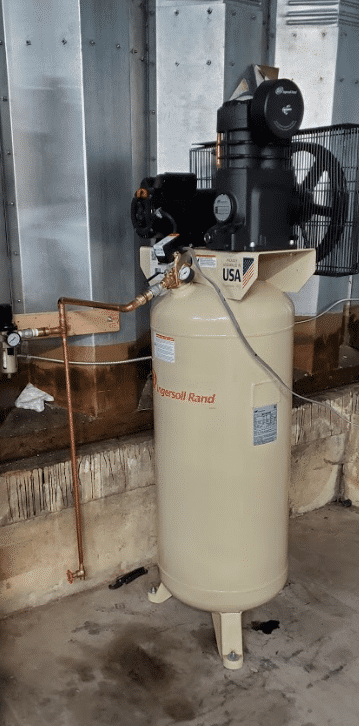

Installed our new high-capacity air compressor! It replaced an old 70's Craftsman 30 gallon portable unit.
Some may call it overkill but the way I look at these kinds of major purchases is that the things I'm buying I want to last me the rest of my life. And now I can use my bead blasting cabinet at 100% without having to stop and wait for the compressor to catch up!
Love it, I am green with envy.:thumbsup:

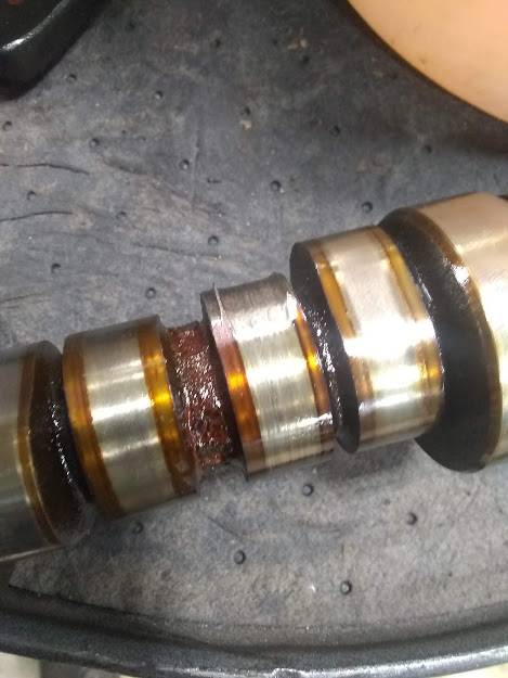

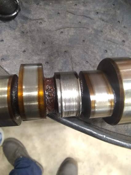

I did this last week. Another 5.7 Hemi with a bad camshaft and lifter
A cam, set of lifters, flatten the heads, some gaskets and out the door it went.

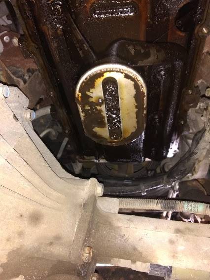

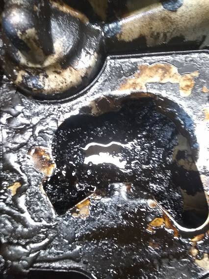

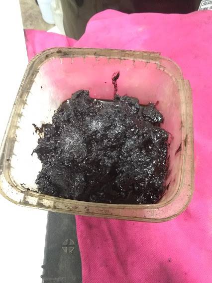

Last Friday I had a 02 GMC 1500 with a 5.3 without oil pressure. 1 owner, 200,000 miles. I pulled the oil pan and found this....
Here is the screen
This is what I dug out of the pan.
Cleaned out the pan, removed the screen and cleaned it, put it all together, oil in it and we have oil pressure again.

Wow - single owner and maybe a single oil change.
My 2014 Ram 5.7 started chirping at 136k. Sounded exactly like a bad belt tensioner bearing. It wasn't... big job swapping out those cam n lifters

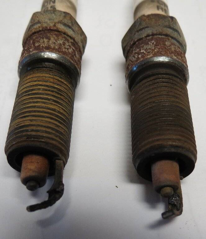

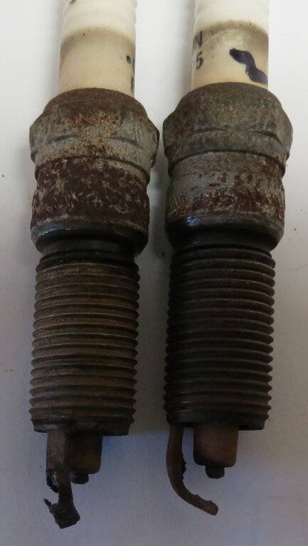

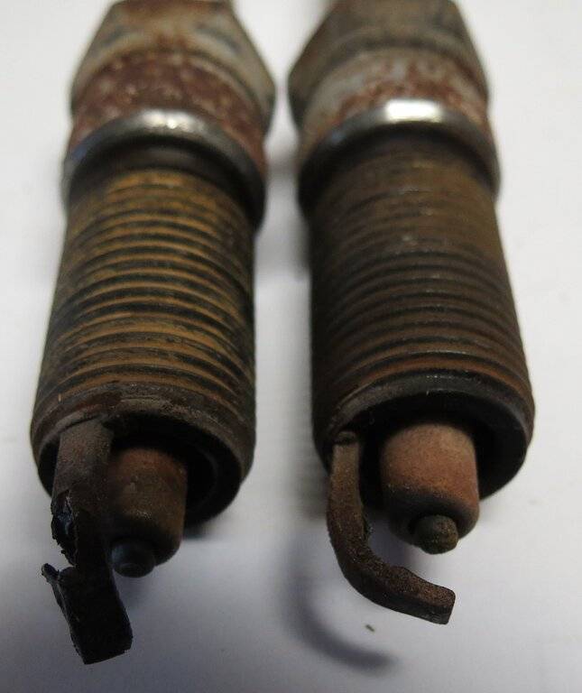

Did a little work on a relative's car that was badly neglected in the maintenance dept. These are what plugs look like on a Wrangler with 170k, surprisingly it ran well.

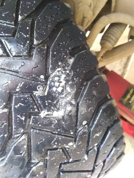

This afternoon one of the guy's I work with came in from the parking lot and said I had a low tire.
I found this....
A plug later and I was on my way home.

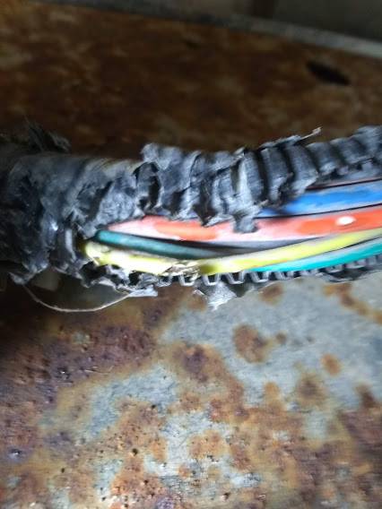

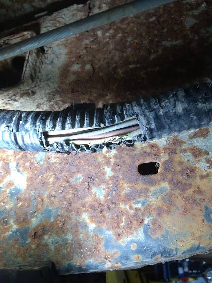

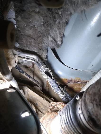

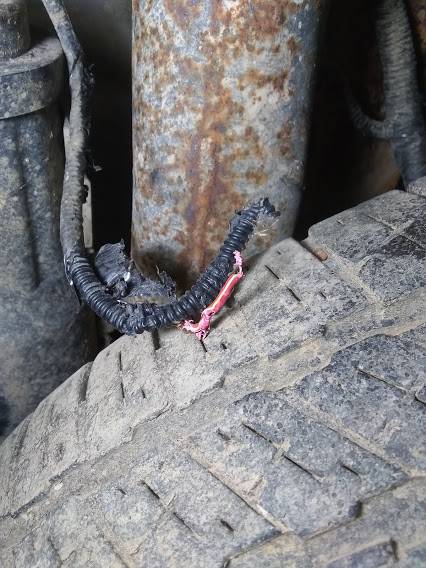

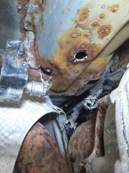

I am putting a engine in this Ford F-150 right now and while under it I found this rodent damage.
