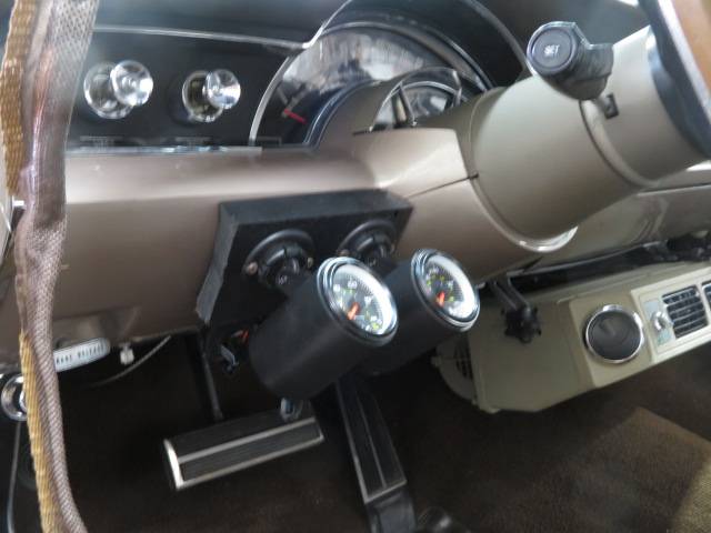

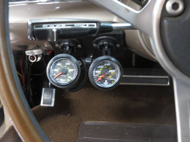

Finished installing the gauges in the 'Party Barge'. As is has aftermarket A/C, suitable gauge locations are few. Found the gauge pods on E Bay. The mounting plastic was some scrap from another project. Took a little while to figure out how to contour the plastic to the dash. The other issue to overcome was to utilize the existing mounting holes. I dislike putting extra holes in panels.
Seat View:
Door View:

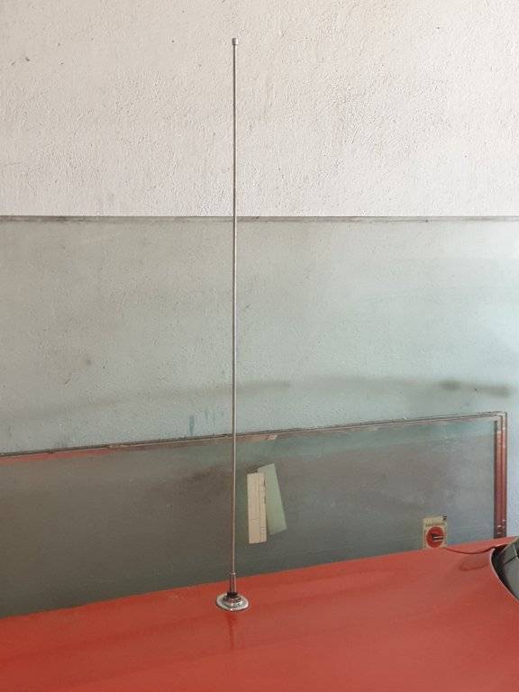

No big deal, but today I installed the NOS antenna mast on the Sport Fury that Hilltop Auto Parts supplied to me. Just one more piece to complete her...
Unfortunately there is salt on the roads, so a test drive was not possible :(

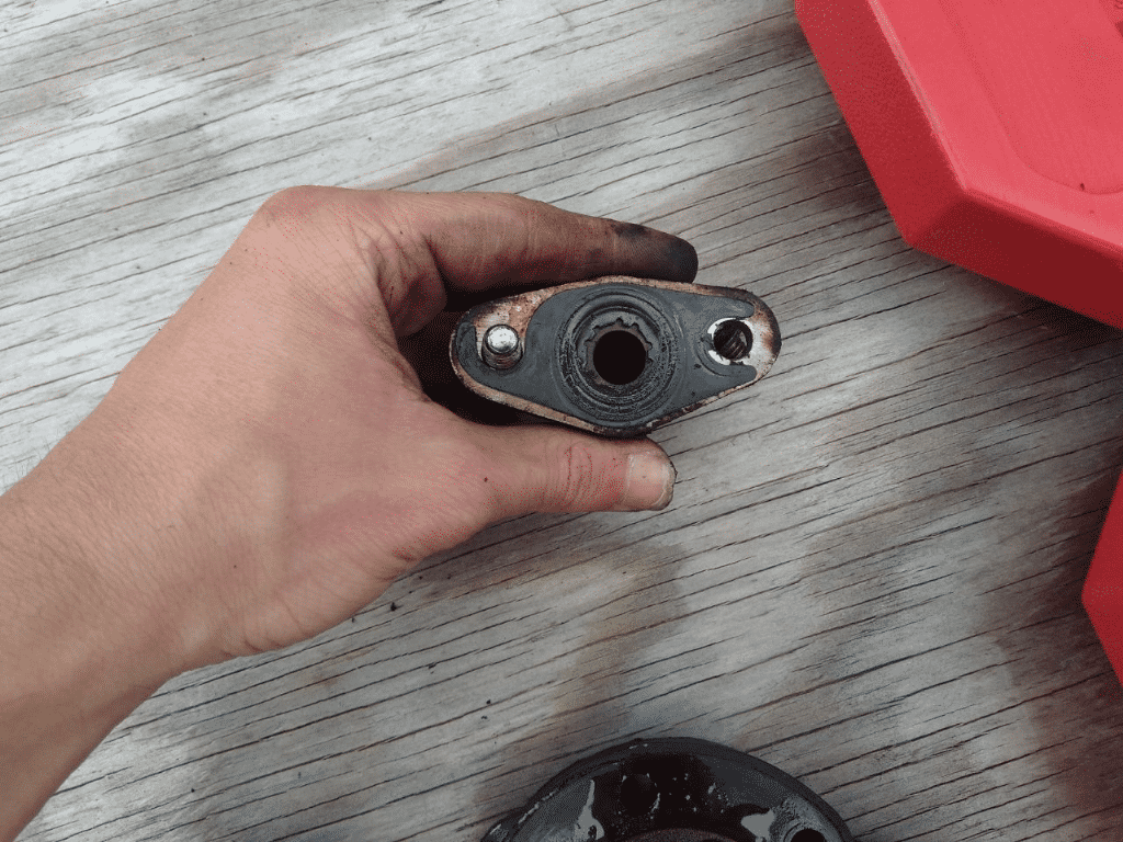

Took apart my AC compressor as I wanted to go through it anyways. I swear, some of the stuff looked brand new if it wasn't already: I was really impressed with what I saw.
I even took the clutch off without that special tool: I had a scraper nearby, one of those that has the cuts built into the metal (similar to this: )
Put that inside the slot, and threaded it right out without an issue (it hooked onto one of those bumps on the clutch plate, and from there you just had to hold it while putting pressure on your wrench). Anyways, after that, it was really self explanatory how to disassemble it. The only thing is I ran into a bit of a SNAFU: One of the piston's connecting rod bolts absolutely would not unscrew (it's 3/16th - the first one worked fine), but the second piston absolutely would not budge. The socket would just skip over the threads. I'm not really sure what the issue is because the rod doesn't seem seized (the AC compressor spins fine) and the rod itself doesn't look melted or otherwise warped - and the bolt head doesn't seem stripped either. That was my only issue in an otherwise perfectly disassembly.
Anyways, the pictures:
I know they sell (or used to, anyways) those rebuild gasket kits for the RV2, so if I can ever get that second piston out I'm giving everything a THOROUGH cleaning and soak and then using that kit to put everything back together.

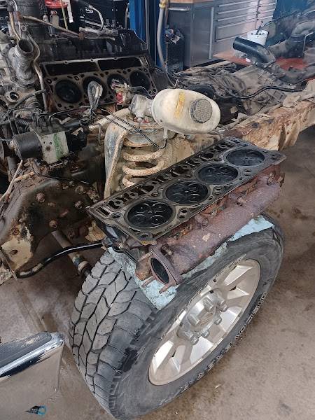

I pulled this apart last week at work and sent the heads out to be flattened.
This is actually the easiest way to work on the engine, in the Ford tech info they have cab on or cab off methods of head removal. I would hate to do it with the cab on.
