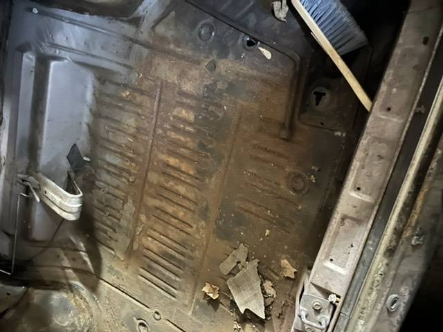

Cut trunk floor out of 65 Fury last weekend.Heading over to donor to drill out about a 100 spot welds today

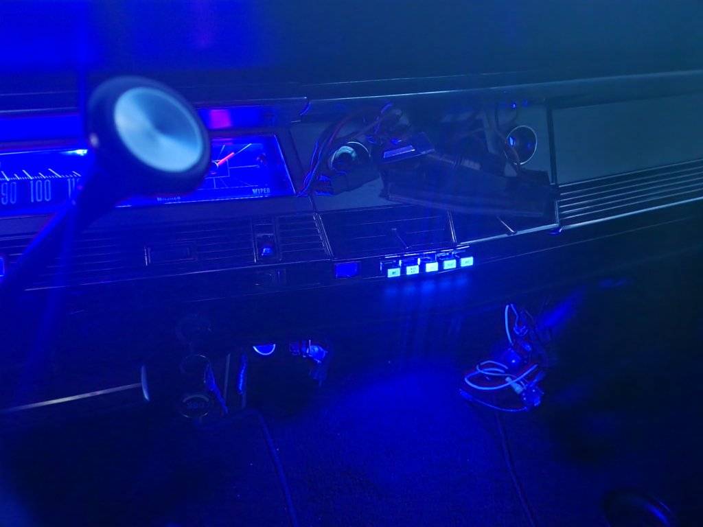

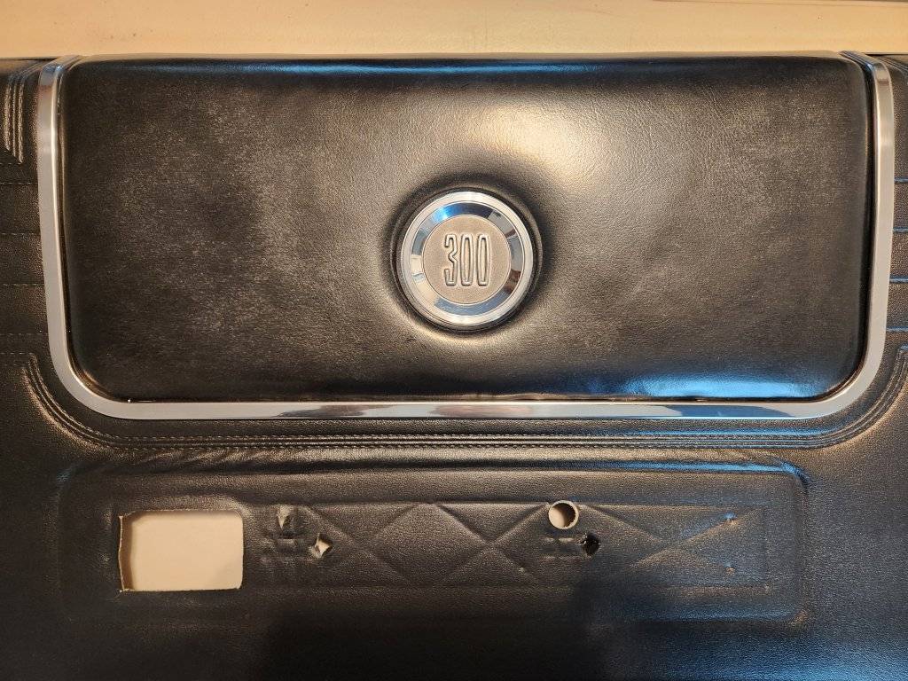

The winter projects continue on my '68 Chrysler 300. The stock radio was removed and it's in Rhode Island for conversion to modern components USB, Bluetooth, chrome re-polish etc.,which should pair up nicely with power antenna I rebuilt and the new speakers I installed. The radio should be returned back to me in a couple weeks. The rear seats were removed to have them re-dyed to correct a few minor blemishes and scratches. My upholstery guy also repaired the vinyl on the door cards in which the vinyl shrunk above the armrests and pulled away from the stainless trim that surround the 300 medallion. Minor stuff but got the seats and door cards done in one shot.

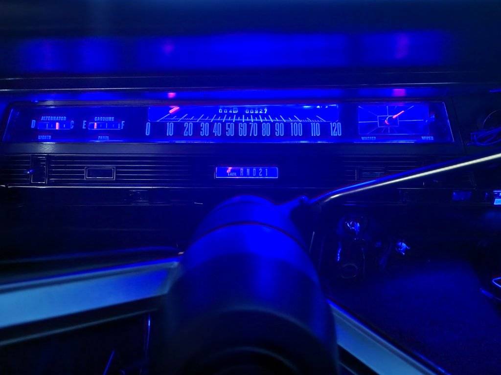

Today dropped the steering column to install a LED bulb behind the instrument cluster . Just one bulb which is the only one that is impossible to replace from underneath. Chrysler used blue / green lenses to filter the white light. So I thought what it would look like with blue LED for the dash instruments. I am pleased with the results. The orange indicator needles have a fluorescent color. The picture doesn't give it justice and looks better in person. It has a calm, mellow, and modern feel look to it.
Next up is the driver's side power vent window. It works but needs a little persuasion to open and doesn’t close all the way by just a hair. Just enough to get the irritating whistling noise driving at highway speeds.

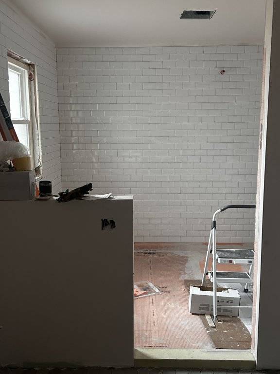

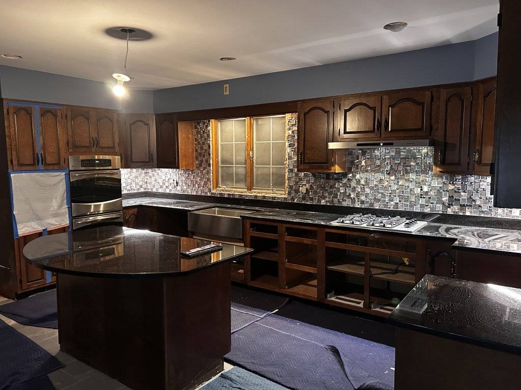

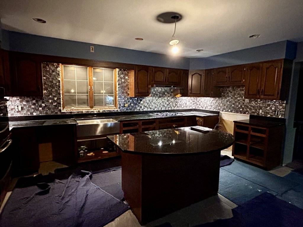

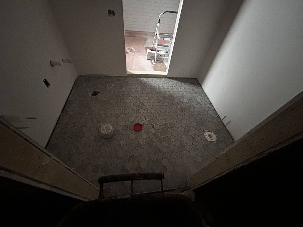

The construction crew has been working on the kitchen and master bath. They got the countertops done and ran out of backsplash tile. That should be finished this coming week.
They also had ordered the incorrect floor tile for the bathroom, which has been rectified.
Tiling should be completed this coming week.
I’m going to correctly relocate the outlets for the dishwasher and garbage disposal, which requires me to contort myself and get into the crawl space, but it’ll be good in the end.
I also have to run a 1/2” pex line from the utility room in the garage to the kitchen, which will require crawling into the breezeway crawl space as well as the existing house crawl space. Yay!

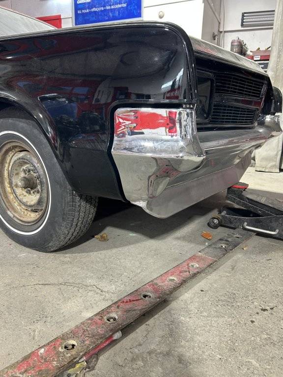

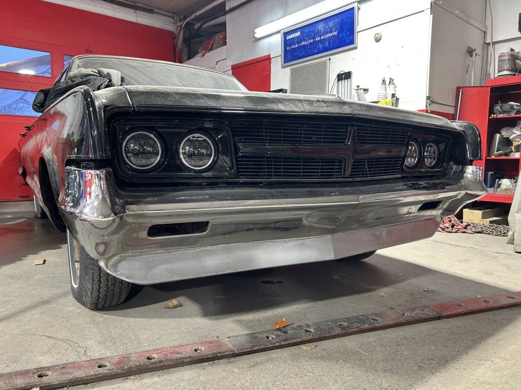

I started working on Colorado Saturday. I hit a deer in November with it. My insurance company totaled it and I bought it back. I bought a hood, bumper, grill and lights from one yard, a fender from another yard, a radiator and condenser from one of my suppliers. I got the radiator and condenser put in, coolant back in, and removed the bumper. I will start putting the rest of it together next week. I had to order the brace from the lower core support to the upper core support w/hood latch, and I found a bad a/c line also
Before

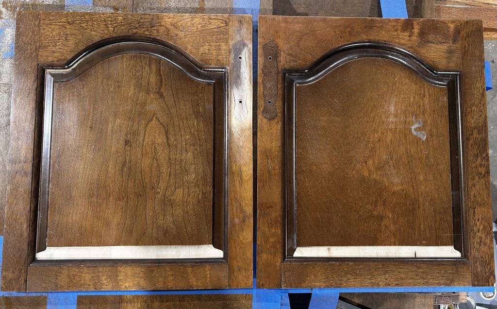

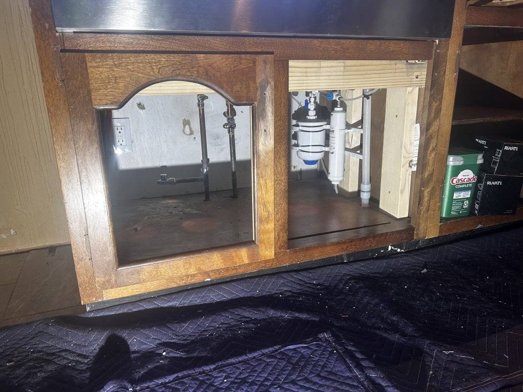

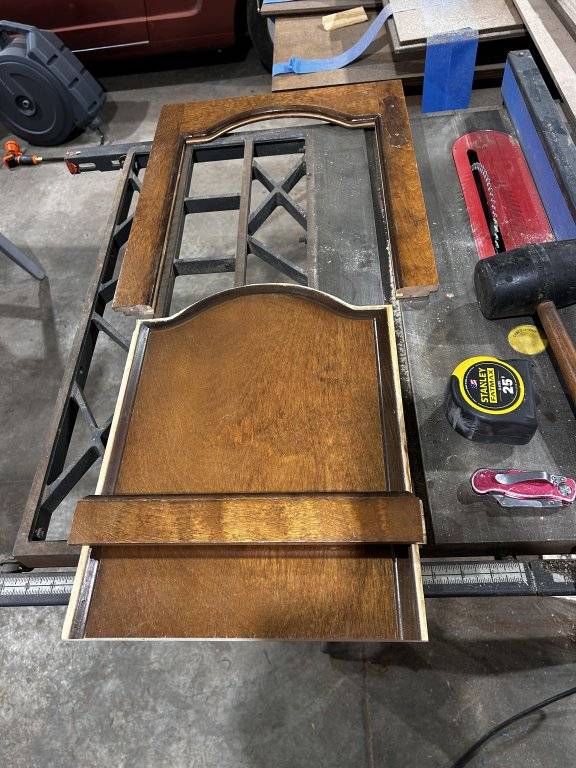

Yesterday and today, I vertically shortened the cabinet doors and facia behind them to fit under the apron sink we have installed in the kitchen.
I now can sand, stain, polyurethane and assemble them.
I took about 3” out of them.

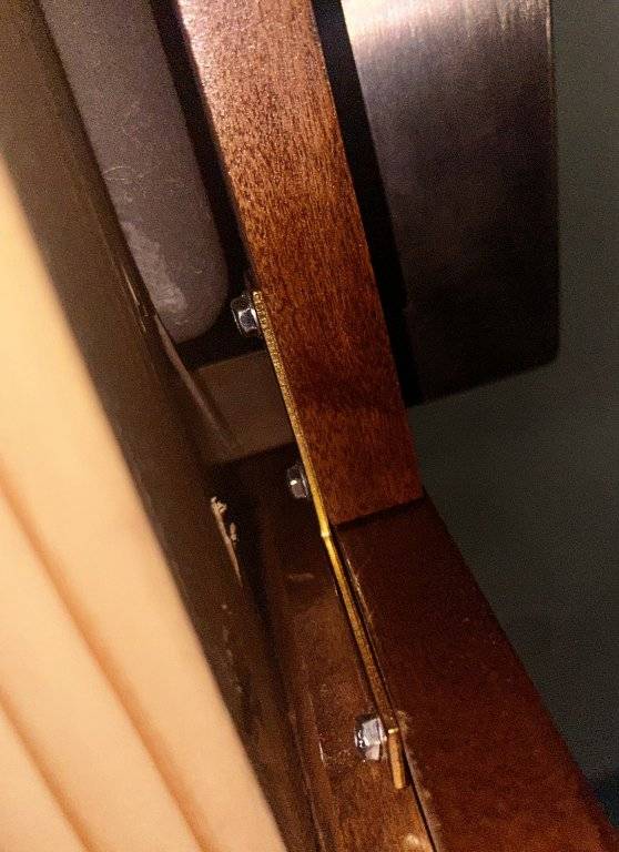

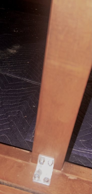

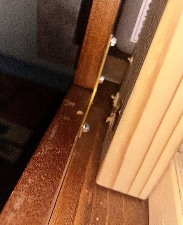

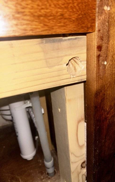

I got the facia mounted for these doors yesterday.
I used brass angle brackets and some shortened self tapping sheet metal screws that have a hex head on them. Due to the 2 x 4 right behind the facia, I had to drill a hole in each side to get one screw in on the vertical part of the angle bracket.
I also secured the bottom of the vertical door separator with a piece of angle aluminum.
I like how it turned out.
The carpenter doing the trim work will run a quarter round piece of trim around the sides and bottom of the apron sink. He had to trim the facia on each side to get the sink to fit and the quarter round will finish it off nicely.

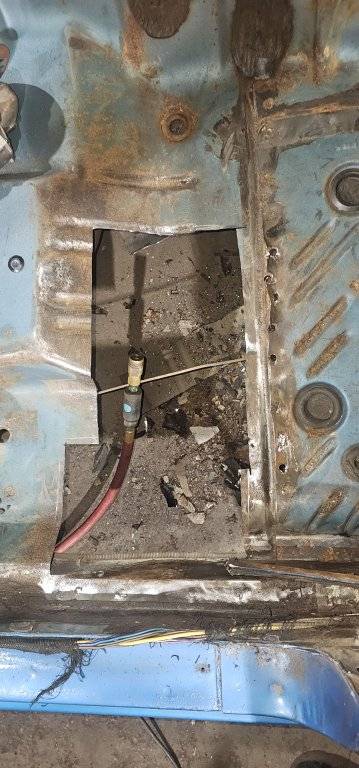

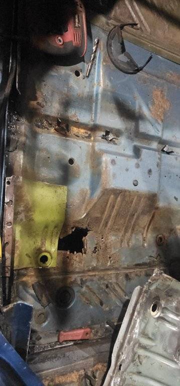

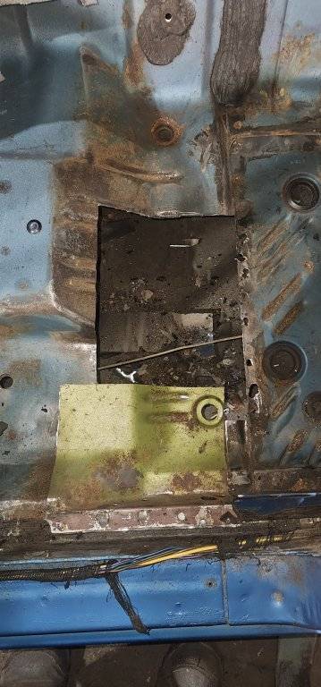

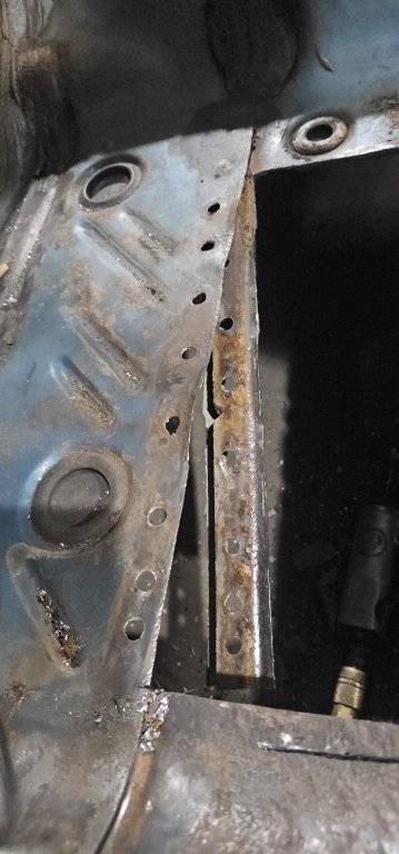

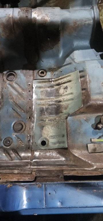

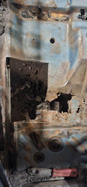

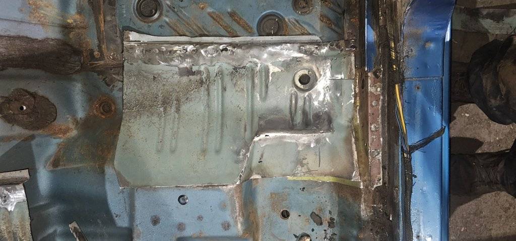

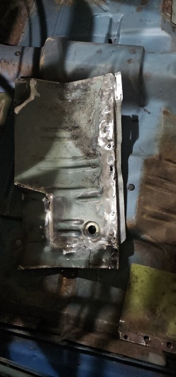

Been cracking on some floor repairs for @GOLDMYN recently
A Little bit more trimming fitting and I should be welding up the patches for the rear floors and moving onto the smaller stuff in front.
