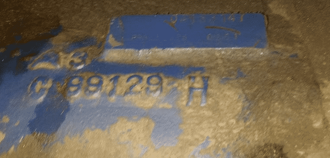

Kinda hard to see the stamp in this pic, but it's a 4 speed

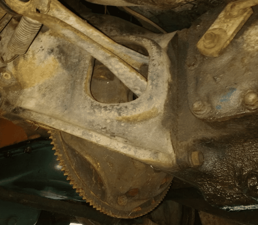

I assume the flywheel is not supposed to be exposed like this, so something is missing

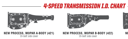

comparing it to this chart, I'd say it looks more like the B-body style vs. the A-body
The stamped heavy steel dust cover is missing. A blessing in disguise now that you can acces the clutch disc and free it up off the flywheel.
4 speed is a bonus. Worth keeping if you can figure out whassup with the shifter linkage
have you tried rocking or towing it back and forth while working the pedal?
if you get it free, cut a piece of 2x4 to wedge between the seat and pedal or it will stick again.
