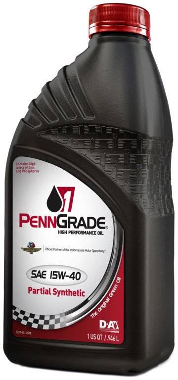

1. are you referring to this semi-synthetic Brad Penn PennGrade1 15W-40? (photo below)

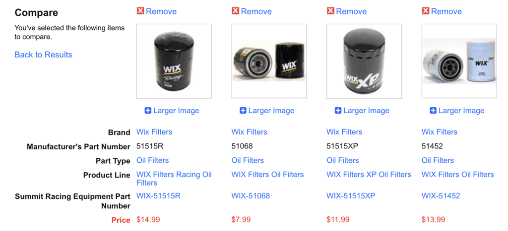

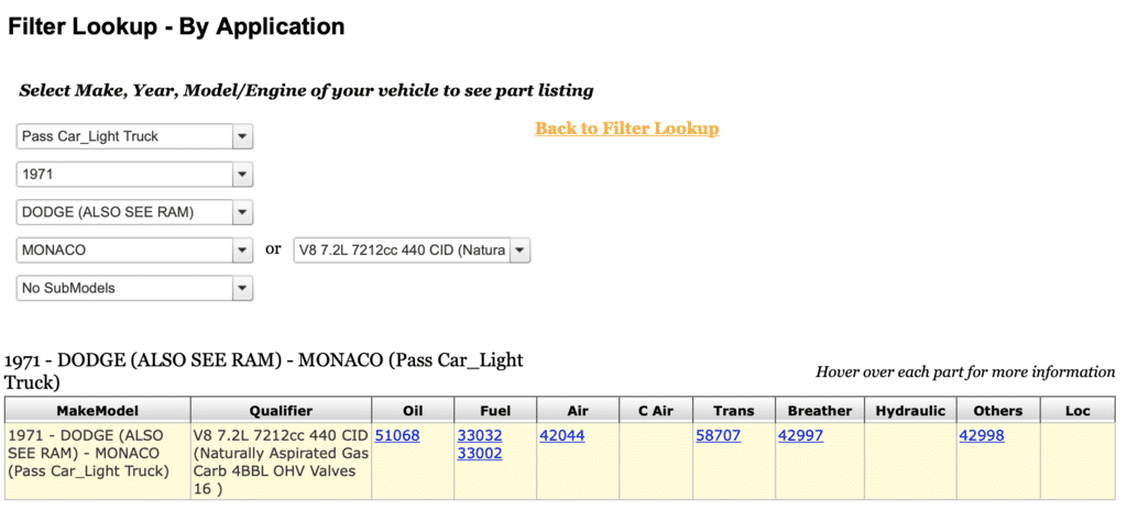

2. Which WIX filter do you use? For my '71 Monaco, Summit lists 4 different ones (photo below) whereas the WIX website only suggests the cheapest one, 51068.

Yes, Brad Penn is now Penn Grade and that is the oil that I and others recommend. I suggest buying it by the case off eBay or on Amazon.
If your engine is a bit tired and uses some oil, or if you live in a very hot climate you might want to consider the 20W-50.
I use the NAPA Gold 1515 oil filter, which is made by Wix and is the same as the 51515XP. The NAPA gold 1515 is only $8.00. The 51068 is the short version of the 1515 and the 51452 appears to be a a tractor application.
The Wix 51515R is the racing oil filter.

Yes. The Penn Grade 15W-40 semi synthetic is the oil I am thinking of. I feel it may flow a little better at start-up than the 20W-50. Also, the WIX filter Bill mentions above is the one to use, and I usually get the NAPA Gold version. Summit also sells the WIX brand, and its the same filter as the NAPA Gold.
