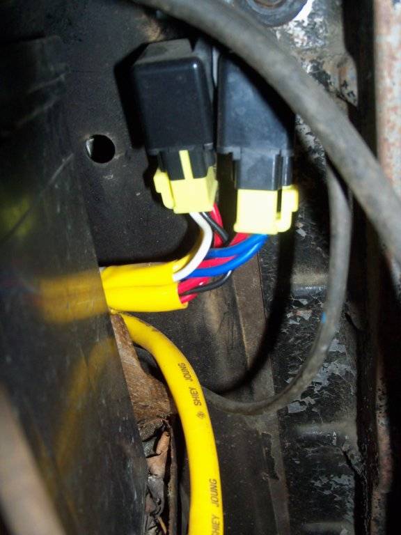

I will give a second vote for the factory, non-halogen bulbs. These cars had good headlights when new. Most of the problems with dim lights as the cars aged was due to poor grounding of the core support, corroded connections in the firewall plug, corroded terminals for the dimmer switch or corroded terminals in the light switch. All of these problems are easily corrected. You are off to a good start by bypassing the load on the firewall plug and the light switch with new wiring to a relay. Run a ground strap from the core support to the ground lead on the negative battery cable. Use wiring from the dimmer switch to activate two relays, one for high beam and one for low beam, replace the dimmer switch and plug if necessary. It takes very minimal amperage to cycle the relays. Run clean fused power to both relays for the headlight load circuit, you can do this off the big terminal on the starter relay, that way the fusible link remains as a fail safe in case of a big short someplace. I would also suggest a circuit breaker, appropriately sized, on the load side of both relays as added protection. I like to start this conversion with a new light switch and a new dimmer switch so I know I have good connections. You will also want to check the ground connection from the headlights to the core support and all headlight plugs for corrosion. Install new plugs as necessary.

Good points there on the grounding straps, connections and suspension. I am using the old connectors at the headlights but installing new packard pins and 12 g high temp wire for those, 6g from the starter relay to a circuit breaker and using the original wiring as a trigger. Everything inside the car works fine and has been cleaned or repaired/replaced/rebuilt. I just rewired the entire dash too. I just want the best lighting I can afford without spending money i dont have to for something that doesnt work any better.

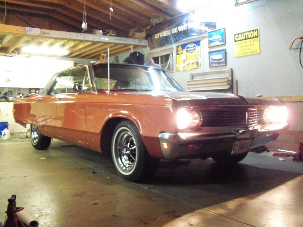

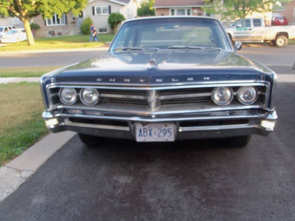

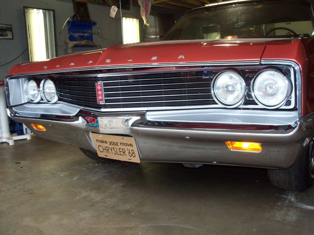

Hella BiFocus low beams with 50w bulbs. Hella H1 high beams with 100w bulbs. 10 gauge power feeds to the high beams in a custom built, relay operated harness.
The BoaB is running Hella H4 low beams and H1 high beams with PIAA super white bulbs powered by a Putco wire harness with two relays.
After the big road trips during the BoaB World Tour,I can honestly say they work excellent and has the longest throw of light.
The 66 300 is running low beam sealed halogens and vintage GE 25 plus incandescent high beams with a relay harness and is not as bright but can see down the road well with all 4 lights on.

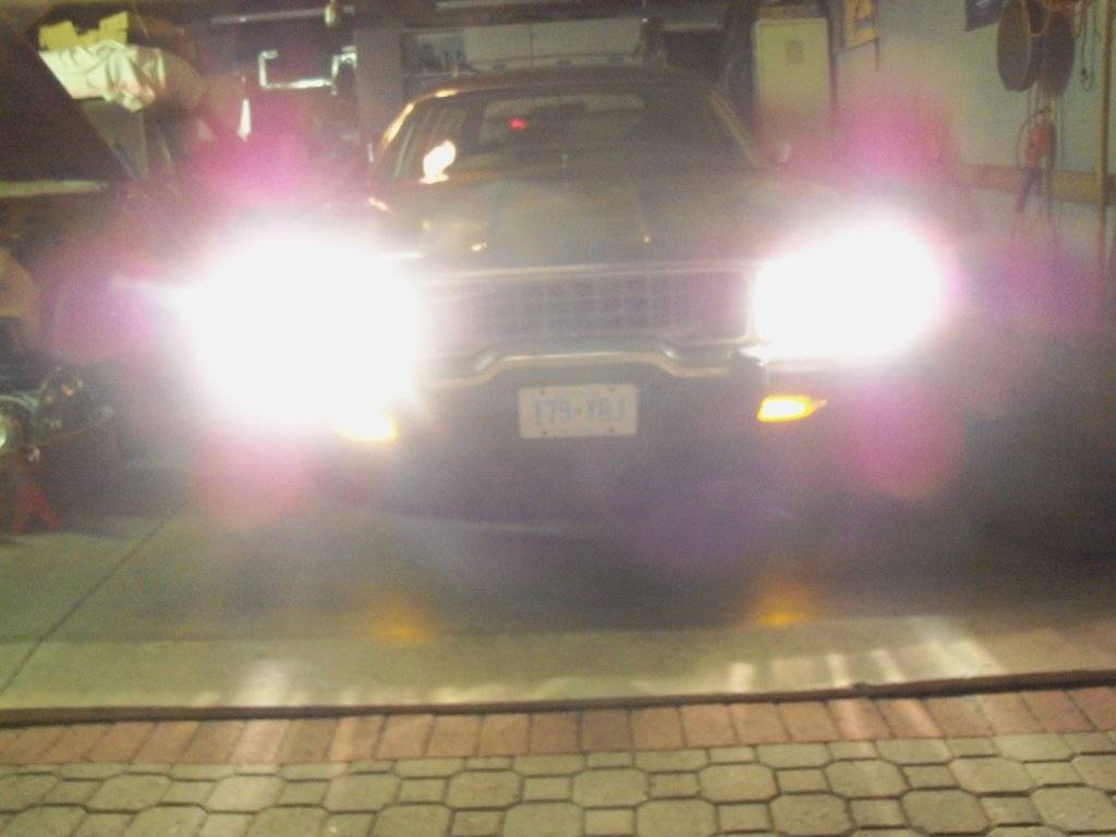

The Waygun has HID's in vintage Carello H4 housings and are the brightest but has a shorter throw.
In other words,I tried all different ways and bottom line is what I am running in the BoaB I like the best.
Looks stock too!

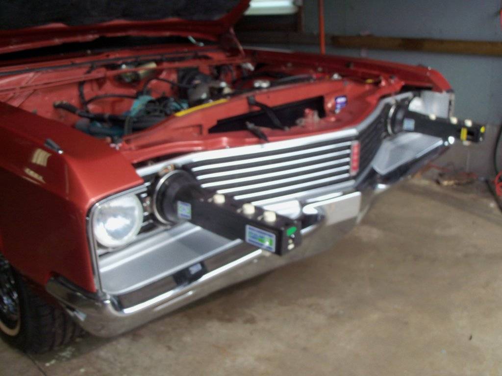

Regardless of what lighting you choose,alignment is very important for optimum headlight performance.

At least with the Hella's the bulbs are readily available compared to the sealed beams which are becoming harder to get.
HID's are PITA and when a bulb goes out you need to make sure it is a bulb or ballast or both and not cheap to replace and not readily available especially when you are travelling.
Looks stock too!

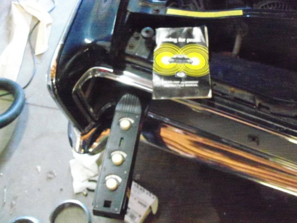

View attachment 240196 View attachment 240196
Where did you get those headlight aimers?
Bought them through my local parts store that was sitting on the shelf for years.Old stock never used til I bought them. Old school technology that has no demand in today's broad market. 150 bux!!
