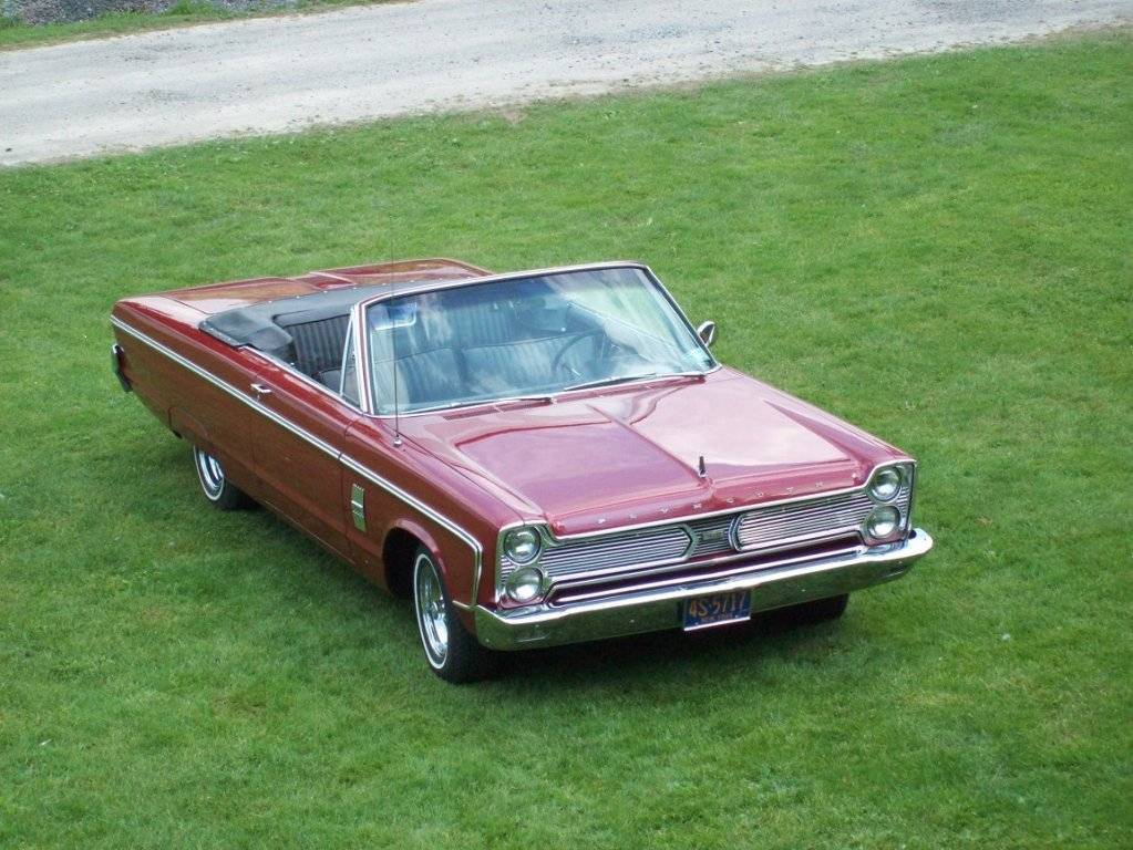

Thinking of taking the Cragar SS wheels off my car and going with stock wheel covers. Just want to change the look, the Cragars have been on the car since the beginning of time. Would the wheels be painted black or would they be body color? Appreciate any input, thanks
Stock with full wheel covers would be black painted steel rims. They should be body color only if you use dog dish caps.

If you end up using the optional turbine style wheel covers that were available in 66, test fit them to make sure your steel rims are deep enough before you mount the tires.

There was one circumstance where the wheel was white regardless of the body color.
I can't recall which but anybody else?
