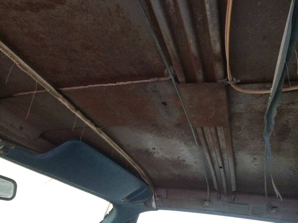

Here is a photo of the optional roof support.
CHP cars didn't get these because the CHP cars did not have roof mounted lights, and aparently the CHP didn't want the extra weight.
