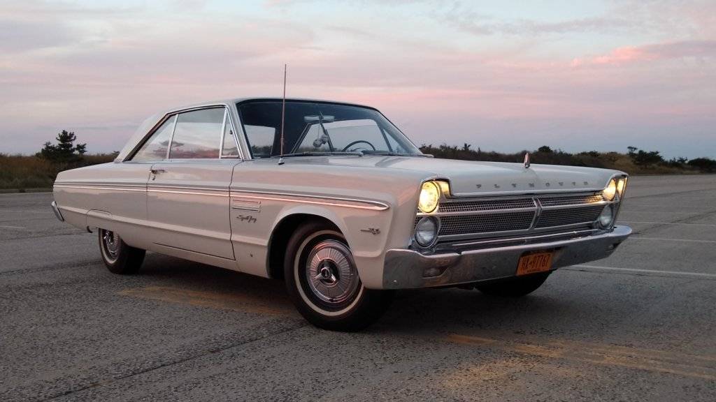

Jeeze man .. go easy. Has nothing to do with my age of 50...and as I said I'm keeping my original SF wheels to swap out when I want. I own the car and enjoy every aspect of it. I just happen to like the look of classic Cragars with some meat on them. Doesn't mean I'm ruining the car. I've spent the last 4 months restoring my engine bay BACK to OEM, because the 72 year old previous owner had no clue about the car other than how nice it was. Now the car is back to mostly original, with several needed upgrades and minor mods. I don't think taking a shot at someone's age based on what wheels and tires your running makes sense.
View attachment 343925 (sticker has been moved to proper side location)

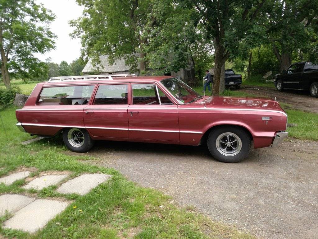

A 275/60/15 will fit on the rear with a 15x8 wheel with 4.5" back space. I had them on my 66 New Yorker with 4" backspace and they cleared the skirts but barely. Lots of room to the spring so 4.5" would give a little more room.
235/70/15 gives a good look with lots of rubber on the road if you don't care for the staggered look. I have them on 15x7 Magnums on our wagon.
Kevin
I'm a big fan of Cragar SS. Not a fan of the unilugs but Cragar does have a forged aluminum wheel that looks identical but is drilled for 4.5 bolt circle.
KevinView attachment 344019
Thanks for the info and advice. I'll look towards that size and go from there. Love the Longroof! My first car was a 73 Ply Fury Custom wagon... banana yellow, and wood paneling... ugly as sin (well, back in 1988 and being 18 yrs old) and still got laid in it. LOL!
