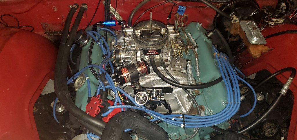

Not here to hijack the thread just wanted to share what I ended up doing to get the pressure down. I bought a Jegs unit with a gauge and plumbed everything using 6an line and fittings. I also used the Edelbrock fuel line and filter although I will probably add a second filter at some point. Initial reaction is the regulator is okay quality but certainly not top of the line. I am impressed with the Evil Energy fuel line and fittings, they went together nicely and no leaks (at least not yet). I adjusted to 5 psi as a baseline.
No test drive until the weather turns but it seems to be working as expected after 10 minutes idling. Still need to tidy things up just wanted to check for leaks before spending time on that.
