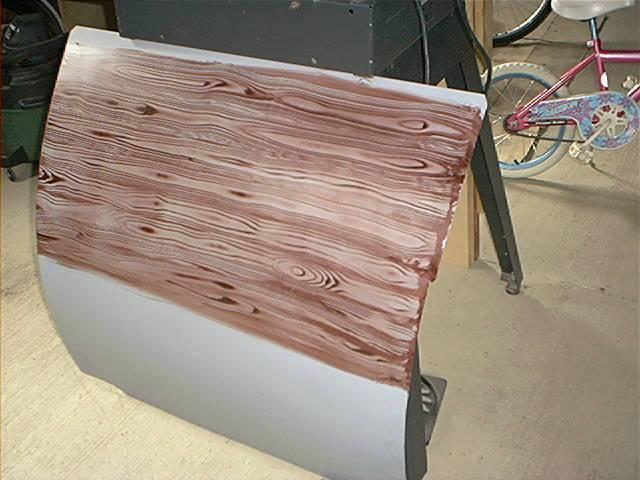

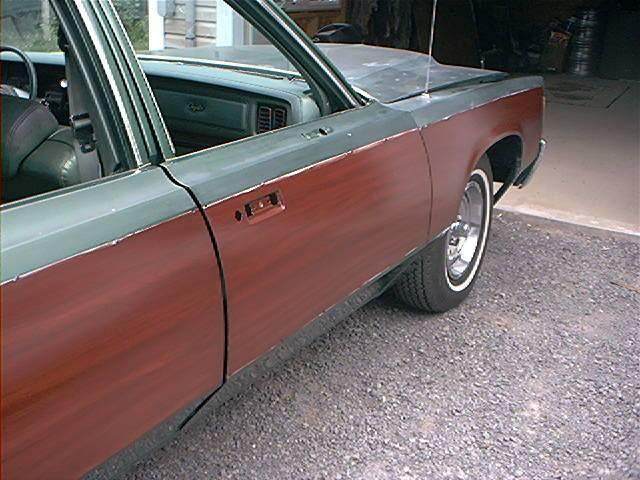

ie. painted woodgrain on my T&C instead of Di Noc. maintains the "right" look (I think these big wagons need woodgrain to look "right"), but no fading/ shrinking/ wrinkling. I converted the Lean Burn, but kept the computer etc there to show what these cars were like from the factory.

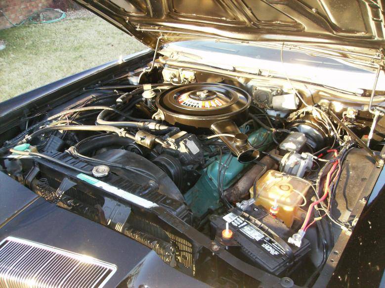

I put 440 four barrell decals on fridge magnets for the air cleaners on my Imperials...I can have them or remove them at will, depending on my whim. I replaced the power antennas with manual telescoping antennas so that I will have the uselullness of telescoping antenna (car covers, car washes) while never needing to periodically replace/ service the power antennas that always seem to give you grief.
How in the world did you find someone to simulate the wood? Beautiful job!

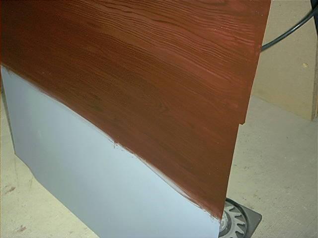

I did it myself. First I found a "stain" that is used on steel security doors. Then I practiced on a piece of sheet metal stock bowed to simulate the car's side contour. Once I had the techniques down, I moved to the car.
Holy shizzle! My hats off to you, nice job! Some deep talent on this slice of the web...
Great. I knew about the existence of such a wood grain painting technique, an older paint guy showed me the results of such brushing technique once, they learned this during apprenticeship.
Did you brush this and sand, clearcoat and buff it, or airbrush it ?

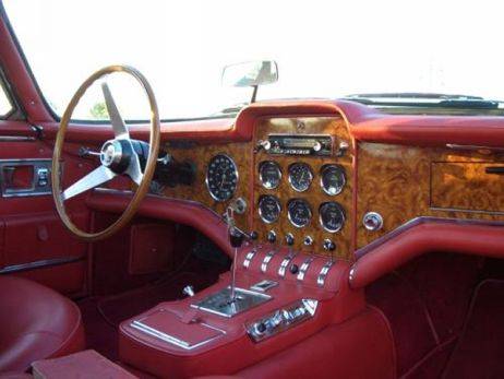

Some of the french Mopar-powered Facel Vegas had the dashboard done that way.

I used a brush technique, then clear coat. I did not buff because leaving the clear coat a little orange peely created a satin look that the woodgrain cars had when they were new.
