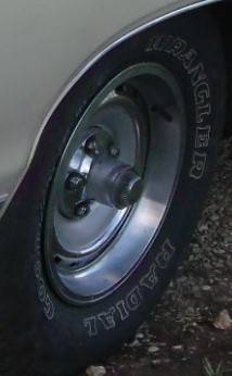

y would anyone would put those wheels on a older car anyway the car needs to be built for them . my advise to u is to got back to to stock sie either 14"-15" & if u cant find the stock road /rally wheels get a good chromed spoked wheel like a Cragar SS wheel/rocket wheel . thas my advise to u ,but u doas u like/wantI have a 68 fury III 4dr it had 20in wheels on it no junkyards really around here no wheels I have jeep grand Cherokee wheels on it now tire is hitting upper control arm please help any suggestions would help
the problem with r=the newer wheels the offset is all wrong for the older cars it throws the wheel all the way inside . the only way to fix it & still use te 17" wheels is to get wheel offsetsI think the bolt pattern for Jeep Grand Cherokees was 5x4.5 until the 1999 model year, when they went to a 5x5 pattern. No idea on the offset, though.
get road rallies from a 93 truck or earlier they should bolt upThe Jeep wheels are a different offset. They will not look right. Stick with 15X7 wheels from an M Body. The original M Bodys came with either P205/75R15 or P215/70R15. Considering the Fury is bigger I'd go with P225/70R15.
1/2 ton 2 wheel drive the 4x4 has te same bolt pattern but te center caps r bigger if u can find Cordova wheels they r very close to the same look as theseOk sounds great I’m new to this cbody what kind of 93 truck etc
but many of these was used on demo cars & was crushed i cry when i seen guys demo c bodies1/2 ton 2 wheel drive the 4x4 has te same bolt pattern but te center caps r bigger if u can find Cordova wheels they r very close to the same look as these
u may be better to get a aftermarket wheel it may be cheaper check swap meets thats where i found mine (& it was a gm/ford swap meet too!) he didn't know what he had i PAIDED $300 a set of 4 mine was on a truckbut many of these was used on demo cars & was crushed i cry when i seen guys demo c bodies
there was a spoked wheel too' i think they r remaking them & the trim rings'u may be better to get a aftermarket wheel it may be cheaper check swap meets thats where i found mine (& it was a gm/ford swap meet too!) he didn't know what he had i PAIDED $300 a set of 4 mine was on a truck
the wheel was standard on trailer tows as they was widerthere was a spoked wheel too' i think they r remaking them & the trim rings'
