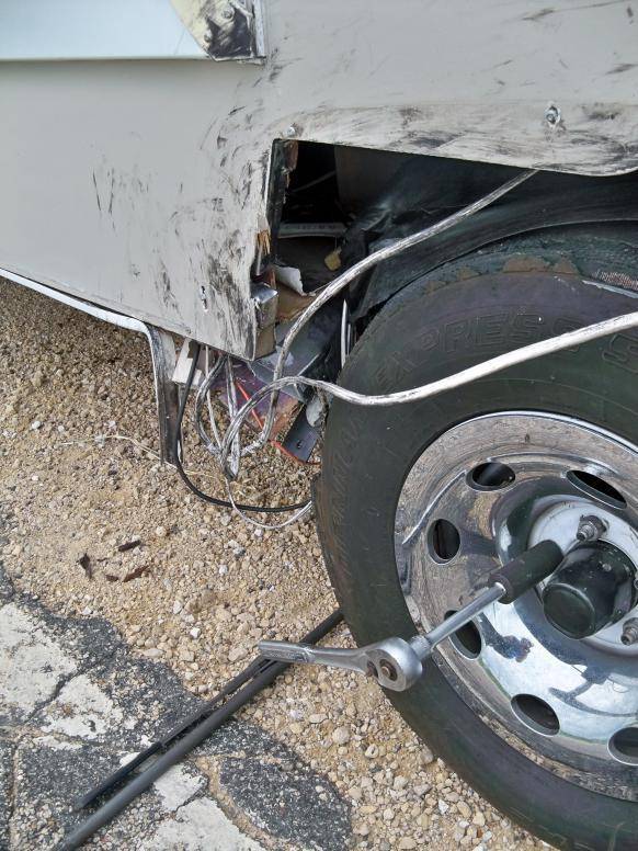

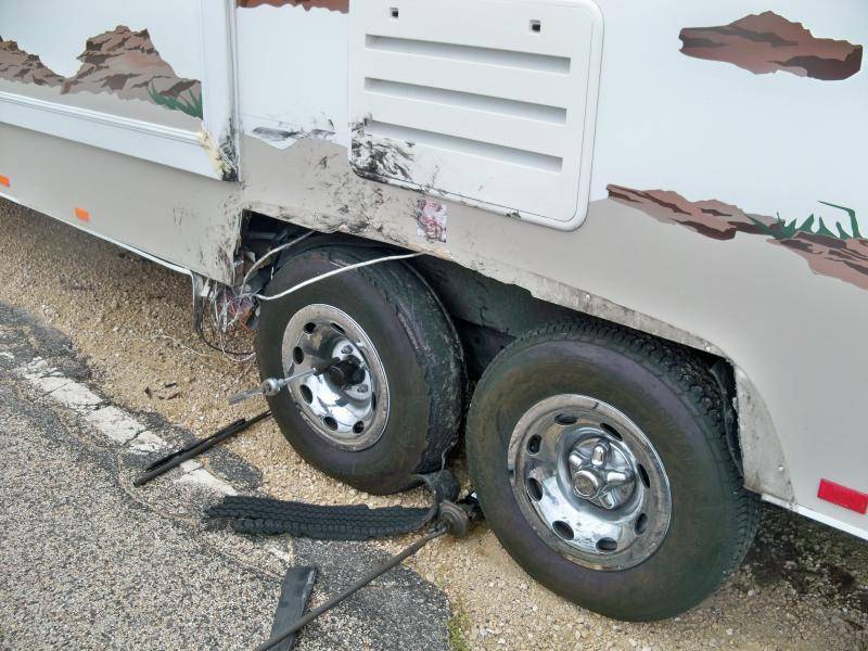

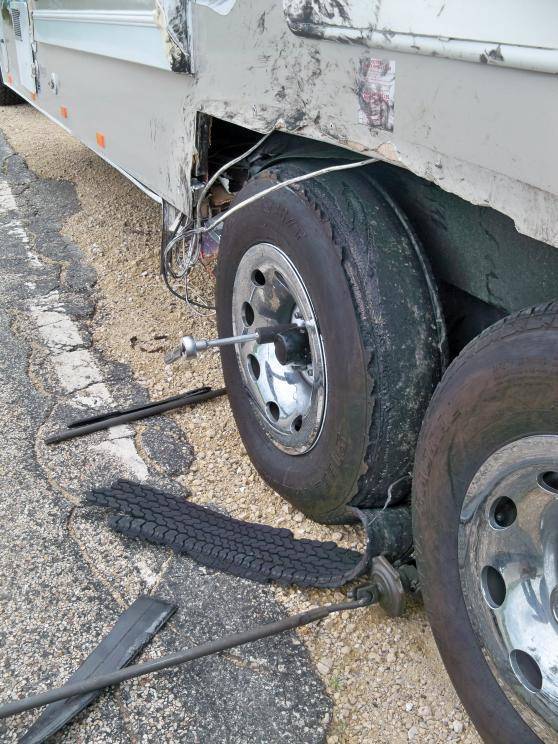

When a tread comes loose on a camping trip!
jake
Oct 23, 2012
1,540
1,085
wisconsin
At least it happened on the way home.
That blows big time! How old are the tires?
What a major bummer, dude. My brother's had a couple tire issues on his trailer(s). And I've had two rear blowouts on my truck camper (single rear wheels). It's not a fun experience...
I learned a long time ago not to use tires designed spicificly for trailers. I've never worn one out because they always seem to just blow apart before 10K miles. Good quality 8 or 10 ply truck tires are best.
Kinda where I am at for this years camping season. I have run E load range trailer tires for the last three years and I tear up at least two tires every trip. This year I am going with LT truck tires. The load rating is 3450 pounds versus the 2830 max on the E load trailer tires.
