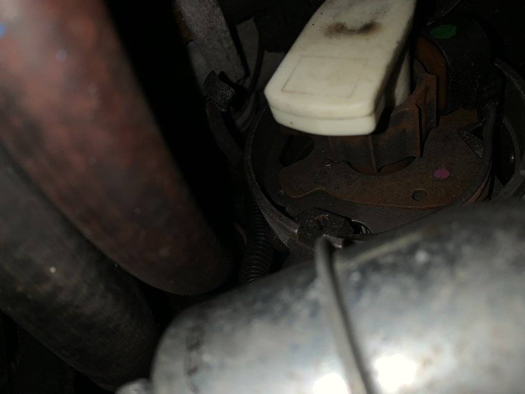

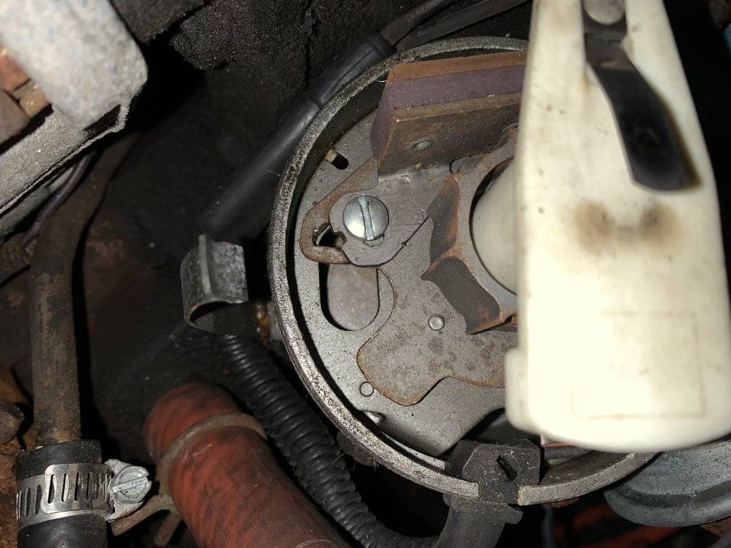

Haven't run it again yet but I pulled the cap, nothing unusual inside the cap. I did notice that the weights inside appear to be stuck in place, would it be that way if I have the non-points electronic ignition (the one on the firewall)?

Points or no, advance weights should be MOBILE! They're held in place by little springs which stretch as the engine's angular acceleration ("rpms") increases. If indeed the mech advance is STUCK, you will have sub-optimal ignition performance. Clean the distributor, thoroughly or replace it.
Hmm, interesting. Do the advance weights only come into play at certain speeds?
Is there any way to free them up?
