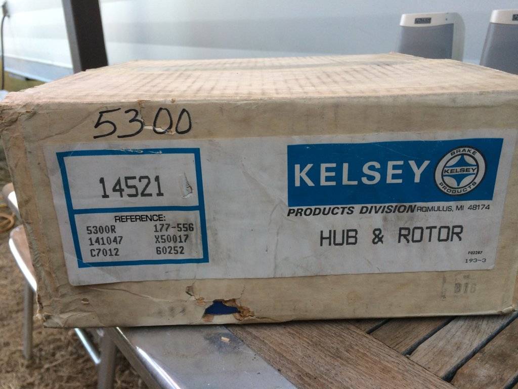

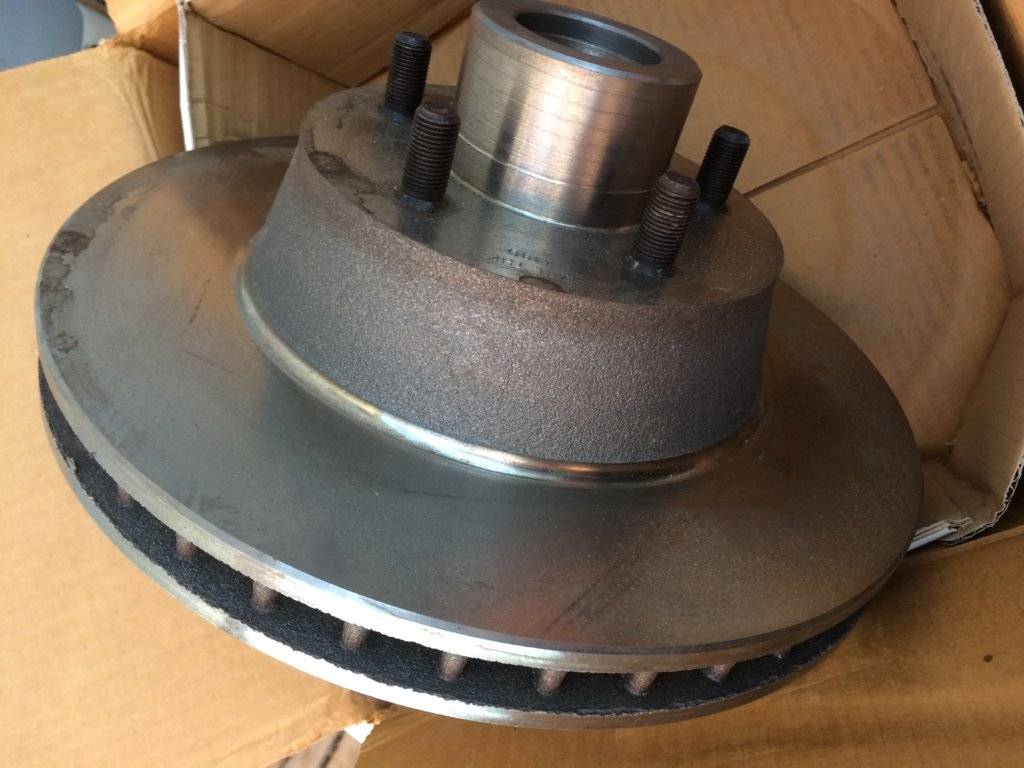

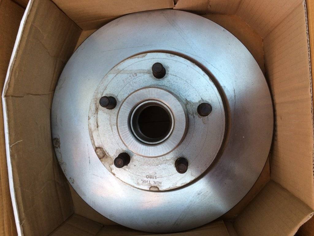

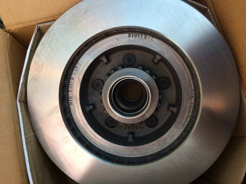

Hi Steve, et.al., I got these years ago. I know they are a “one piece” hub/rotor, and not per factory. I was told the application was 69-72 Chrysler/Plymouth/Dodge disc brake all application. But I’m not 100% on that.
Is this what you are looking for?
View attachment 252864 View attachment 252865 View attachment 252866 View attachment 252867 Hi Steve, et.al., I got these years ago. I know they are a “one piece” hub/rotor, and not per factory. I was told the application was 69-72 Chrysler/Plymouth/Dodge disc brake all application. But I’m not 100% on that.
Yes, that is the general rotor that my friends are looking for Trev. I did some more investigation into the options on the Rock Auto website and found that as discussed above the Raybestos 7018 should not be an option there for 1969 - 1972 early cars, and the 7012R one is N/A, but I also looked up on the AC Delco website and found that the one listed on Rock Auto is also probably wrong since AC Delco says the rotor shown is for 1971 -1973 Chryslers and for other 73 and up Chrysler products. So they have it wrong too. And Wagner's website shows a 2 piece available, but when I called Wagner, they said it is discontinued. So I suspect you will not be able to find two piece rotors any more that are new unless they are NOS ones.
