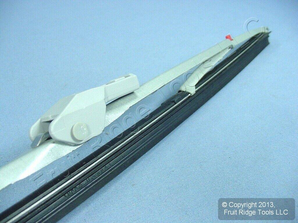

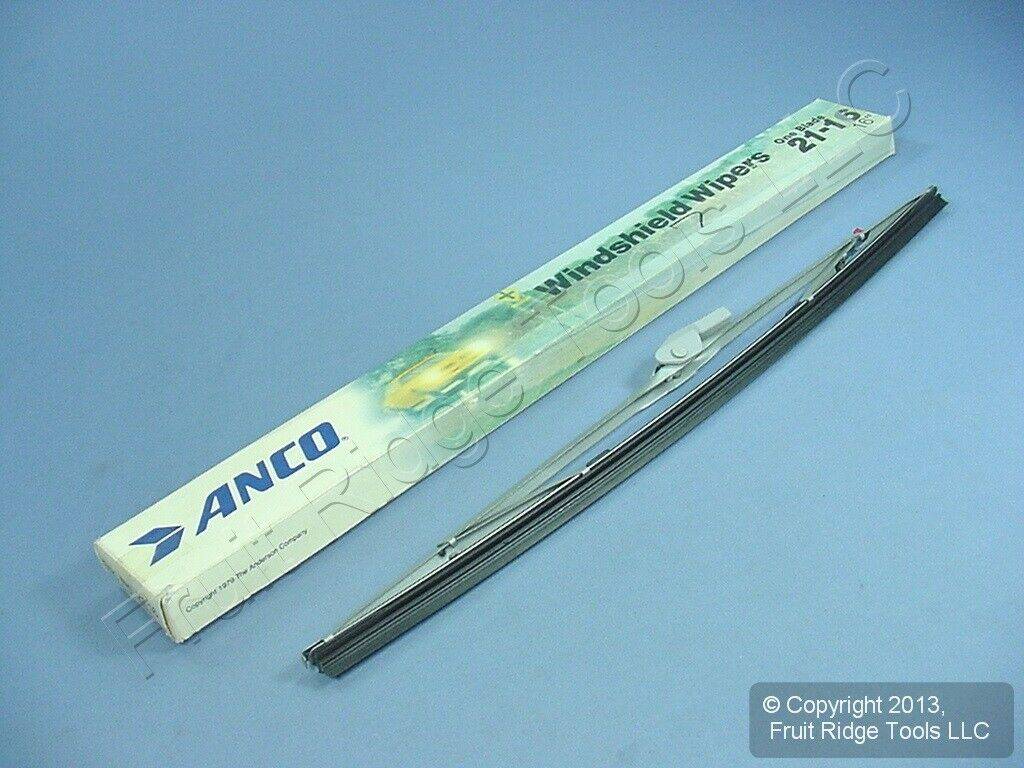

I think these are Anco
U16R
19-16

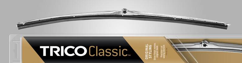

and these are Trico
43-160
44-160

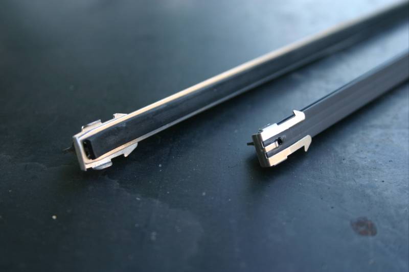

I'm sure a lot of store have them IF you know the number or are willing to sort through a pile of different ones of the correct length. They have no way of looking them up!
I went to O'Reilly and they had the 44-160 and not the 43-160 (Trico)
I went to Car Quest next and they had a 453-160 that was correct as well, their other number was 454-160

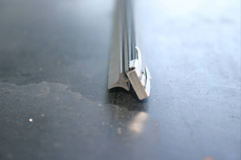

The 43-160 is the correct vintage style with the metal frame. The 44-160 will work but has an integral plastic frame, otherwise the same.
453-160 on the left, 44-160 on the right.
Close up of the Car Quest 453-160
Close up of the Trico 44-160
Both have been tested and work.
I have not located the other two numbers but in time I would like to see if they will work.
So the list that is good
Correct metal frame style
Trico 43-160
CarQuest 453-160
Functioning substitutes
Trico 44-160
CarQuest 454-160

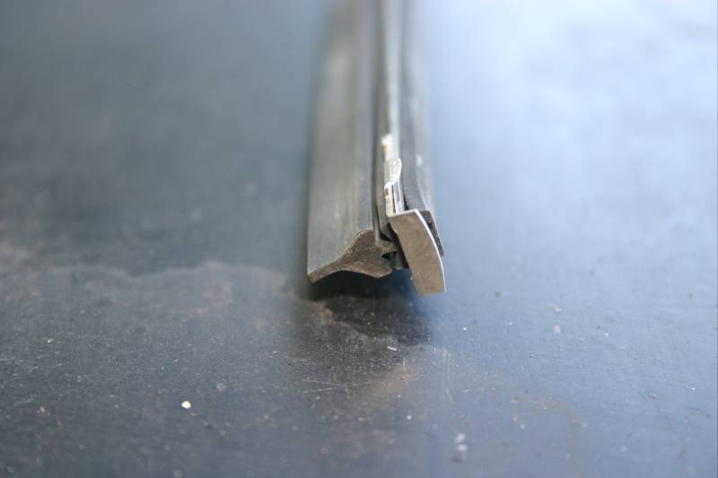

Wiper blade REFILL source?

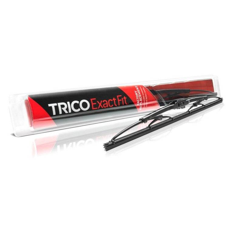

The cheap Trico's all the way on the right. Red and black package. You can open the package without destroying it. You can even take one out to your car to fit it before paying for it. Just tell them what your dilemma with fitting. They would rather you test it first so they don't have to sell it to you and then return it 5 minutes later. They will even put it on for you if you trust them. Lol.
