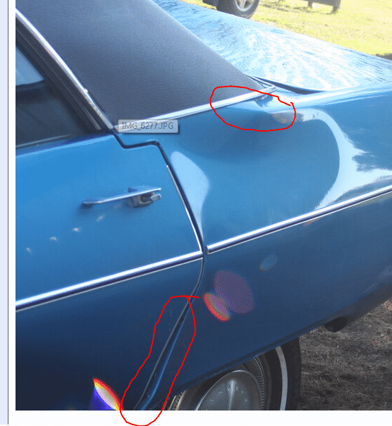

I worked at a bodyshop years ago that did a lot of heavy pulls like this one and a lot of restoration work. I am not an expert, but I think the doorgap and this heavy crease on hte driverside are the coffin-nail. The passenger side isn't just moved forward, the rear of the car has twisted CCW also.
Let's guess this car will need $3000 to be pulled sufficiently, metal removed/replaced, and ready for paint again. (and I think that's low for all the pulling + R&R of 2 quarterpanels and a framerail).
Add $3000 for a basic paintjob, then.
Sum total for this 318 Fury 4-door comes in at $9350, and it's no longer a creampuff, it's a car that has been hit HARD - with no guarantee that there won't be some integrity issues afterward (leaks, door alignment, suspension alignment).

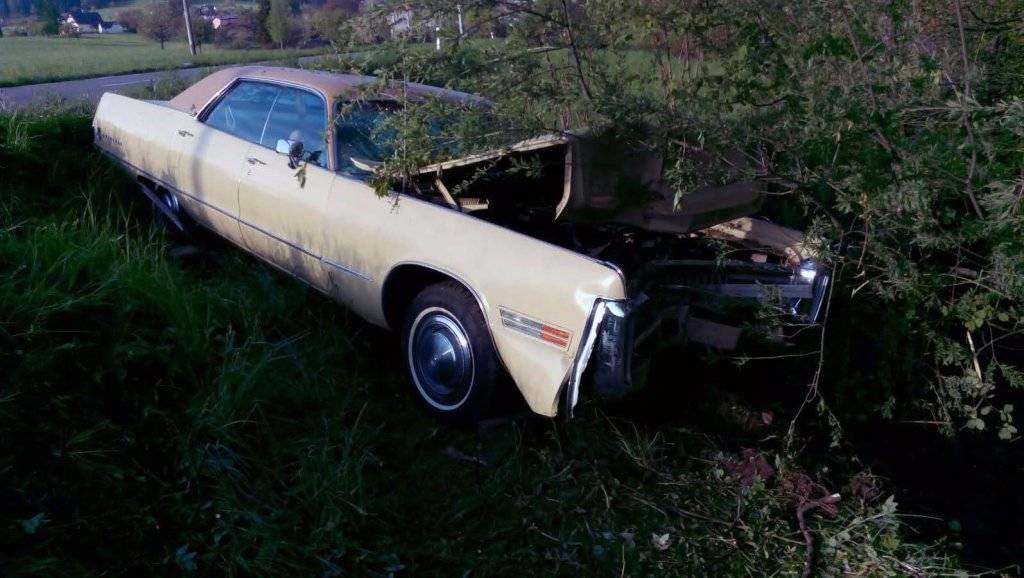

How many miles are showing on the odometer? It must have been stored indoors for a very long time and have low miles to look that clean inside.

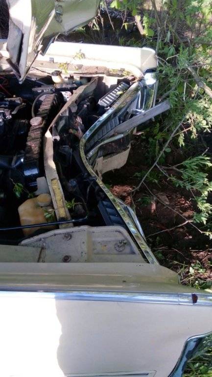

From my experience with my 1973 Imperial donor car that hit a tree before I bought it, I can tell you that everything is bent and buckled on this car. Not only the parts you see.
On my donor, almost every sheet metal piece was more or less distorted in some way. Even the trunk pan was bent a little.
So just consider, it will never be a nice car again, even if you fix all the panels hit in the accident.
Makes sense. There's the part of the car that impacts a stationary object, then the rest of the car impacts itself.

No surprise that there is nothing left of the tree after getting an Imperial in the trunk. That looked like a nice condition Imperial
The condition was amazing! No rust on the entire car. I removed a lot of very nice parts from this car.
It was a real bummer it crashed but good for me in the end.
How did they manage so hit on dead center? It's a flawless execution of hitting a tree. And the angle to the road? Is that the crash site? That's a sharp angle to leave the road.
