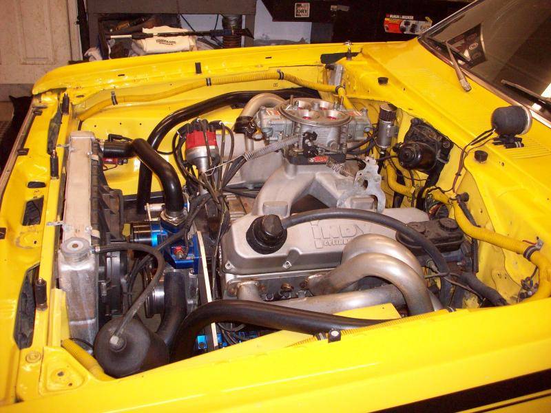

I have a couple 440's laying around, believe me I have thought about it. The RB is a damn tight fit. I think the heater blower fan has to moved a tad or else you can't even get the valve cover off. And unless you just use HP iron manifolds, fender well headers I think are the only headers you can get in there and then you have to butcher up the "inner fender". With stroked small blocks putting down such impressive numbers, other than cost I don't see much benefit to big blocking this car.
just do the big block. who really gives a **** if you cut the inner fenders. the worst is it could look like this. if it aint a trailer queen than who cares. there is no replacement for displacement.[ my small a body 73 duster]. especially if you have some 440's kicking around.
Use the manual box not any worse than a smallblock with a/c and all cast iron manifolds the fenderwell headers have a cool visual at shows but tti's can be had for not much more. I have fenderwells in mine they are like 25 years old when it was the only choice
