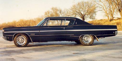

Here's a '68 that I had many moons ago...
