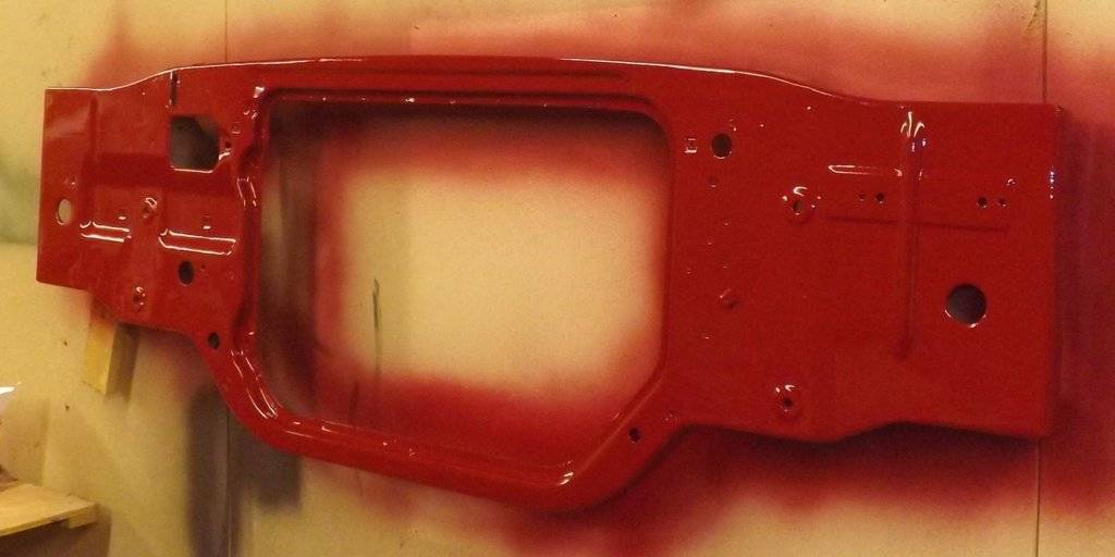

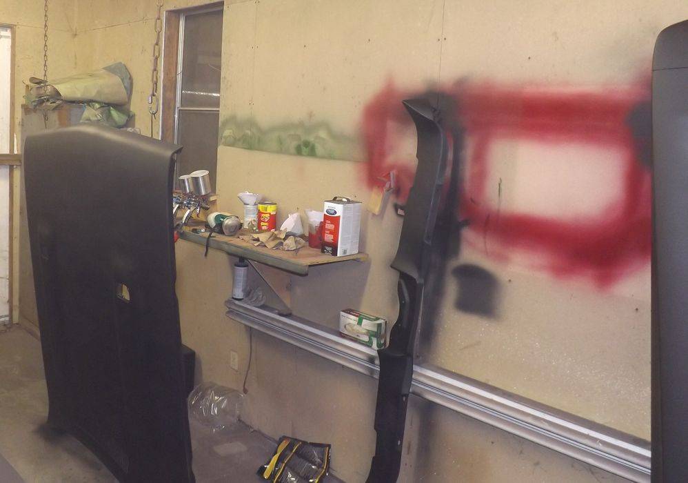

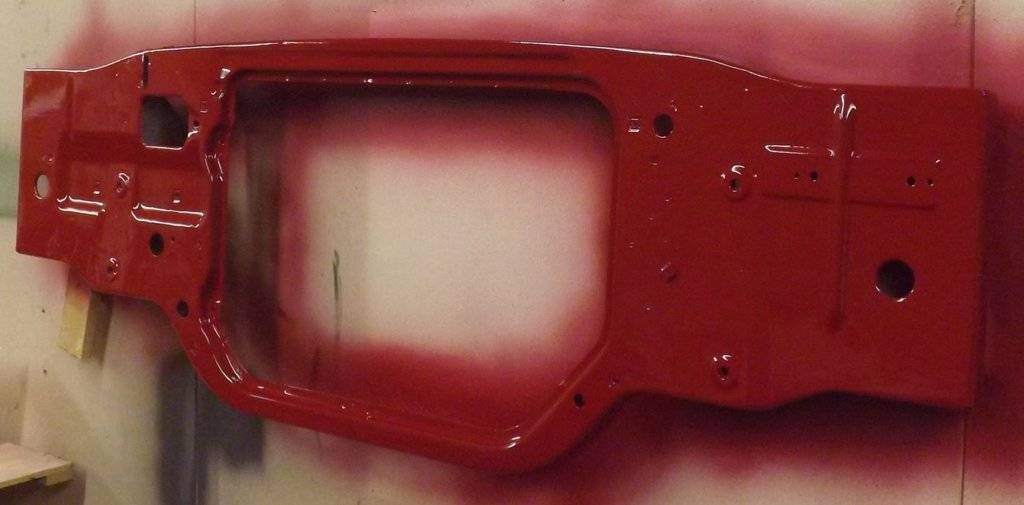

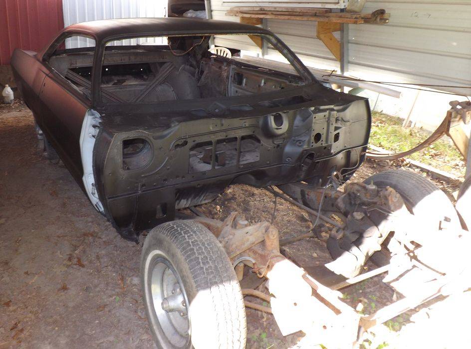

Lastly a little bit of a surprise. I mentioned earlier I would have something to ad regarding the radiator support. Well, here it is, primed then painted in the final color of the car. Looks pretty good. I put up two pics of it painted, the first one is of it without the flash of the camera and probably a better representation of the final color and then the second pic is of it with the flash of the camera. Just for comparison.

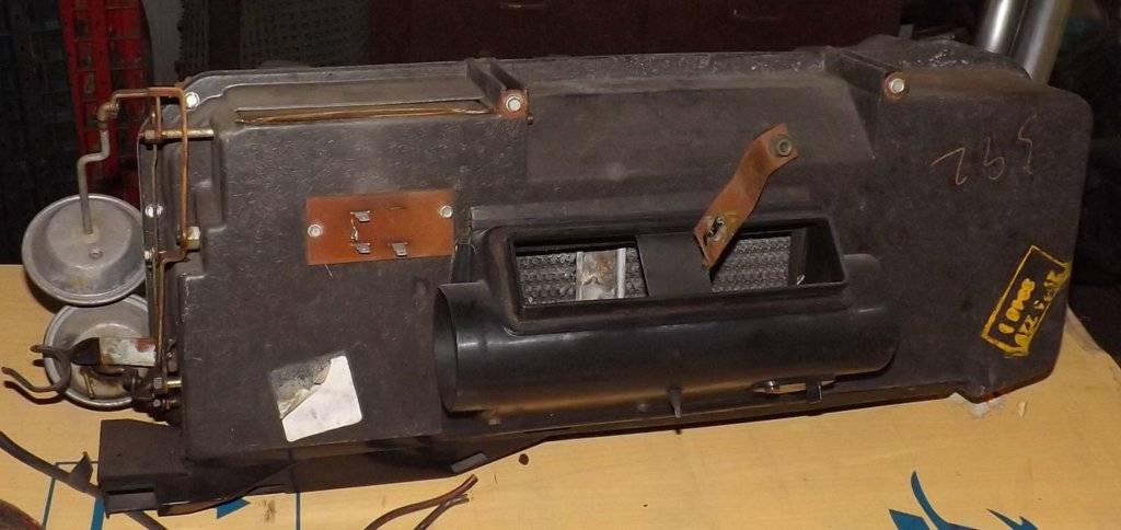

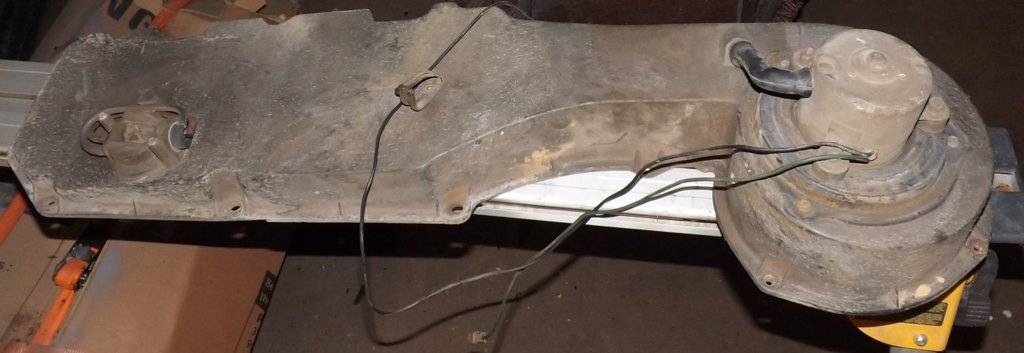

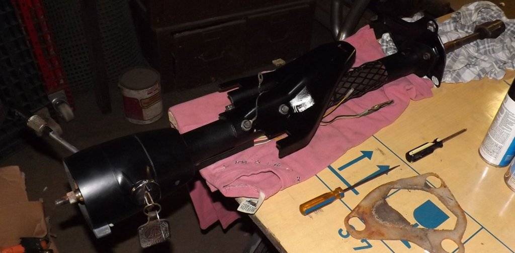

Okay, so I disassembled the column and put it back together again correctly. Here it is, now put into storage too, covered up for when the car is ready for it. Then I puled out the 5 AC boxes I had and picked out a suitable unit which I tested with air pressure as well as hot water. This one passes the test and i will be using it. I will check each of the vacuum canisters too and repair whatever is necessary.

I’m in the middle of the ac box rebuild as well. Not sure if you are going to crack open that box since it looks clean, but I just picked up the DMT rebuild kit and it looks pretty complete.
Normally I would pull it apart but as you say, it looks clean, and it does. I am going to clean it up a little and make sure everything works then simply put it aside for when I'm ready to fit it.
I am curious to see pics of the DMT kit though, are there pics on a website of the kit in question?

What??? It's not green, we all know how you love green:poke:
Dmt kit is actully pretty good...just did mine...fast shippin....Lazer cut in foam with labeling.....have pics at home but not on phone ...appoligies...good kit though
Imo most foam in the unit will be toast...good opp to change and blow crap out ect...is cpl oem holes in system that can be sealed up for better flow as well.....

Scorch Red, baby! Something is definitely happening.

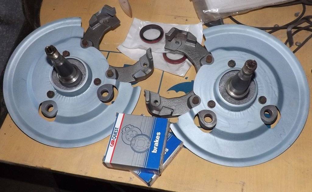

Got some disk brake work done, last of the new parts arrived today so this will be finished very soon. Suspension parts are all painted.

Rotors are cleaned up and ready to fit, will put new seals in the rear and repack the bearings with grease before assembling. They are very nice original units.

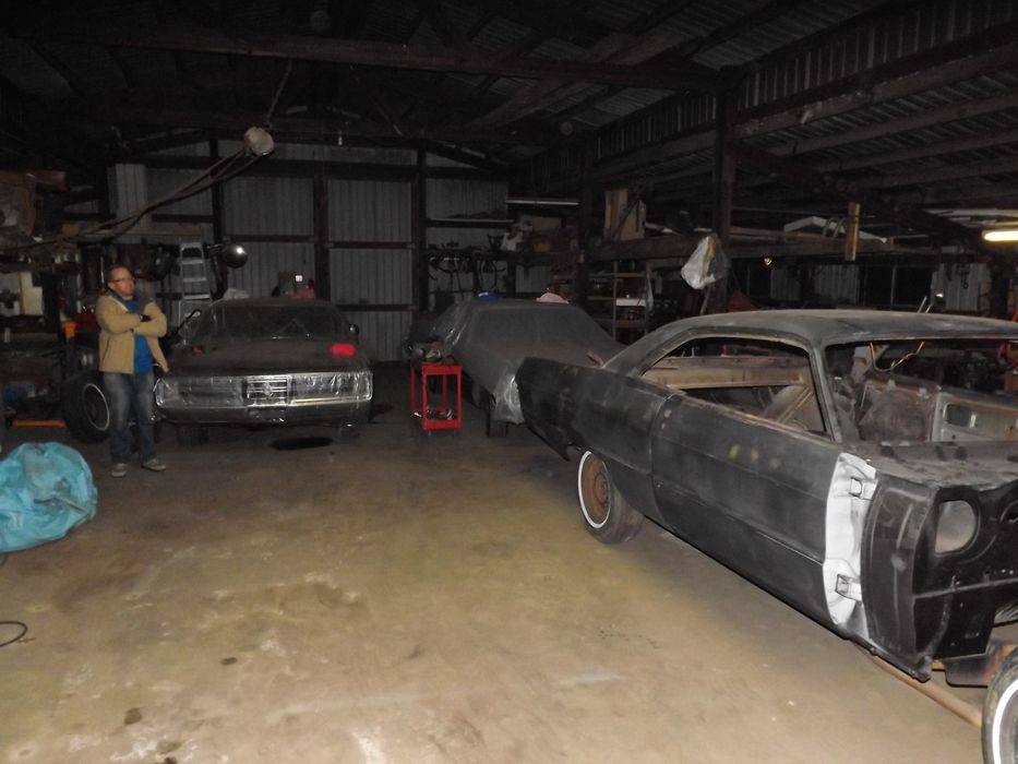

Aidan helped me play musical chairs, I mean cars and the S23 is now in the main workshop. Winter will be slow so I will tinker on smaller stuff on it for now.
