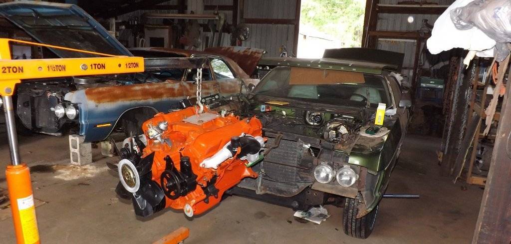

A major milestone today, that chassis is in and I have started connecting everything up. Also put new feet on her today, yes! Guess what goes in next?
Yeah! Looking good, now it's going to be a race to see whose car is done first yours or Critters
Critters man is working fast, I expect another four weeks on my end. Can Paul have Dereck's car done in that time?
We're pushing a deadline...have to reapply 20th may for couple weeks extension to finalize car..customs and transport...l envy Garry as he has none of this to deal with....in the end it's not a matter of who finishs first as both builds were diffrent...
What realy matters is 4 x71 GTS hit the road this summer along with the 70 ..6 bbl gt...can only be good for C Bodys ect and recondition of the cars themselfs
Gona be a banner year for our cars this year...gona be the year of the boat
