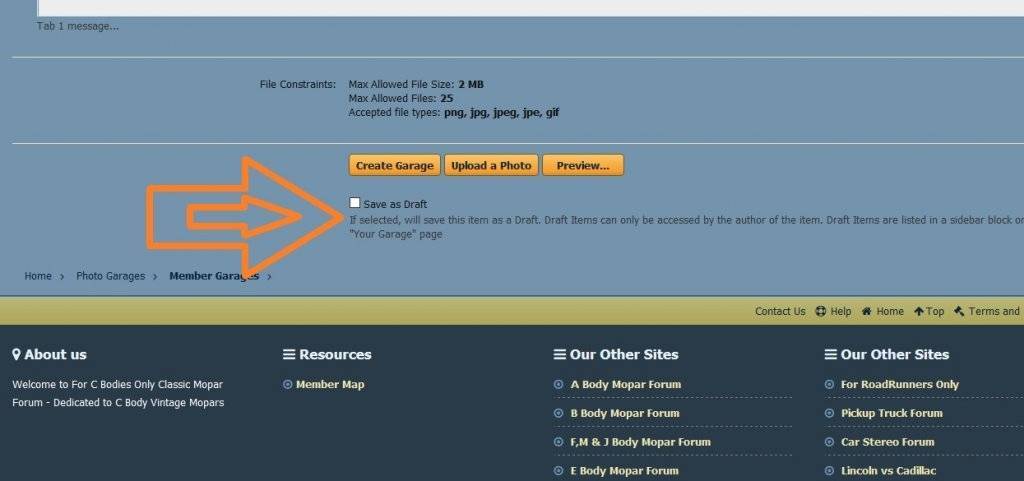

I could have sworn I saw something with your name appear when my cursor moved over the little red box with numbers in it next to Photo Garages, but I can't duplicate it now and this *!#$%*! crappy software won't show me what you posted.
Did you "save" it while you were building it and not actually "submit" it? That's pretty easy to do from my limited experience.
Joey said he can't see it either, but I can, so I don't know what is going on.
I suspect that may be the case. You may have clicked the save as draft button, so it's only visible to you.
I didn't click the draft square no, let me look again. How do you submit it, I clicked the Create Garage button.
Okay I'm forwarding this onto Joey, I looked down the bottom and it had this,
Item Status:
Awaiting moderation before being displayed publicly.
Alright just got a msg back saying it should be fixed now. Please try it people and let me know, cheers.
