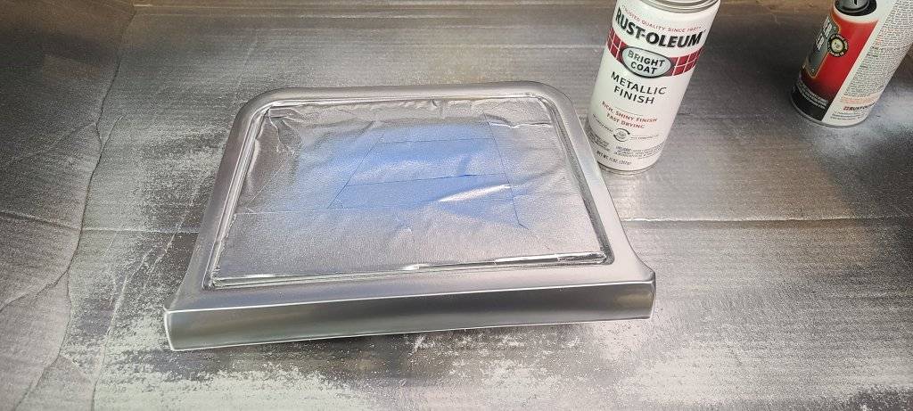

I used "chrome" paint on my arn rest bases and was pleased with the result. Now, some years later, I'm thinking of re-doing the same and adding a topcoat of clear. My 5cents. (In Canada we lost our pennies and now have to use nickles! LOL) Lindsay
FWIW, I did spray them with Rust-o-leum clear after they were painted.

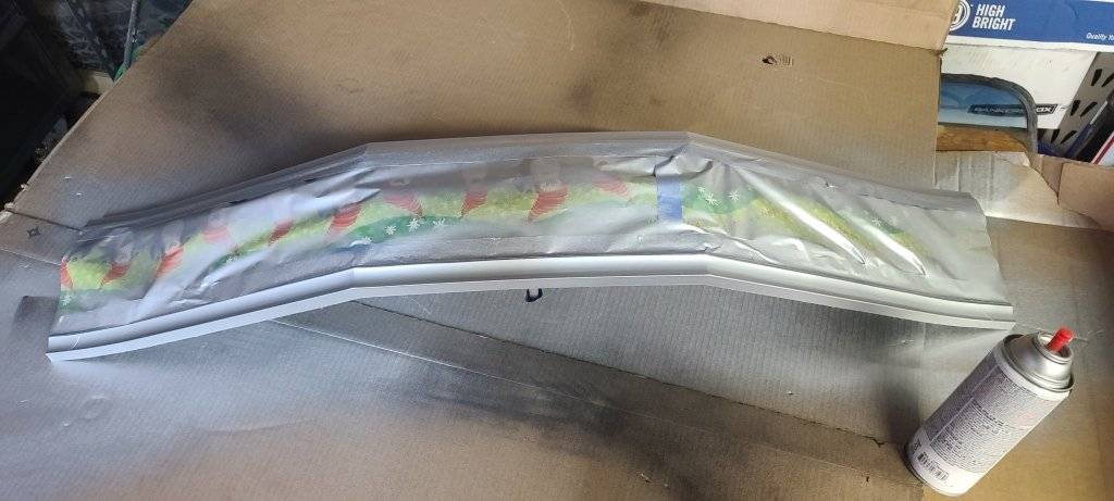

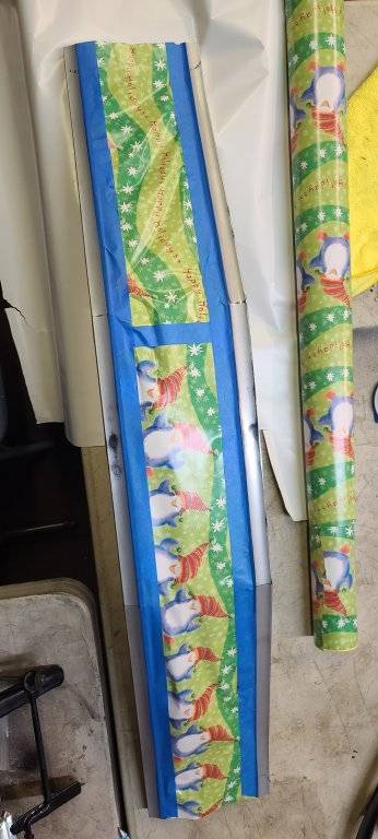

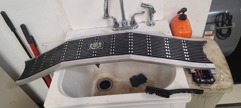

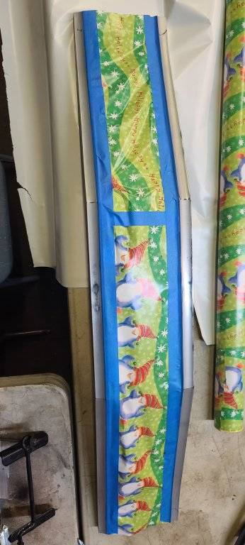

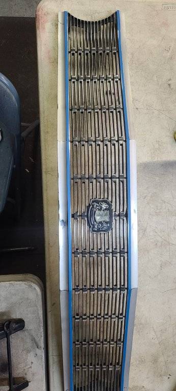

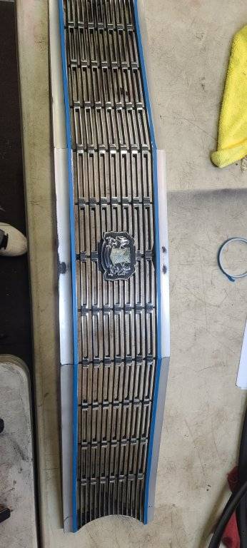

I was looking at the front of the car and didn't like how the argent paint was looking, so it was time to take it off and do a quick touch up.
After removing it, laying it face down on the table I sprayed the back with some black paint to bring out the color when looking at it from the front. Then after taping off the front of the grill and scuffing up the exposed area to be painted, it got sprayed with VHT dull aluminum, which was the same color used for the bumper surrounds.
I put this back on tomorrow after it cures overnight.

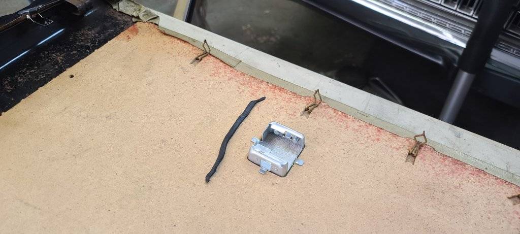

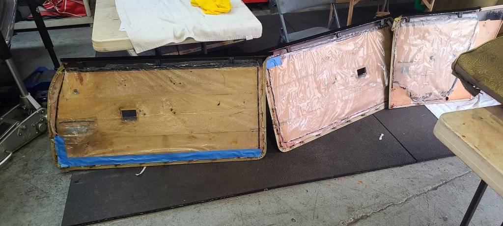

Working on the door panels and seats today before they go back in the car.

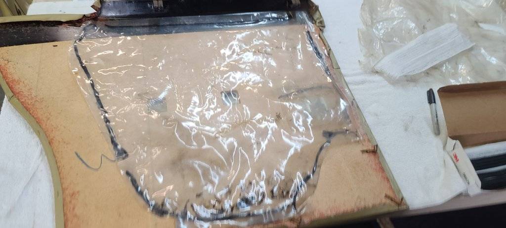

Finished up putting the cat whiskers on the rear door panels and secured the inner plastic sheeting with 3M strip calk.

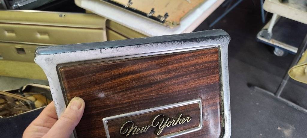

Cleaning the seats with some upholstery today with a good washing. While I was at it, the bezel got cleaned up too.

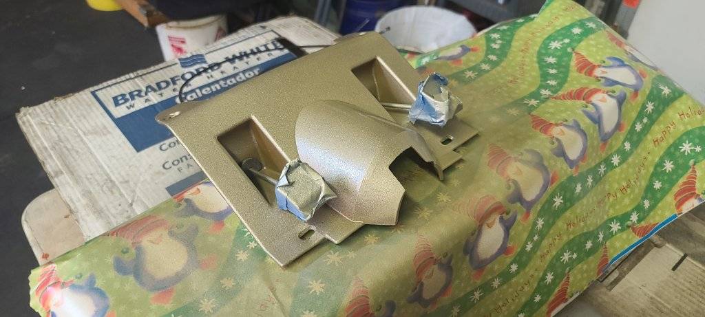

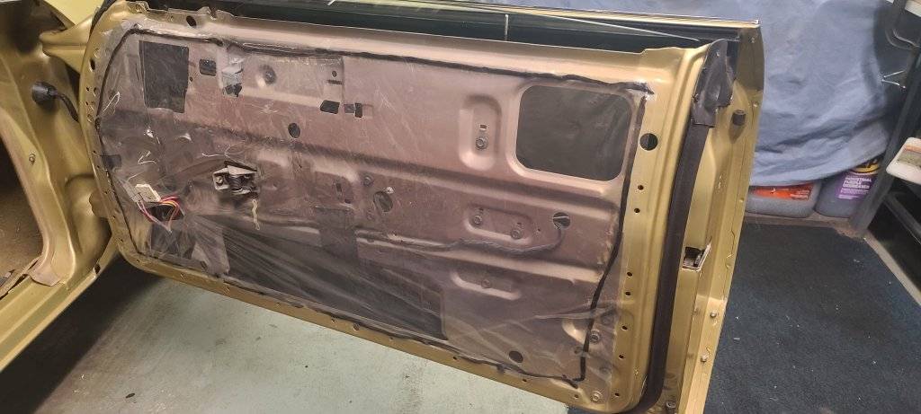

Was able to upgrade the air manual vent cover with one that Wyatt had found for me at Mopar City. Also cut some new plastic for the doors and rear inner quarters.
