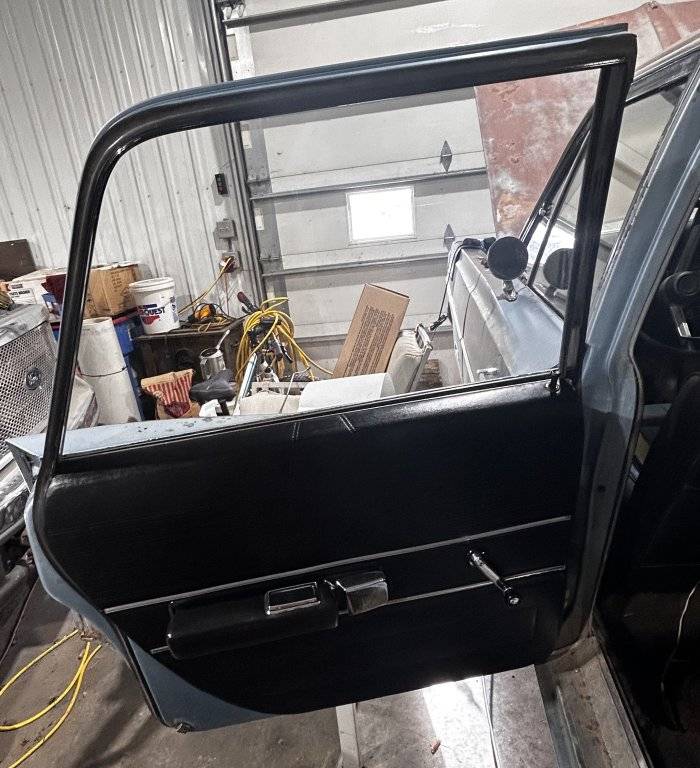

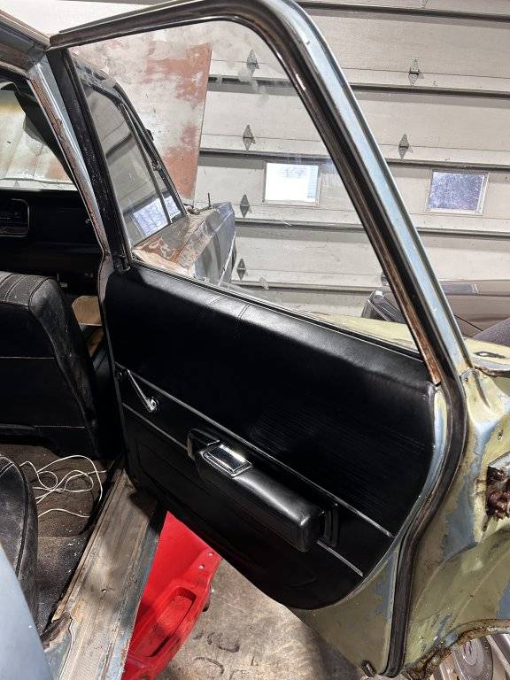

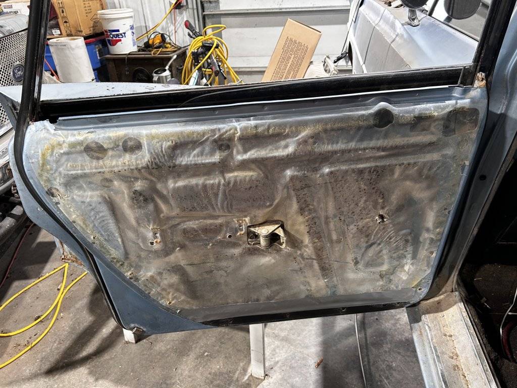

Door panel back on with associated hardware:

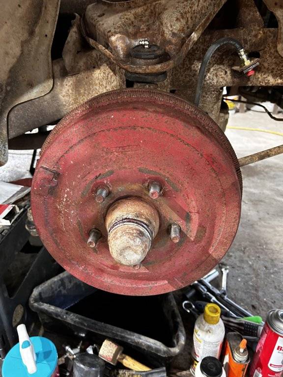

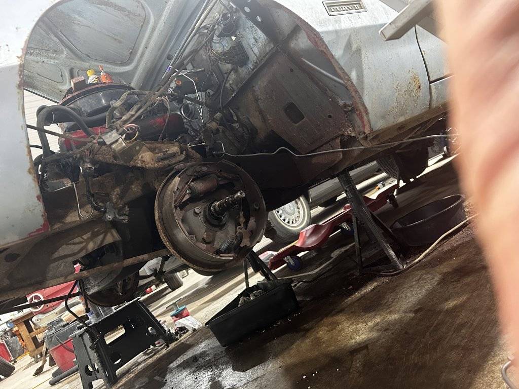

I got the passenger side rear brake put together.
I need to get a parking brake cable that goes inside the drum, as the one for that wheel broke upon reinstalling. I used one from the passenger side front, as they are the same.
I also need to get the drums resurfaced. The drums don’t look too bad, but I want to have them run on the brake lathe.

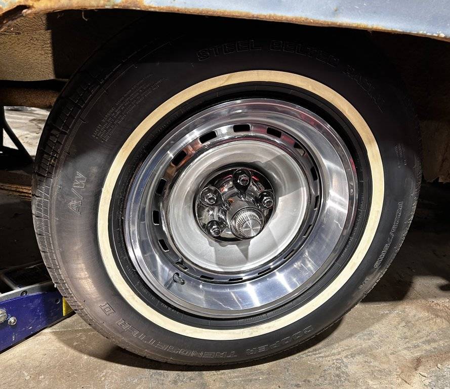

I had all 4 drums turned and picked up a set of the automatic brake adjustment cables. Put the passenger side rear together, adjusted the brake to just rubbing and mounted the wheel with an AMC center cap, with the decal removed.
I also ordered the front hub inner seal and I should have that tomorrow.

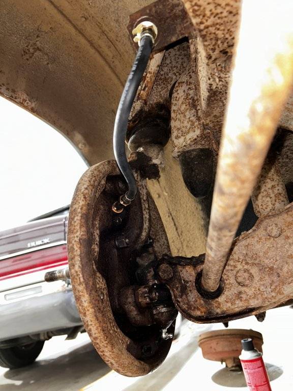

I got the passenger side front wheel cylinder installed and the flex hose that I got as part of a complete brake line set.
I had to loosen the brake backing plate bolts (4 of them - 2 of them had cotter keys and were very tight) to remove the wheel cylinder. Anyhow, it’s ready for reassembly.

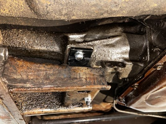

I pulled out the driveshaft, and the rear transmission seal. Dropped the driveshaft off to get new ujoints and balanced, picked up a new rear transmission seal and installed a new front passenger side shock. I used zip ties to keep the shock compressed, so I could install it. It made installation of the shock a piece of cake!

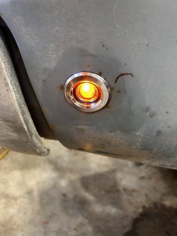

I also received a new to me set of side marker light assemblies and the masticated rubber splash shields.
I got the passenger side front brakes assembled.

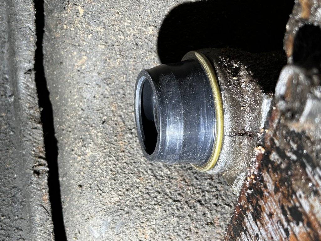

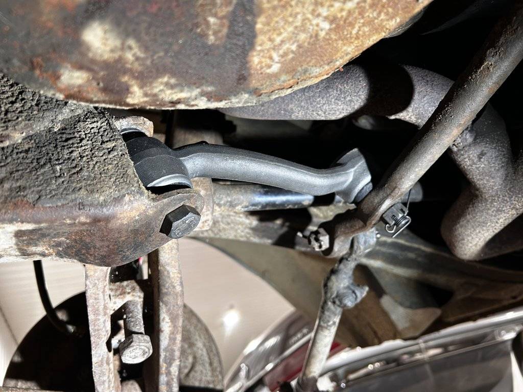

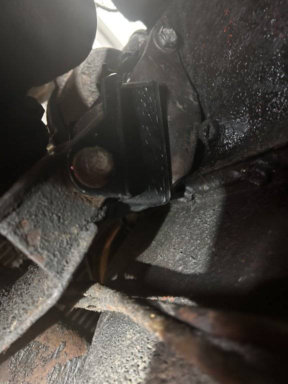

I also installed the transmission tail shaft seal, after making a driver out of PCV pipe. Worked great. I also finished up the idler arm.

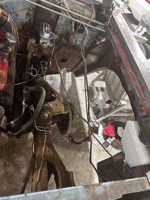

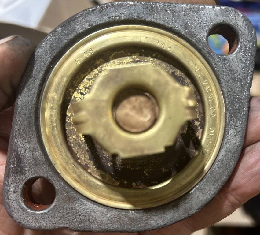

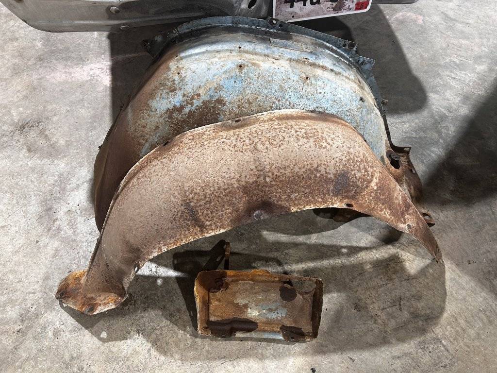

Did a lot of teardown today. Pulled the thermostat and cleaned it up, pulled the 2 inner fender liners and battery tray.
Snapped off 4 or 5 bolts of the fender liner and I’ll have to get some replacements, along with a battery tray and hold down clamp.
I also have a little patch work to do on the fender liner.
Does anyone have a source for the bolts and battery tray?

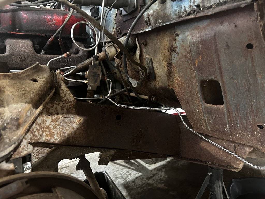

Removing the fender liners was necessary, I believe to get the brake line to the rear secured properly.
Having the fender liners out will also make getting the brakes all done on the front driver’s side easier.

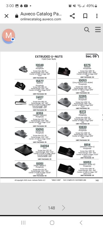

Auveco has the fender bolts and the speed nuts.
Most parts jobbers that sell to collision/ body shops carry Auveco hardware.
https://onlinecatalog.auveco.com/Auveco-Catalog/27/
I have several boxes of fender bolts leftover ftom doing the same thing you are doing.
should you have no luck getting them locally, PM me.
