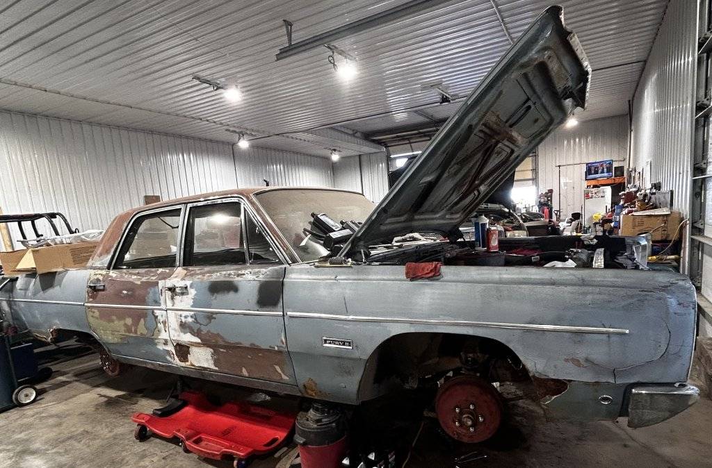

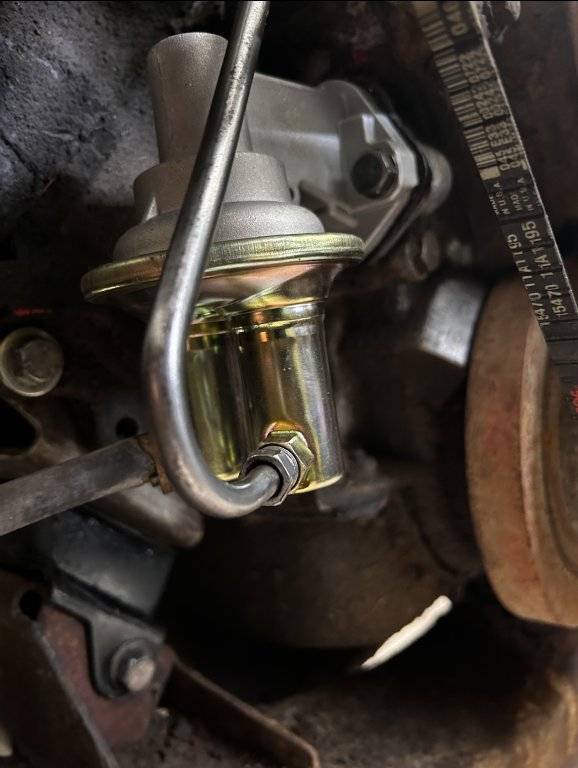

I got the fuel pump removed, I was able to get the compression fitting on the hard line loosened, cleaned up the hard line and fuel pump surface on the engine cleaned up and installed the fuel pump.
I visited an upholstery shop in Sioux Falls and discovered that to reupholster the seats on Elwood would be costly (3k+), therefore I will find a cover.

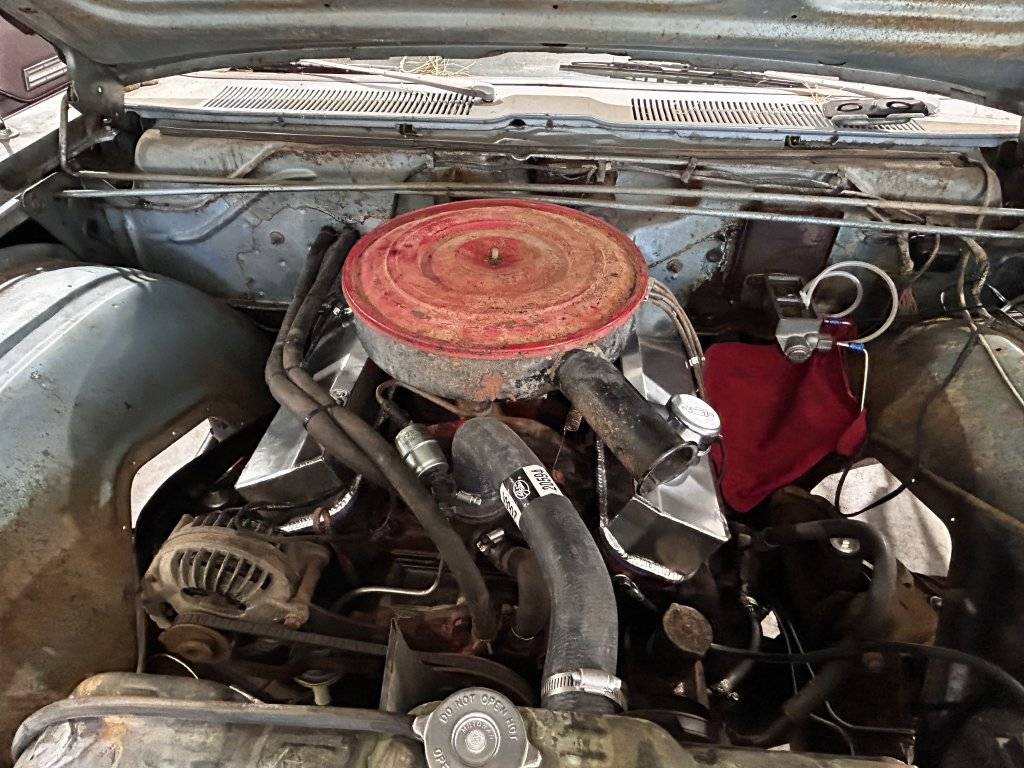

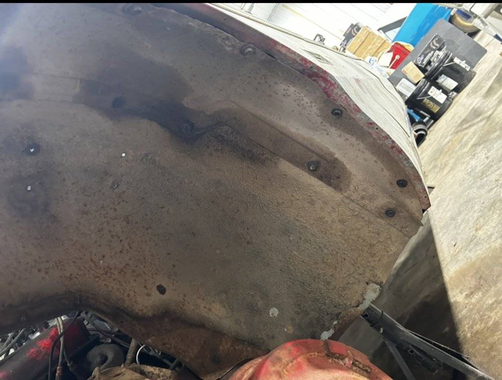

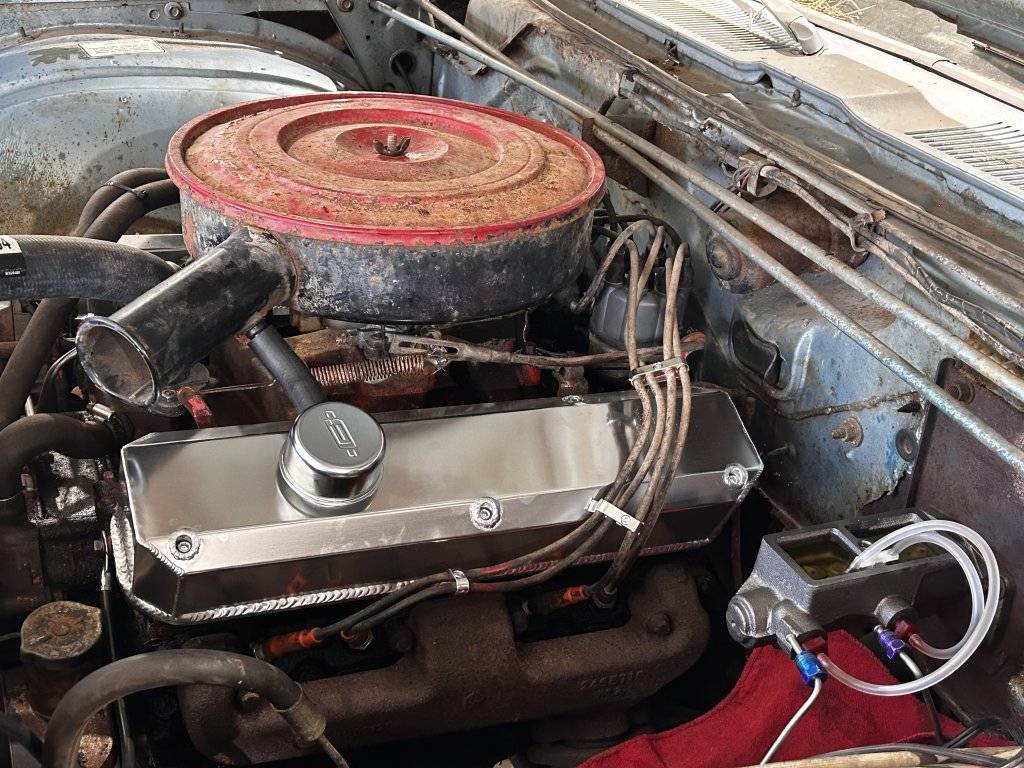

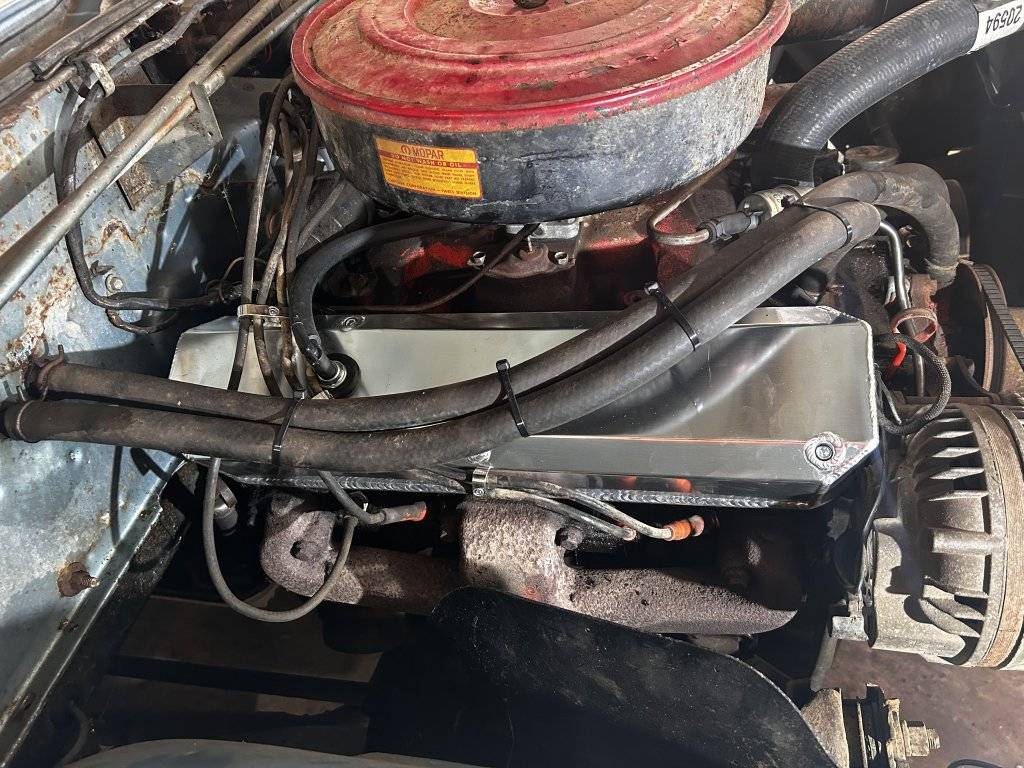

I got the outer fender liner and lower radiator hose installed. I also straightened out the air cleaner lid, as it was bent.

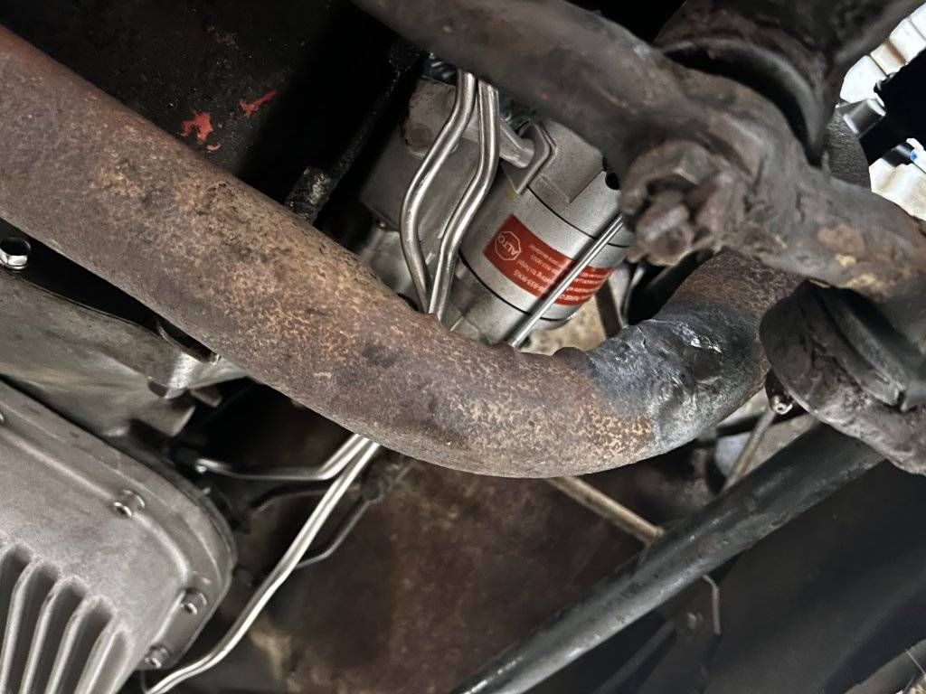

I then tried out the mini starter and new fuel pump.

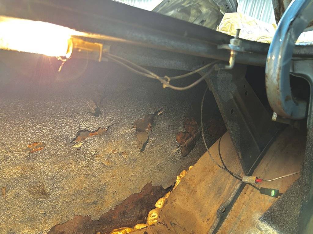

The other day, I discovered that Elwood had a trunk light.
It was missing the switch that screws into the trunk opening. I ordered a truck switch and it arrived yesterday. I simply added an insulated female 1/4” spade connector and installed the switch. Bam! Functional trunk light!

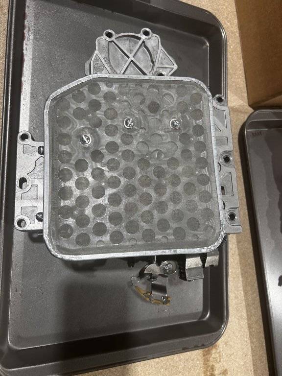

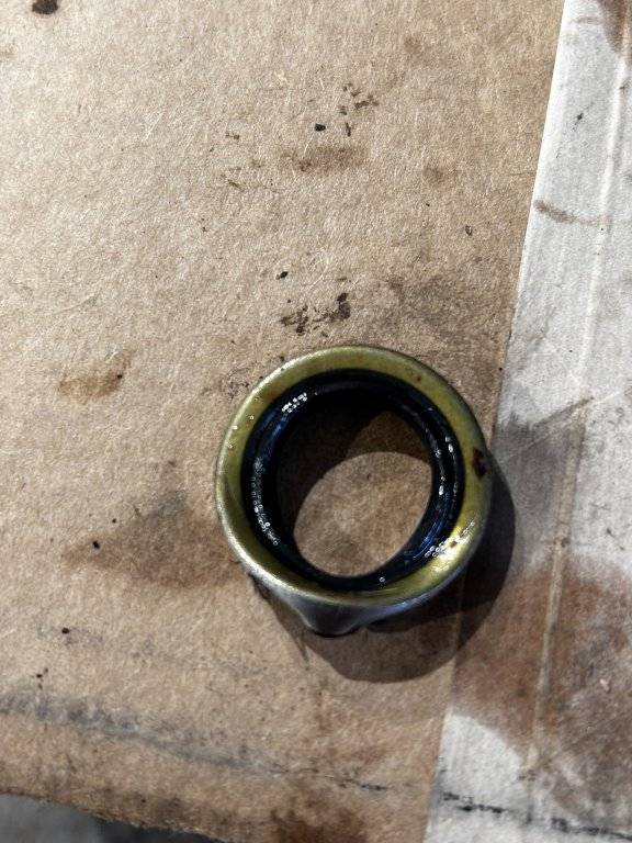

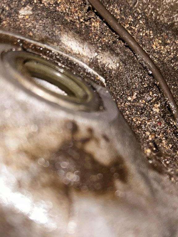

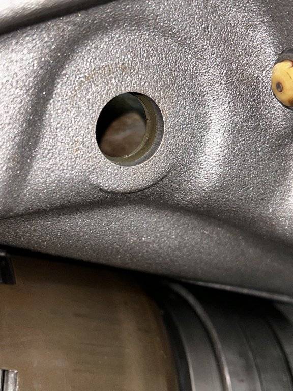

I dropped the valve body and removed the transmission seal. Both of them. Installed the new kick down seal and the shift control seal.
First one that I attempted to install was misaligned with the washers and bent it. Second one went in ok.
Next: transgo tf-2 shift kit and band adjustments.
Minimal gunk in the pan…

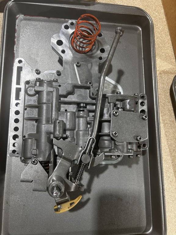

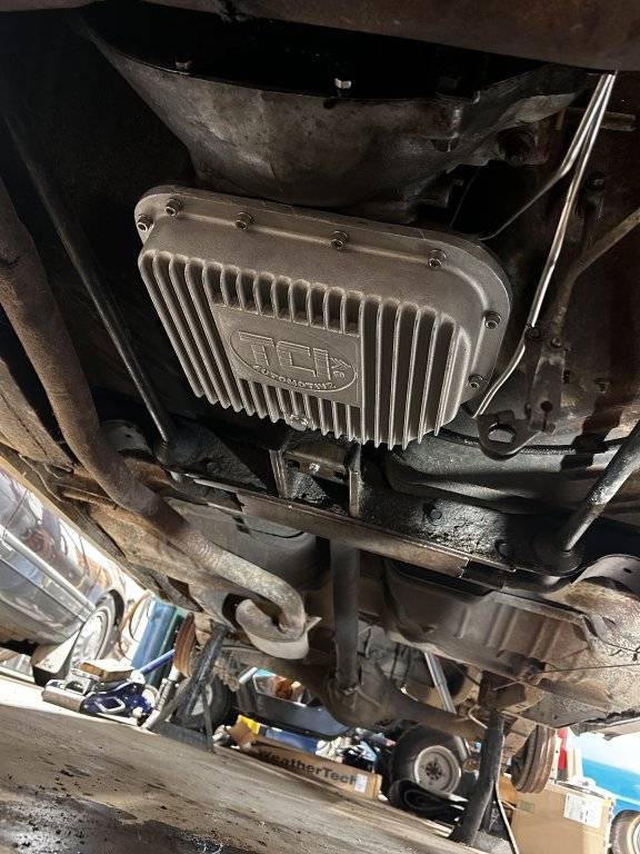

I finally got the Transgo TF-2 kit installed. Lots going on with other things. I might get it installed into the transmission tomorrow or Friday.
Instructions weren’t very good, but good enough.
I have a TCI aluminum pan to cover it up.
Ribbed, for your transmissions pleasure.

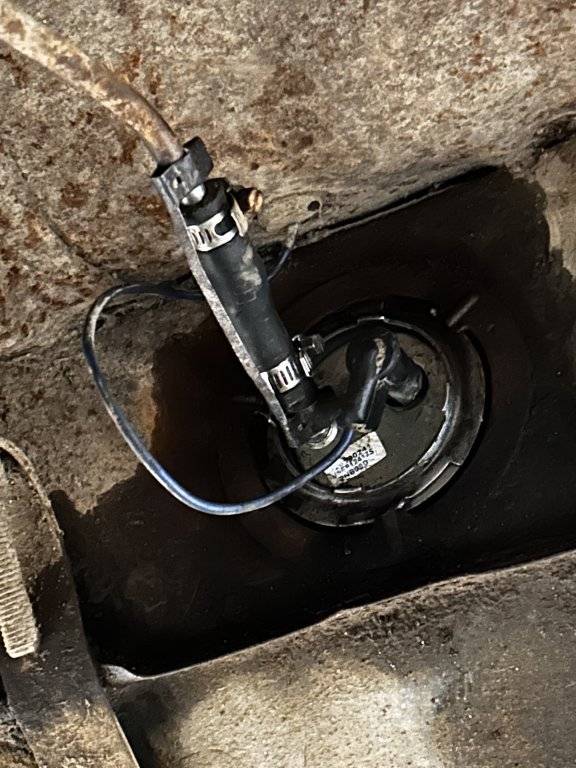

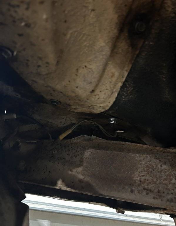

Installed fuel sending unit. Existing one works, but is missing the float. Verified resistance of both. 10.5 - 75 ohms.
Gauge now registering a fuel level!

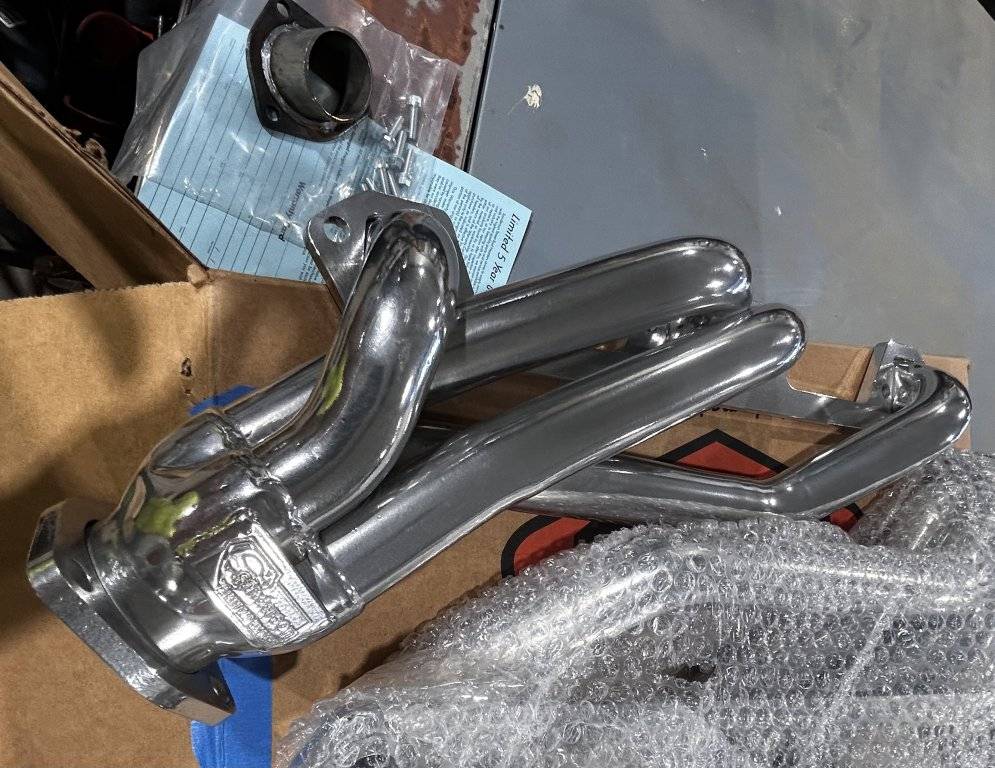

I am removing the exhaust manifolds to install these Sanderson shorties on. I am still debating whether to buy a TTI system or have a custom made system in Sioux Falls.
Road testing is days away…

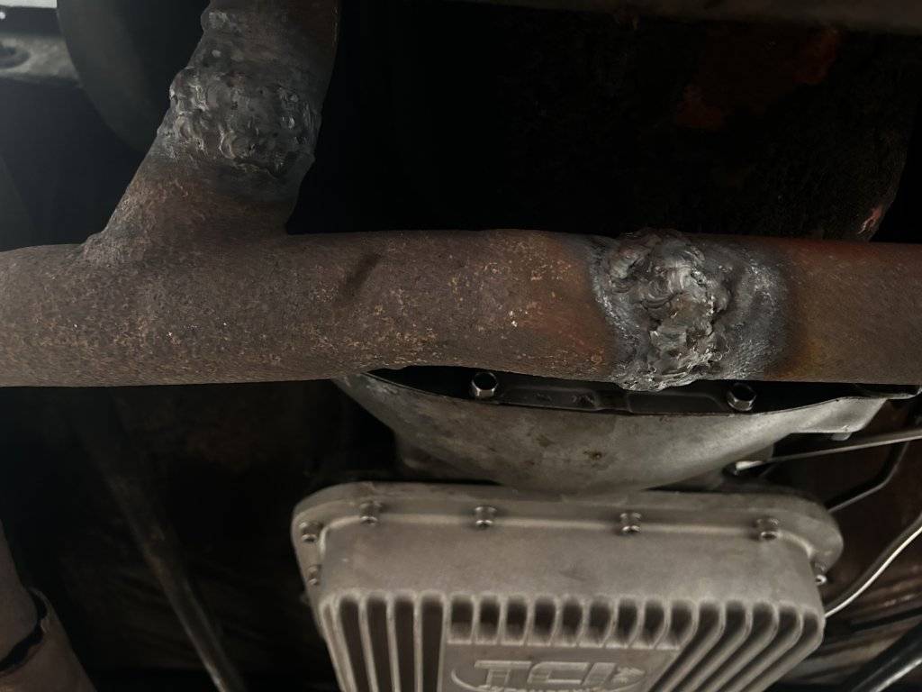

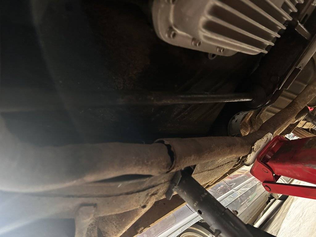

Spent yesterday cleaning up the exhaust manifolds and welded up the crossover pipe. Temporary setup until I get the car back on the road.

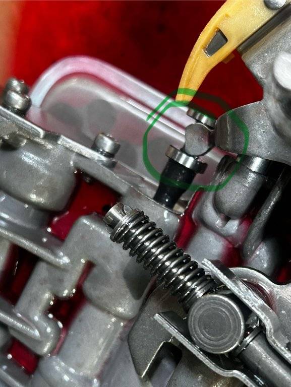

I believe that I got the valve body back together correctly after discovering that I had misplaced the shift arm in relation to a valve. That’s now correct.

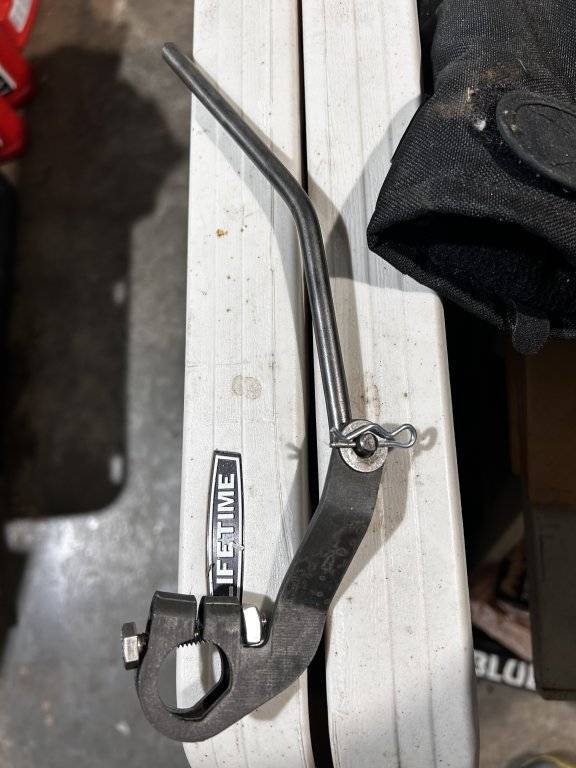

While putting the shift linkage back together, the c clip (it’s actually a double C wire type) broke.
I found a clip that I believe will work well. I also put a nylon washer under the shift arm to tighten up the interface.
