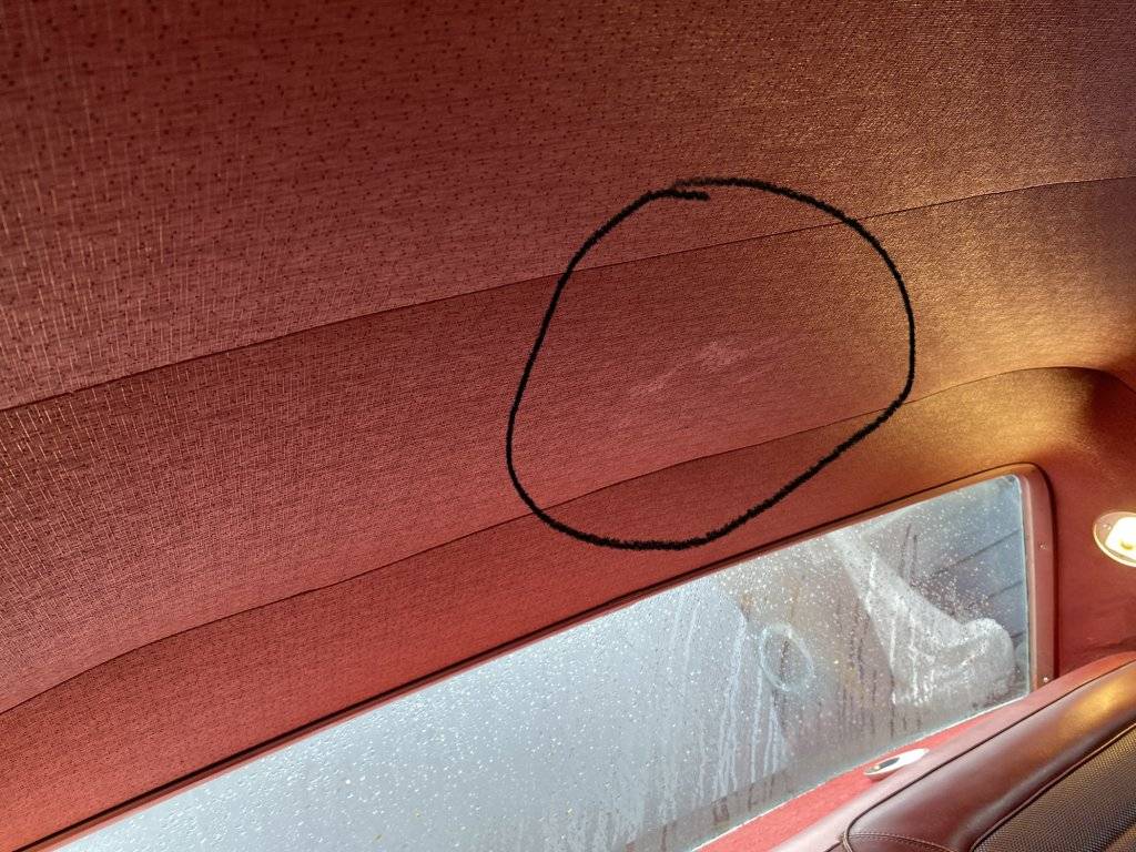

The biggest place I noticed was in the rear seat passenger compartment foot well, but I also noticed some water on the headliner. Don’t know if it’s condensing on the headliner, or if it’s actually dripping from the roof down onto the headliner from the inside. I’m hopeful some sage elders from this forum have seen this before, or know where all the common points of failure are for the sealing of the glass and cabin.

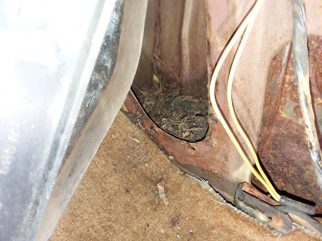

In my experience, the water at the rear floor pan is often from a clogged cowl drainage area, causing water to leak past the kick panel, back along the front floor pan and then down into the rear floor pan. If you haven't already, I'd remove both kick panels and vent doors, clean out the cowl drainage area directly behind it, pull back the carpet, and inspect for water tracks.

The pattern on the headliner looks like something other than water to me. NO issues with condensation should happen. DO NOT attempt to scrub it!!! If it will not brush off, let it be. Otherwise, you'll be asking for a source of a new headliner. As good as the bodies might seem, they are certainly not air-tight by any means. Any possible condensate would be absorbed by the jute sections of roof insulation, I suspect. IF that pattern was near the top of the windshield (front or back), THEN it might be a glass gasket issue.
1972 Fury, what you may find behind the vent door
Well, I finally got around to pulling the cowl vent covers and inspecting. The driver's side was almost completely clear of debris. The passenger side was bad, but not as bad as the photo here. Probably half that amount. The drain holes did seem to be clear however, and I wasn't getting water into the passenger side because the water is draining into the engine compartment, as there is some rust through damage and the water leaks out before it gets down to this vent area.
