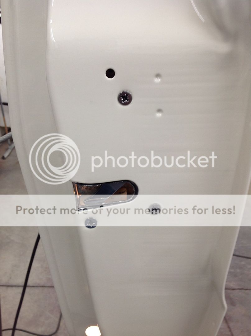

Derek, can you tell us what brand of paint Paul uses for the primers, basecoats and clearcoats? Would be interesting to see how his choices compare to what I have heard from other painters. Also what brand of filler? And any comments on why his choices, would be interesting too. So we all can benefit from his experience too! Nice work indeed!
will ask him next time lm talking to him but hes saying theres very little if any filler in the panels so far...even the drivers fender he repaired is mostly hammer and dolly work.
Belive he throws down 3-4 good coats of epoxy primer and works it till smooth then guide coats it then he adds a special type coat to highlight any lows or highs as a last step before hes ready to paint...
Honestly l don't explain his process as well as it should be...belive Bill nailed it and explained the process much better than l can in his build thread so will just point you to that for now...
