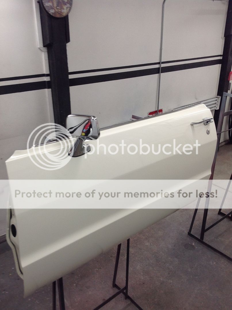

Paul used PPG Omni on my car. For the little bits and pieces he used Krylon rattle cans in a selection of silver, aluminum, a bunch of different blacks and clear. Some were satan, some were gloss. Paul has a wall cabinet with a selection, about 40 or 50 cans. I looked through my invoices and did not find any filler like bondo, which is good since I hate bondo.
The paint looks great even without the cut and buff. You can tell a great painter by what it looks like before the cut and buff. Some guys have to cut and buff to make it look ok and some can lay it out like glass. I would put Paul in the lay it out like glass category.

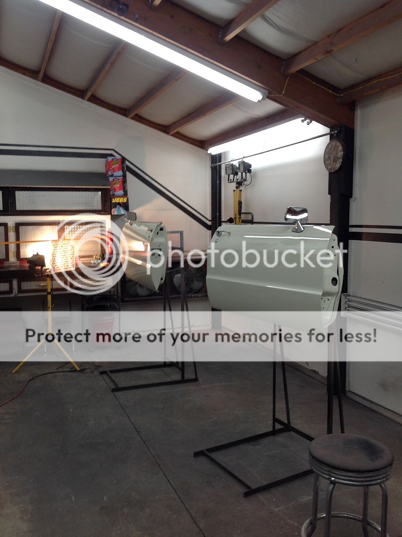

When he painted my body shell, Paul wrote note to my wife and I which he stuck on the shop wall and then photographed the fender. Unfortunately, being a reflection, it was inverted. So he peeled it off the wall and turned it over so that the words could bed seen from behind. He had written it with a Sharpie on masking tissue. Anyway, the paint was still drying when he took this picture. "Laid out like glass" pretty well covers it.

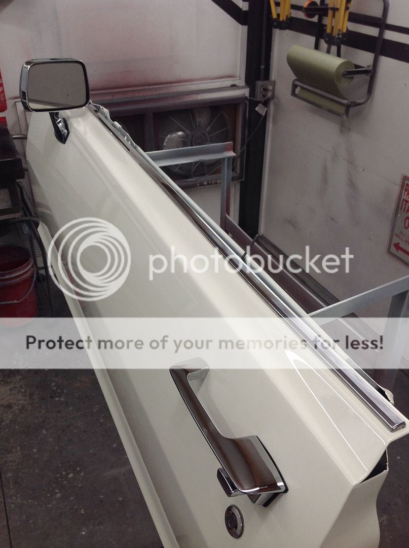

some more of Pauls fine glasswork for you folks...
Paul had to backlight this because of the white....
