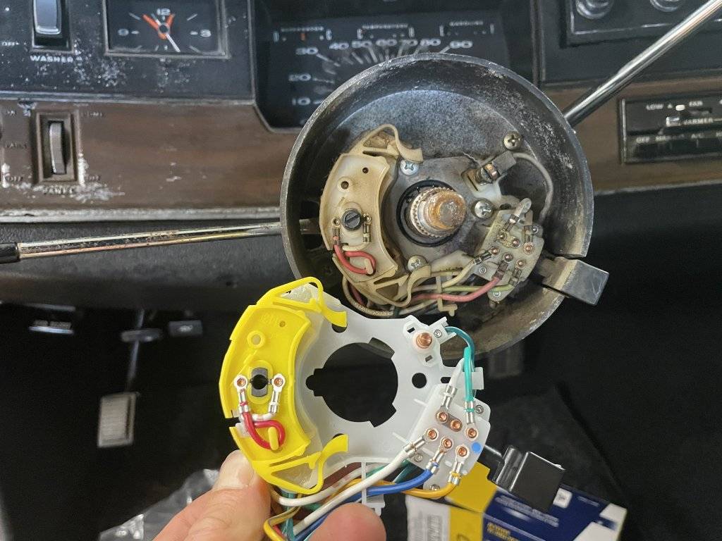

Today I finally found the time to swap the turn signal switch. Everything was easy to disassemble. The old switch was quickly exchanged for the new one. Unfortunately, the whole thing didn't change my problem. So now I'm going to ask a friend for help and test everything once.

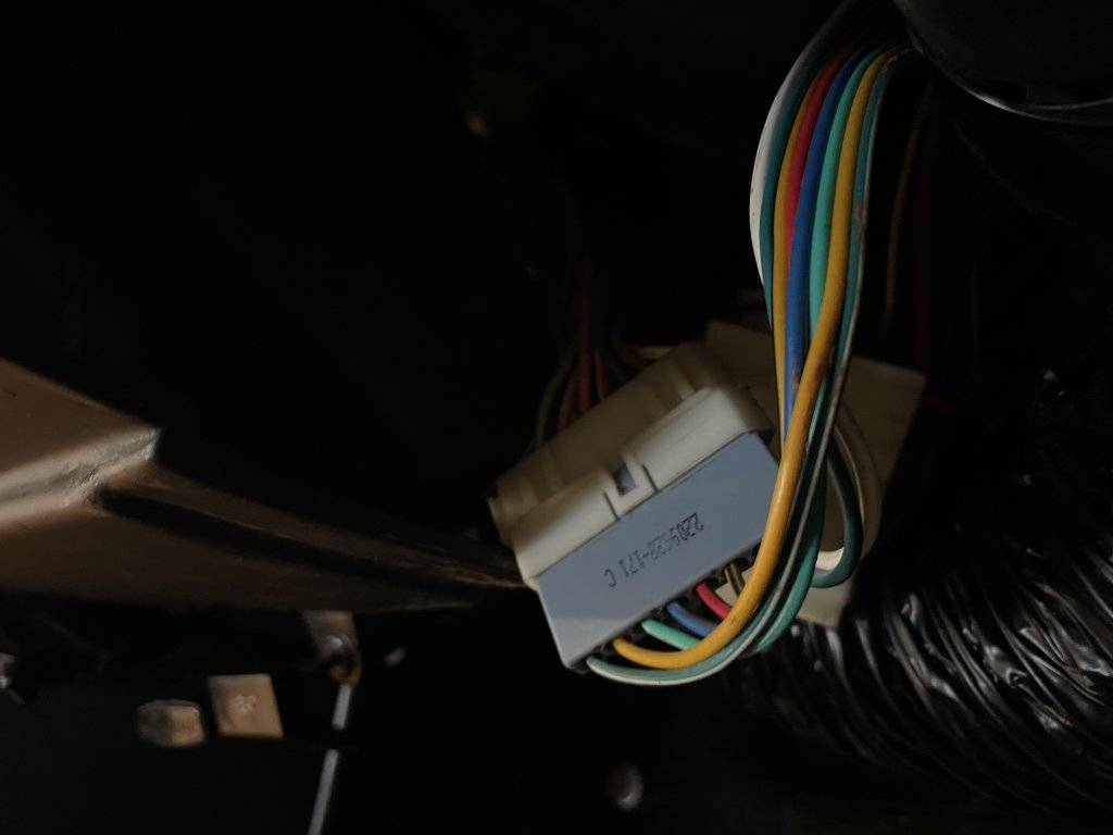

I took the fury apart again. The cables all look fine. Contacts are a few oxidized. I cleaned them up and put contact spray on them.
Oil display - without function (no cable on the oil pressure sensor)
Brake - never worked
Turn signal left - is always on
Right turn signal - comes on when key is in second position (ignition on)
Interior lights kept flickering. I took out the lights.
Turn signals are cobbled together. There are no driving lights, only turn signals.
