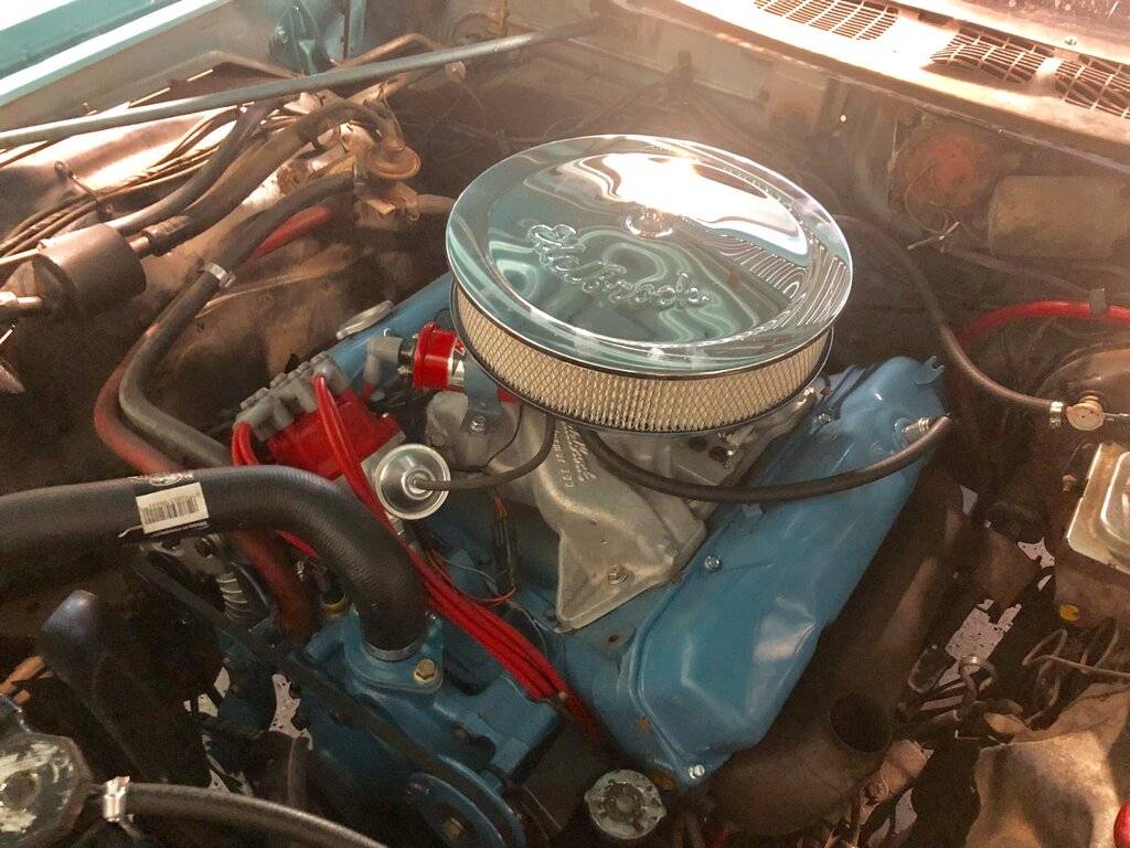

“Jackie Blue” will get a fresh engine rebuild!

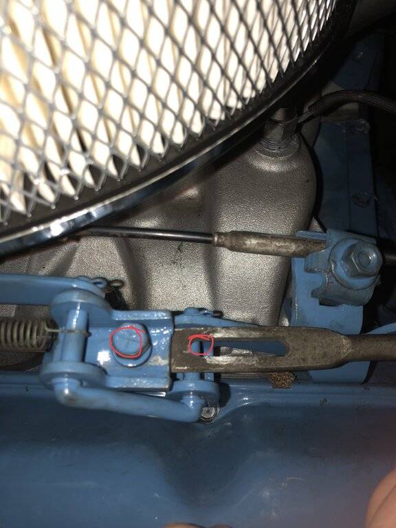

Hmm, wonder if this is the edelbrock bracket somebody mentioned. Think this could work! Anyone try this? My lockdown rod is in line with the linkages it’s just shorter now, so maybe this is a solution?

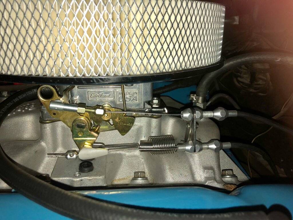

Ok finally got to the bottom of my throttle/kickdown linkage problems, after wasting lots of time trying to figure out the new linkage geometry like playing with a rubix cube I decided to remove everything and toss it in the bin. Installed a lokar cable kit, problem solved!

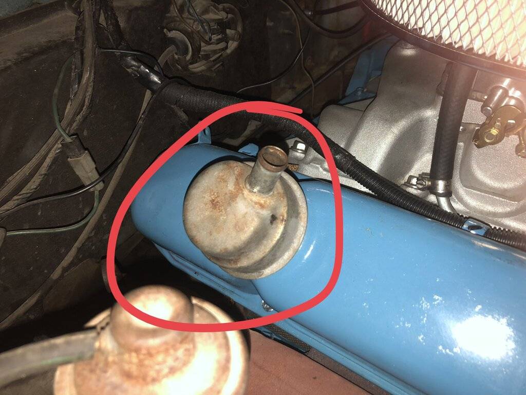

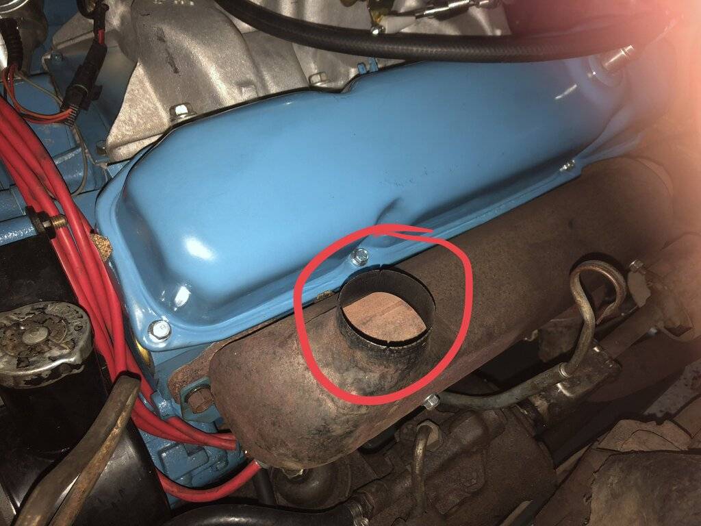

What should I do with these? Any recommendations on what I should put here? I know the one side is a oil breather, but what size? And what to do with the exhaust manifold hole? Can it stay open? Or is there a cap? Thanks!
